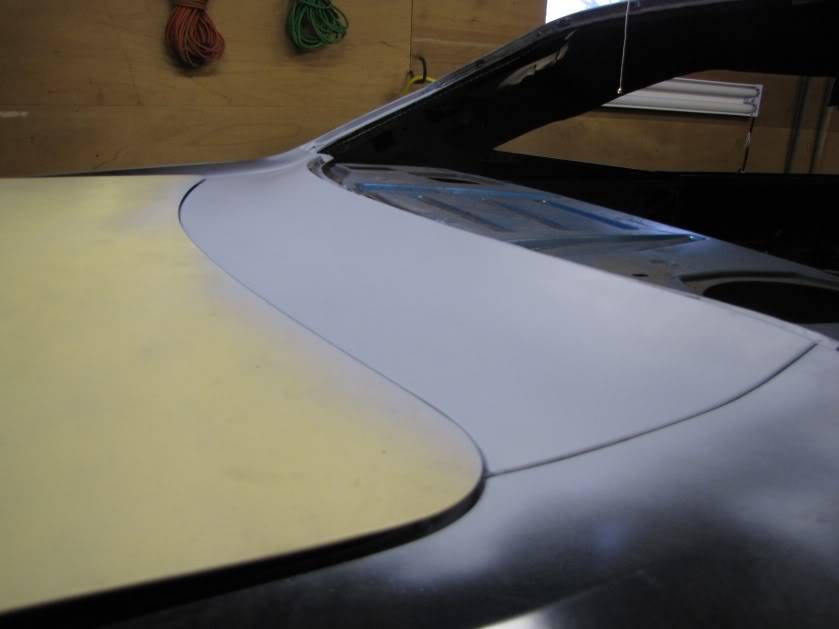

So......Deck filler panel. Probably wondering why I wasted my time to write about and post a pic on it. Well, after spending an hour wire wheeling off all the 4 layers of paint, I made it down to bare metal on the whole panel and then acid primed thereafter.
This truely is a momentous feat. I don't think I have reached a section on this whole car thus far where as soon as I start excavating I didn't hit rust, holes, bondo, lead, brass, Jimmy hoffa, grease or a mouse hotel. I'm stunned.
This post is dedicated to the only decent original piece of metal on the car..
If you remember mine was actually scraps of metal roof flashing pop riveted in place. Here is to Skeletor's deck filler panel, HIP HIP HOORAY!!!

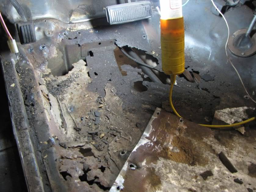

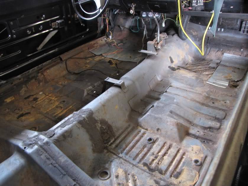

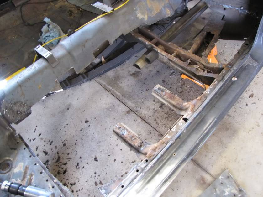

Got some time today to start on the floor pans......
Needless to say they're a little junk after 40 some year of wear and tear

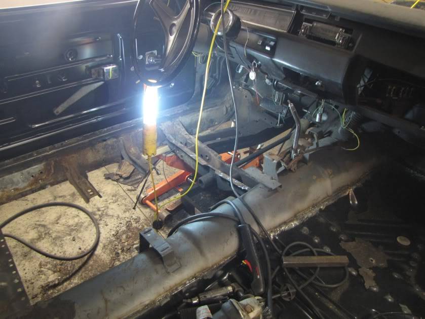

After drilling out spot welds for a short stint, moved on to the plasma cutter to zip out the rest. Obviously I have a bunch of clean up to do as well as patch the torsion bar crossmember.

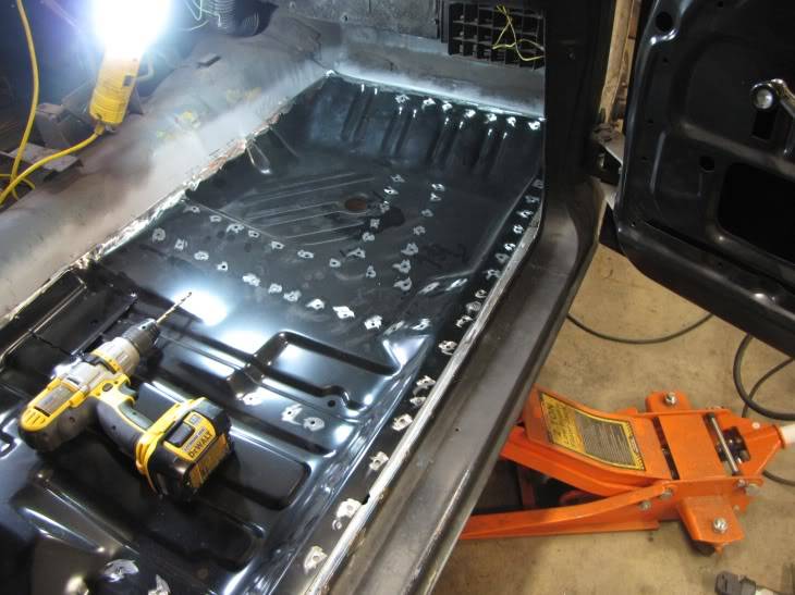

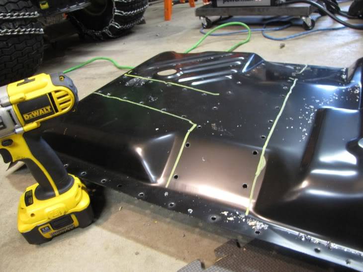

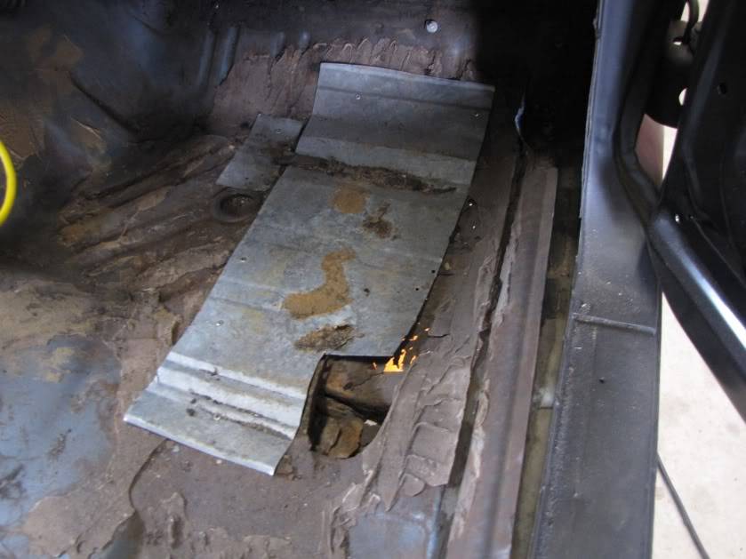

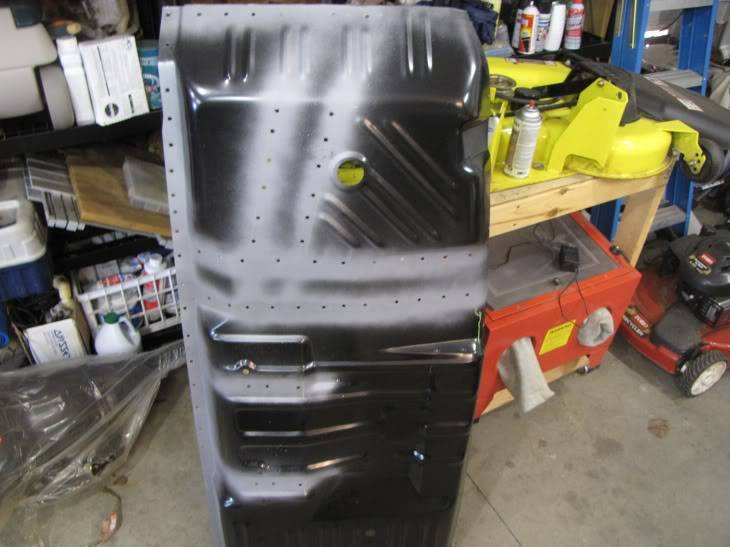

Got the new pan screwed in place. Fit real good with no modifications needed. Drew on my lines as well as outlined the bottom side around the frame and braces.
I will be using my air flanger along the tunnel. The flange punch has a 1/2" offset, so I measured a line 3/8" down and all the way across from the outline when the pan was in.
That will leave me an extra 1/8" to lay the weld puddle in and have it come out level.

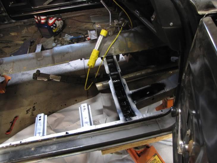

I also cut out some 16 gauge steel out of a template I traced out in that torsion bar crossmember to inner rocker transition and welded in.

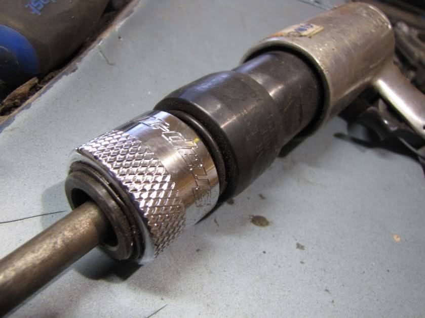

Picked up this Snap On Q.D. this week for my air hammer/Chisel this week... Makes the old route of a spring seem like a joke. Works Great!! I''ll never go back to the old bed spring special. Highly Recommend it!!

That air hammer coupler looks pretty sweet, might have to look for one of those.
Do you use it mostly for splitting spot welds from structural pieces? That's mostly what I use mine for, removing stuff you can't save.

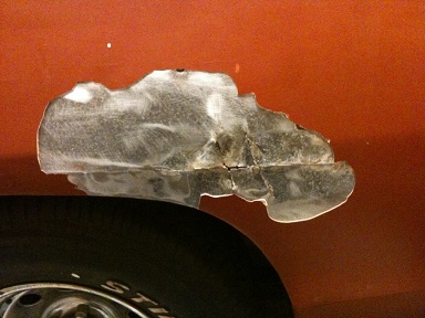

Look, we have sheetmetal from the same can ;-), found this behind a wall of bondo! Seems like there is a lot of "craftsman" out there...
No Doubt Swede..Kind of sick of being on the bad end of a "good idea" going sour.. Looks like you got your work cut out for you

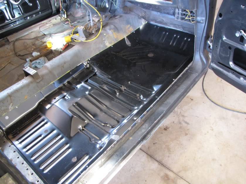

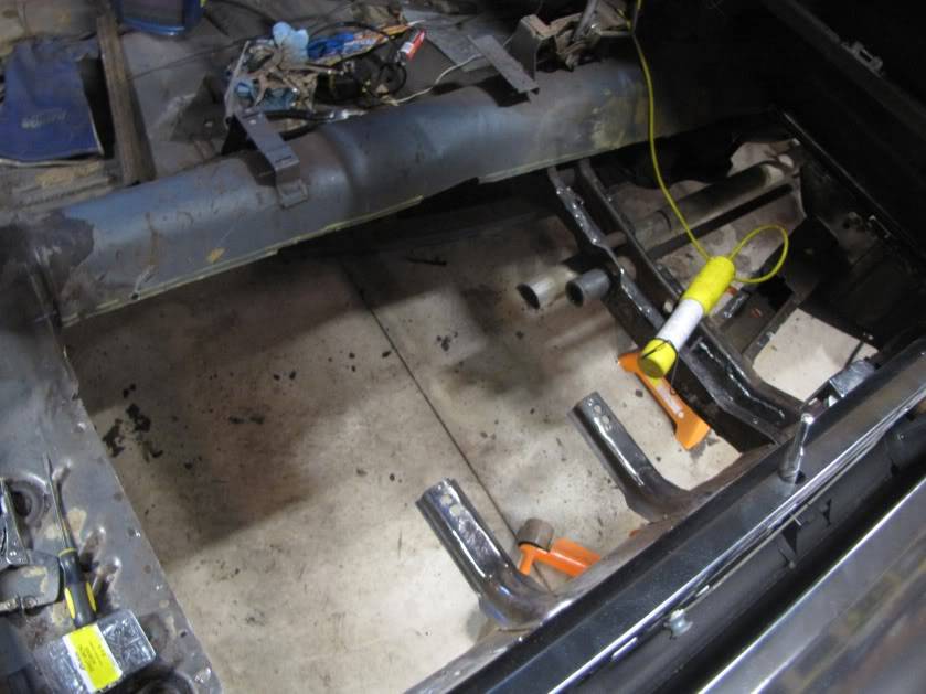

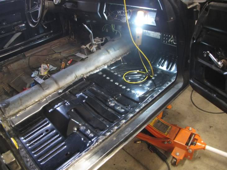

Wrapped up the rough metal work on the passenger pan today.......
Pretty much templated/marked up the bottom side by tacing the edges of the frame and braces, just like I did the trunk pan earlier in the resto
Lotza wire wheeling, grinding and then a coat of rust bullet, then 3M undercoating in the rails, then weld thru zinc primer on the mating surfaces..
Pan fitted and preped for welding...
Welding complete
