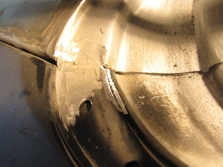

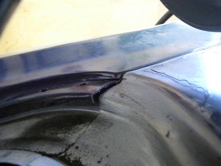

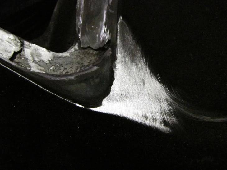

Got a little bit of a chance to putz around with the car tonight.. Worked on that AMD factory crack by the window corner..
Layed a weld bead and leveled flat with 35 Grit on the die grinder, working from the top flat surface of the quarter.

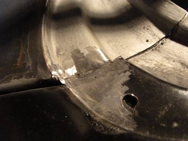

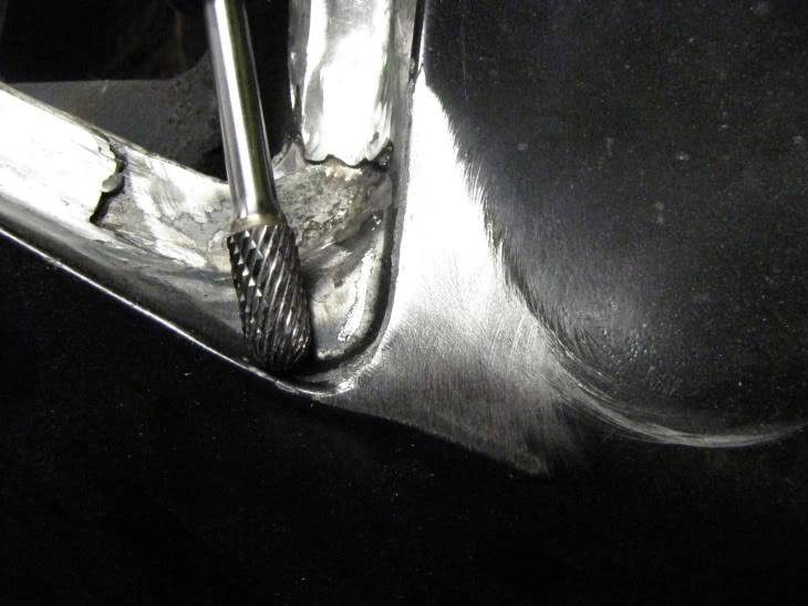

Took a carbide bit to the back side to shape a bit..
Rounded the edge with a 80 Grit mini disc, fine tuned with a scotch disc and then coated with acid etch primer

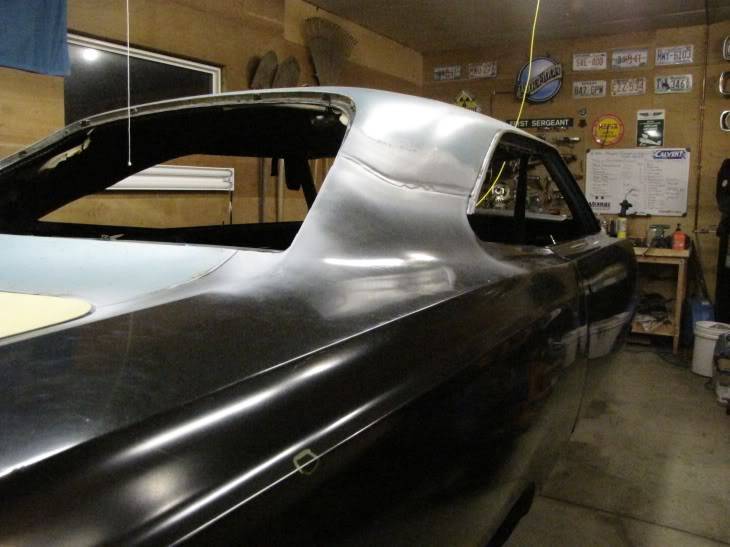

Area turned out pretty good..Also finshed off the roof to quarter transition and also were I had to cut down the Quarter where it drops down into the window frame on the C-pillar. (1/4 inch too tall initially-had to cut down and reweld)..
Besides the little quarter gutter work on the drivers side, Both quarters are 100% welded in place. Will be wrapping that up tomorrow as well as welding down the fill panel braces and trunk latch support.

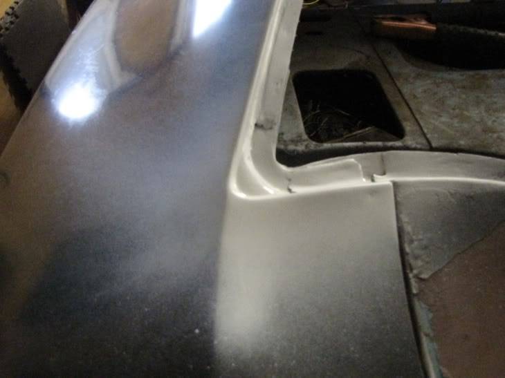

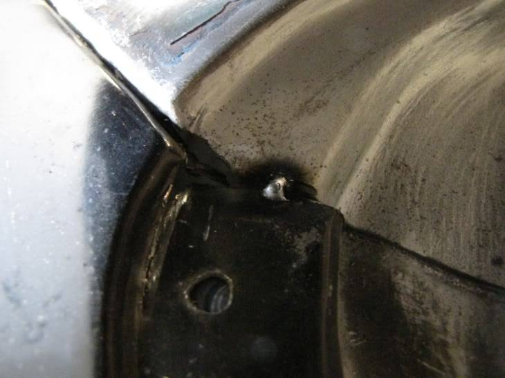

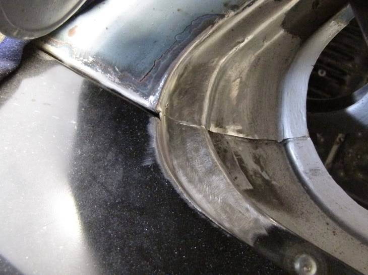

Wraped up the last little bit on the drivers side quarter. Took care of the factory AMD flaw on that area where she dips down in the trunk gutter..
I know most guys that stop by and take a peak at this thread and the guys that regularly come and visit know how to repair a problem like this, but I figured I'd toss on the repair for those who haven't run into this problem before. This is just they way I go about relief cutting to fit. Obviously different folks, different strokes, but this is what works for me.
The issue is where the quarter steps down into the gutter. Up at the curve it does not step far down enough to mate up with the trunk gutter rail and is also too wide.
Made a relief cut in the first drop........
After the cut was made, used a long arm body/vise clamp to mate the quarter drop to the trunk gutter properly, then tac welded......
Welded in the relief cut as well as where the quarter meets up with the deck filler panel in the gutter panel....As you can see the AMD quarter drop is too wide for this area as well
Made another relief cut in this area as well....

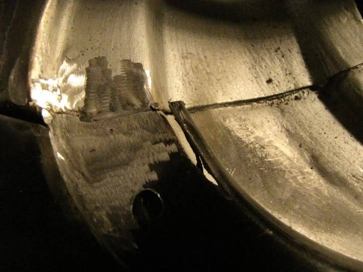

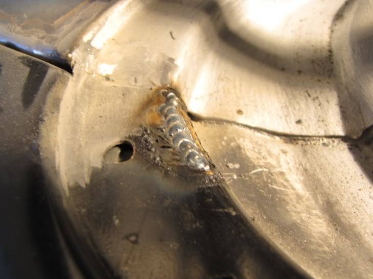

Used a body hammer/dolly to bend in/shape and then lightly shaped a bit more with a 35 grit mini disc on a die grinder....
Weld over relief cut area....

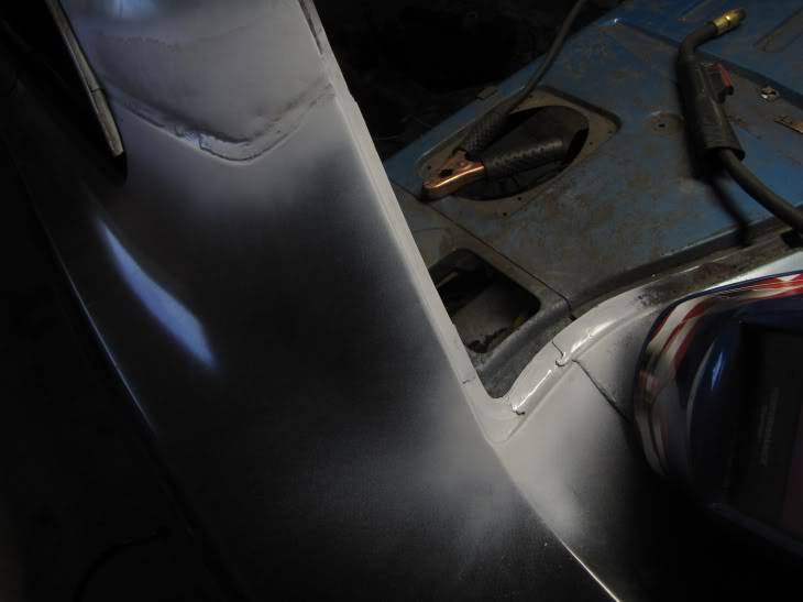

After some grinding down then sanding with 35grit and moving on to 80, this area is rough finished for now... I'll eventually finish off with some 180-220 and possibly 320 thereafter.

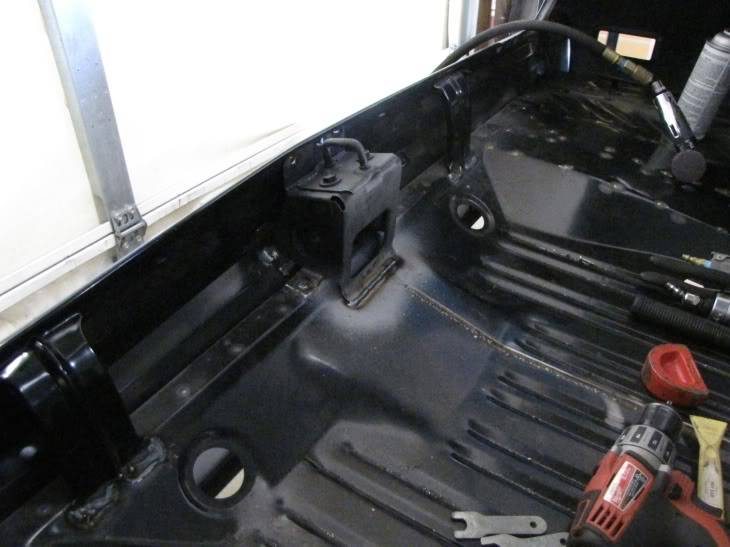

Also finished welding up the fill panel supports as well the trunk deck lid latch support as planned.***Note to self...... Have someone give you a hand next time lining up a latch support. Crawling in and out between the braces in back of rear seat area gets pretty old after the first several times** Another 20 years or 20 pounds, that wouldn't be happening anymore. More work planned tomorrow!!

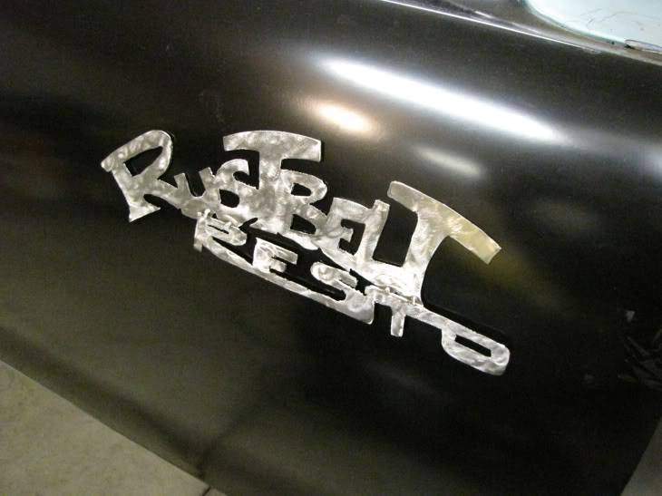

Playin around with the plasma cutter tonight.Decided to make my own emblems for the roadrunner...LOL Just kiddin around
Yeah I know, get to work! right? Got it buried in the snow bank curing. Wouldn't be right if it wasn't rusty.

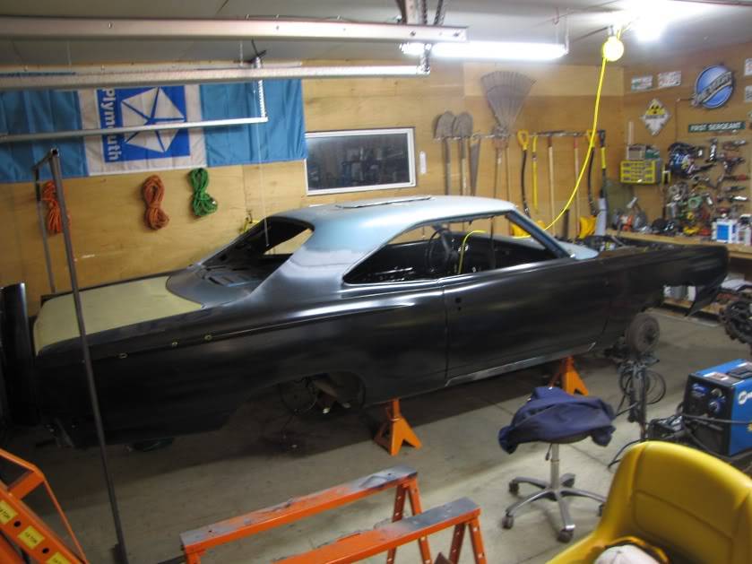

Tossed on the fenders just to see how everything is going to line up toward the front.......Holy crap there's a 69' Roadrunner in my garage again!
