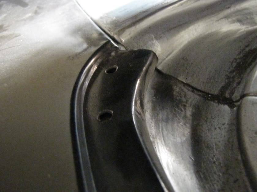

Few issues I figured I better point out to you guys on these AMD quarters. Besides the identified issues that were addressed before fit up, these showed their ugly faces while installing and where apparent on both quarters..

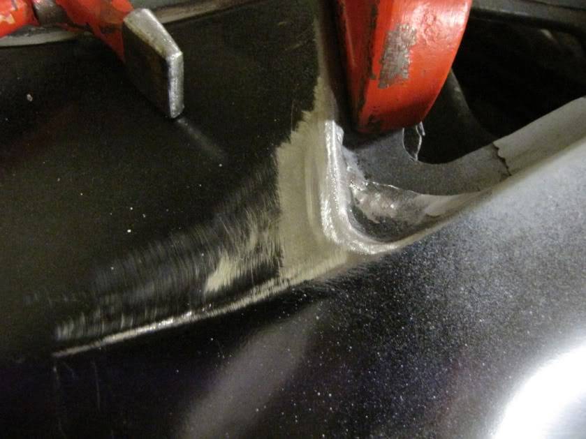

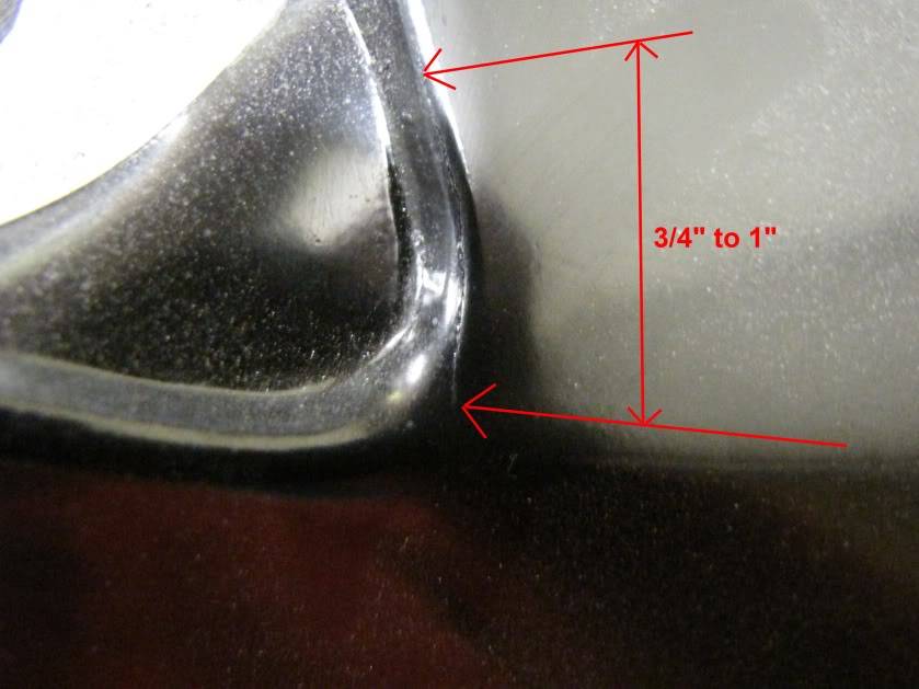

1- Quarter rear lower corner, rear window channel. After installing I noticed about an 3/4" to 1" crack open up on the lower side of the window channel area.
Fix- Lightly excavate for better penetration of weld pass. +10-15% in amps vs. standard 20 gauge welding. 10-15% drop in wire spreed. Grind down and finish

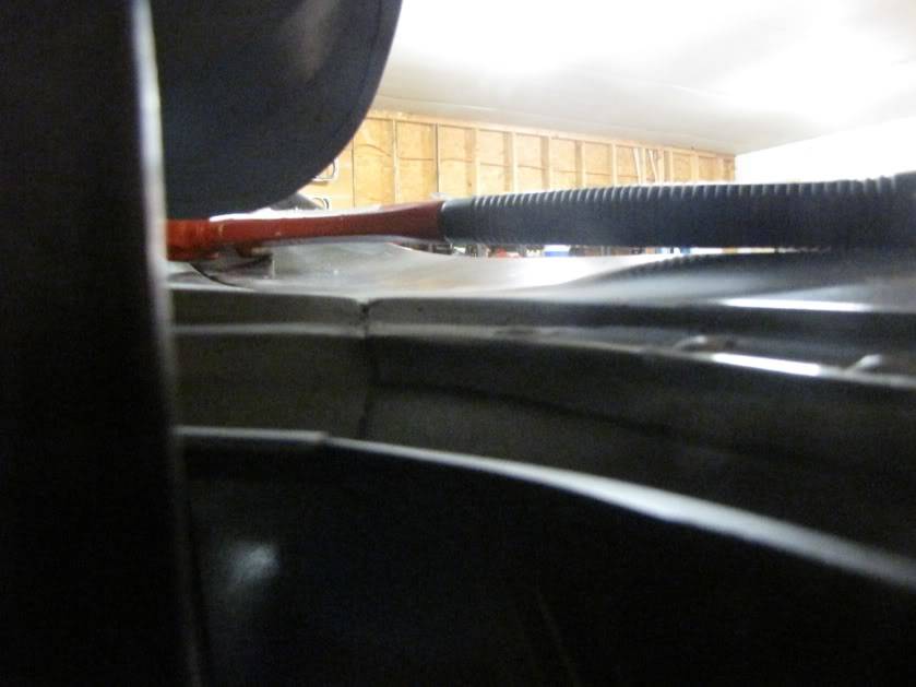

2- Quarter drop into gutter rail (near deck filler mate up). The lip that drops down on the quarter into the gutter is not tall enough. Make a 2" long relief cut at the 1st right angle drop. Gently tap top gutter till a firm mate is made between quarter and trunk rail gutter. Weld in relief area. Grind down and finish.

Wow, cracks in new panels.... not good on a body that likes to twist when a man stands on the skinny peddle.
Glad you saw those cracks and fixed them before paint.
Thanks for the heads up.
Hey no problem fella's..I figured with all you guys building a 68-70 Plymouth B-Body like myself, hopefully you can catch it early if you have the same unfortunate problem. Like Dave said, "glad you caught it before paint." Imagine if you didn't? :frustrated:

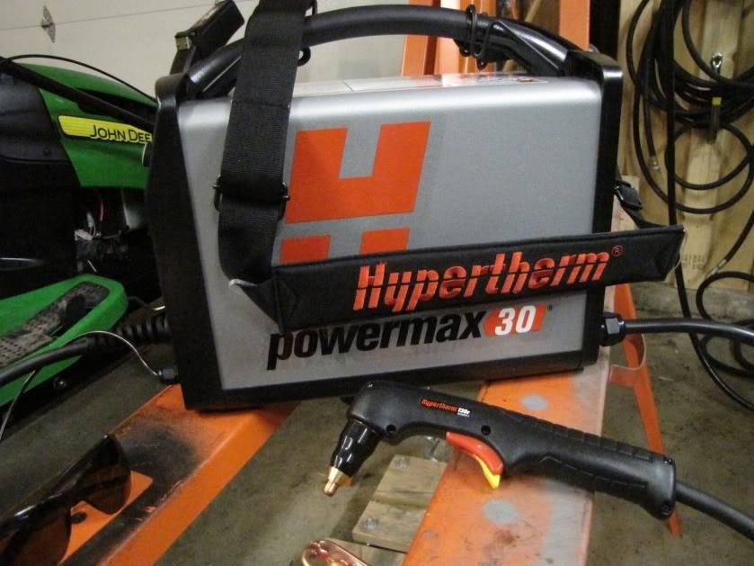

New toy Gent's!

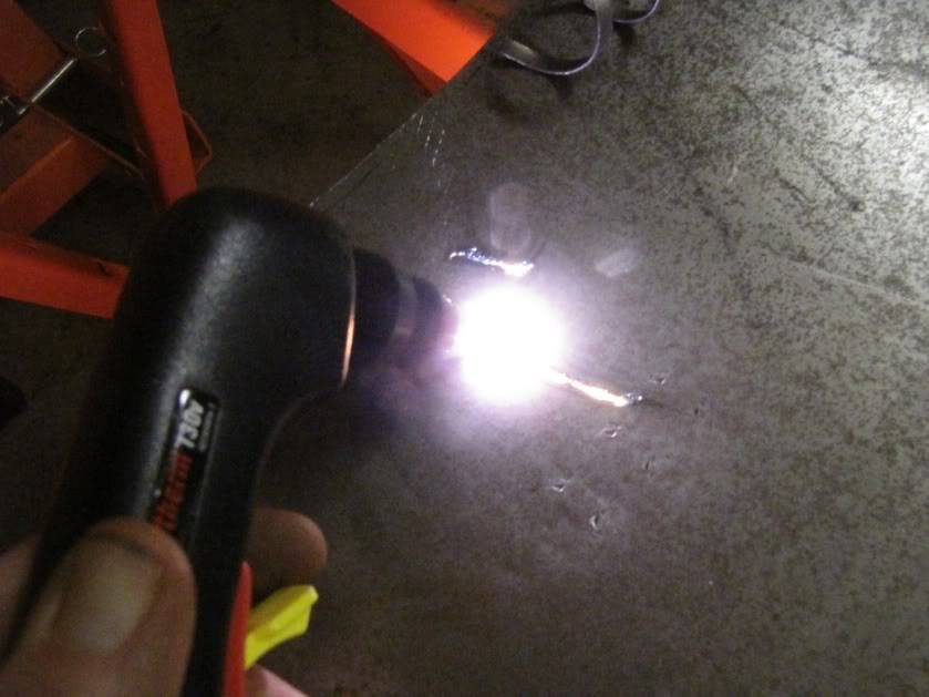

Bought this Hypertherm Plasma cutter.. This thing is Awesome!!! Carnage!!! Cuts through metal like butter. There's going to be holes all over my house and garage by the time I wear out the honeymoon period on this puppy.
