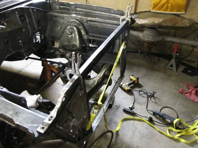

Decided to tackle that bent up upper radiator core support this weekend.
Hard to tell by the pic, but she was bent out pretty bad in 2 spots, twisted and the upper and lower lips being mangled up pretty bad. Had a chance to pick up a new one pretty cheap, but I wanted to keep the original seeing the matching VIN is stamped on it. So...off to the torch, then body hammer, then vise, then panel bending grips, back to the body hammer, heat....1 1/2" bar stock..vise....you get the picture.
Metal was pretty good under core support
Got the repaired part back in place...Was pretty happy how straight it came back out. I noticed when going to reinstall, the side supports moved apart apart a 1/4" after drilled the upper core support out. Nothing a come-a-long couldn't fix..

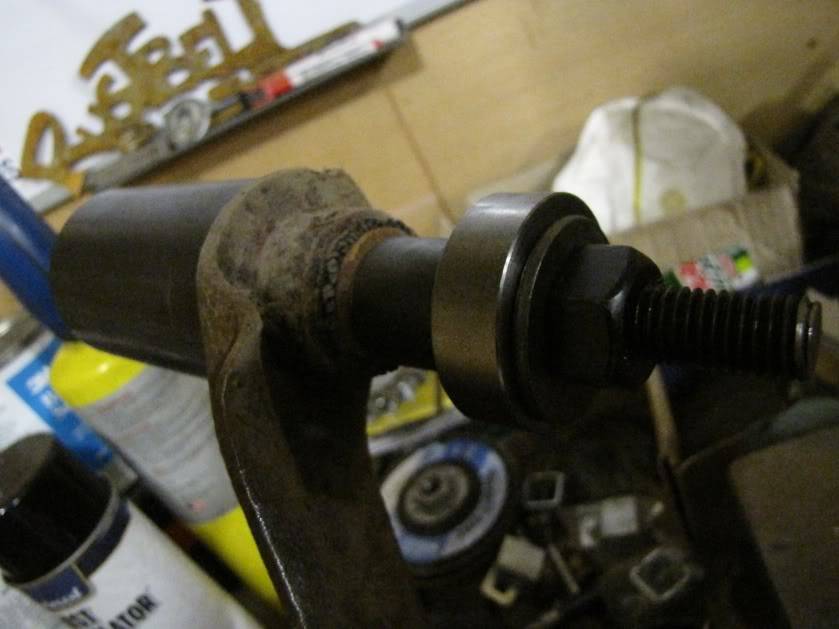

Pulled out the upper ball joints and upper control arms... After shopping around and not wanting to pay $30-40 per to replace each upper control arm bushing, I bought this upper control arm bushing removal/install tool from American Muscle...It did the trick put still required quite a bit of penetrating oil/hammering/heat to get them out

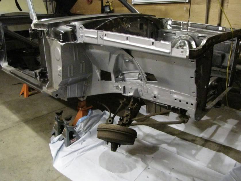

Since both inner fenders were now down to bare metal on both the inside and out, I coated both with a couple thick coats of rust bullet on the fender side..

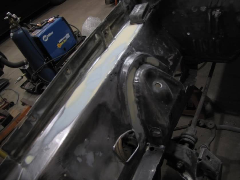

Well...Finally since most of the metal work is wrapped up, time to start on the body work.
Got the engine bay rough finished with some Evercoat Extreme Rage and then a thin coat of Glaze..

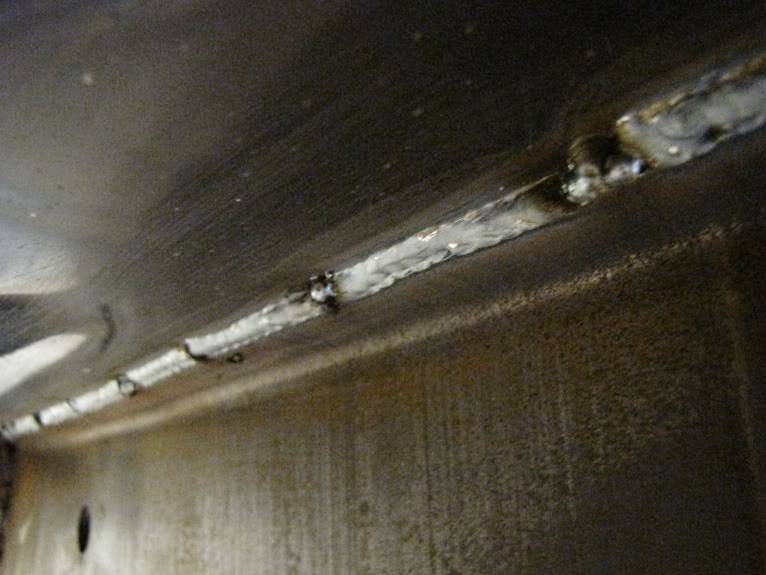

I ended up seam welding pretty much all of the trunk pan to frame rail/shackle mount seat's..Wanted to add the extra rigidness back there......
