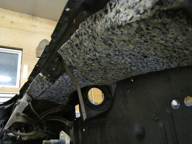

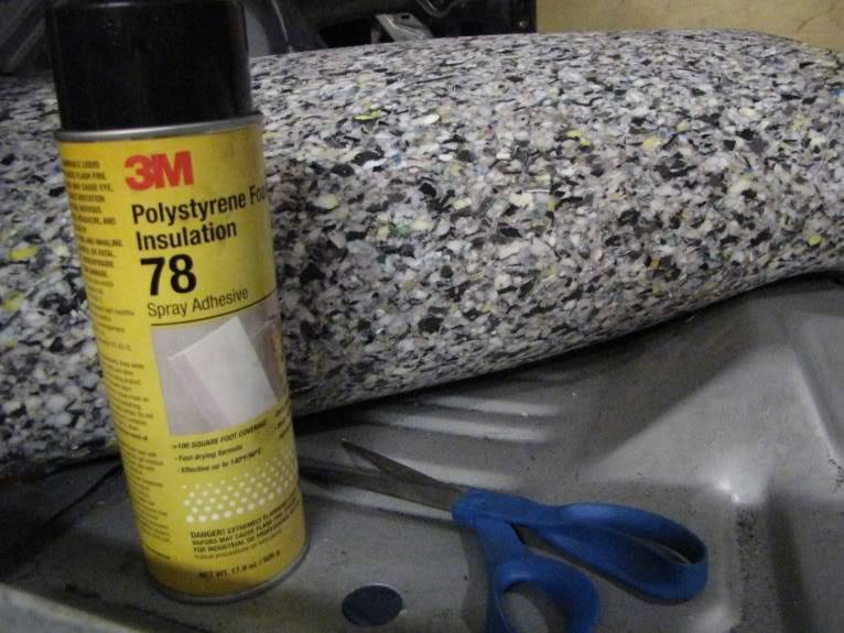

Decided to remove most of the old ratty upper firewall/cowl bank insulation and replace it with fire resistant low decibel foam pad underlay for carpeting. Cut to fit, toss on some 3M spray adhesive and away we go.....Total cost from Home Depot $9.45

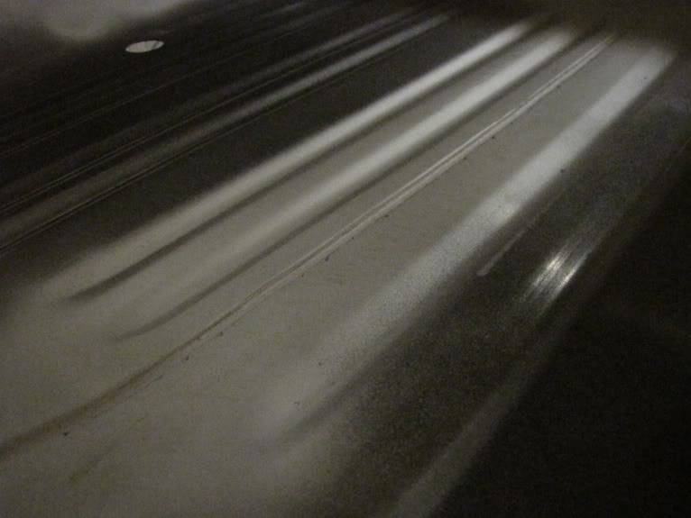

So what does the seam on 2 pc pans look like.......Here it is. This is fully welded and ground. Not as horrific as some claim. A guy could even toss a weld to fill the middle and ground flush, toss on a glaze and waaallaaa, never new it was there. Myself, I'll run a bead of seam sealer in it and coat over. I honestly have bigger fish to fry and really don't feel like wasting my time making my trunk pan look like a princess......

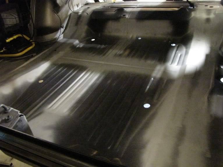

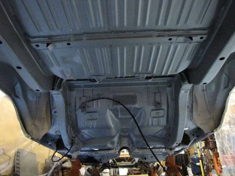

Got the trunk area Seam sealed and coated in rust bullet..
the underside was seam sealed and coated as well

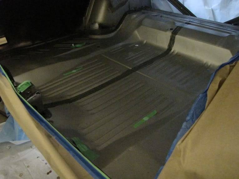

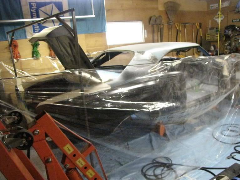

Had to toss up some make shift walls. Didn't feel like decorating the garage with Bedliner

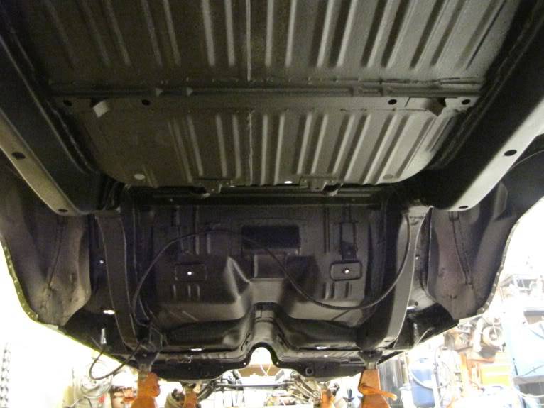

Applied the SEM Bedliner to the entire underside of the car

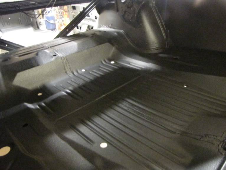

Also sprayed the entire trunk area

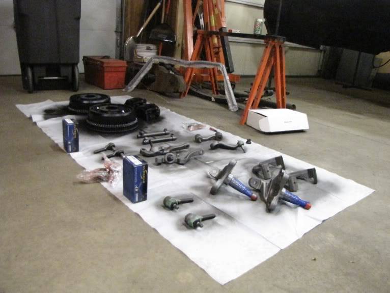

Just some of the parts I'll be installing up front tomorrow (besides rear drums)..Threw on some high temp Cast Blast and also some Black High temp caliper paint on the drums and Caliper's. Also have the newly rebuilt Upper Control Arms/Ball Joints/Bushings, LCA bushings and New Moog Camber bolts to install as well......Still waiting on my pro touring 1.000" bars from just suspension as well as some Upgraded MOOG Strut Rod Composite Bushings
Damn she's looking good. What did you do for seam sealing the seams that are originally very thick like theel house to trunk floor and trunk floor to tail pan?
Did you bed liner yourself as well lol. I used that too. Doesnt come off skin very well. Of course I did just roll my car over to get the bottom.
is it a matching number car?. b5 is a great color. good luck with it. looks great.
Thanks Dave,
I used Evercoat Brushable seam sealer in the trunk. Lays in nice and is just as tough as the factory stuff. I used a whole quart for inside the trunk area.
The underside was full seam welded where I could. The very few gaps left, I filled in with Dynatron seam sealer in a caulk/tube gun.
Russ,
LOL...Yes, I now have about 300 black freckles where my respirator and safety glasses didn't cover. You're right, tough as nails and sure in the hell doesn't like to come off very easy. At least you know it's gonna protect the bottom of the car like a champ.

Hey thanks Jason! Yeah, I ended up decorating myself up nice with bedliner, but it sure beats giving the garage walls/floors the same treatment. I'm pretty impressed with the SEM kit. Sprayed on real nice with the supplied gun and the stuff is seriously hard as a rock. I still have 2 quarts left out of the 2 cases I started with.
