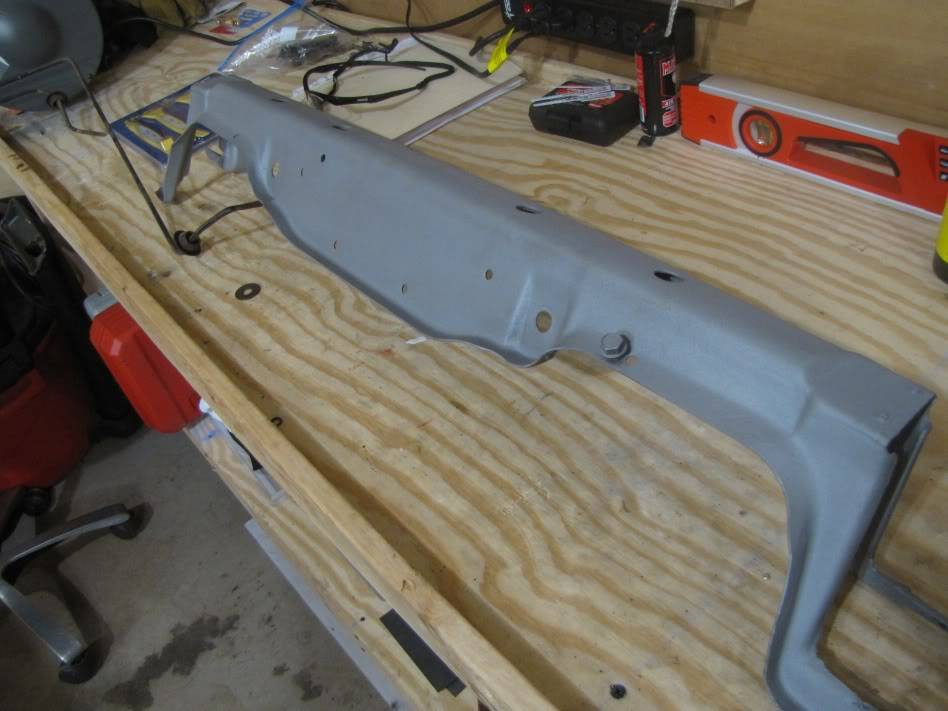

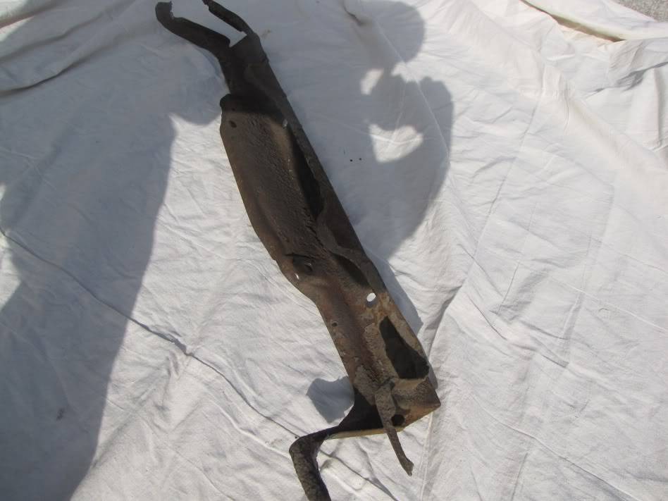

I didn't get much done as far as work on the roadrunner today. Spent a good chunk of the day talkin cars with my mom...Yeah, she's cool like that. She's been a big inspiration and a huge part in my past mopars as well. Happy Mother's day mom! I did get a chance to media blast my shock mount crossmember. Started with a greasy, rusty, dirty old mount and 5 minutes later I ended up with a "almost new" piece to install. Media Blasters are worth their weight in gold
Before:
After:
wow!! that's like a night -n-day difference on that crossmember.yeah,i know what you mean with the wife.I've been married to wife#3 for 5 yrs(july) and i've gotten more things done on my car(s) than i have with my other wives. I think this one is a keeper:yes::yes:.will be looking for more pics as you go along.

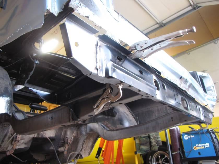

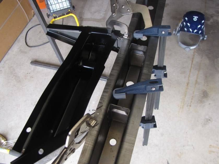

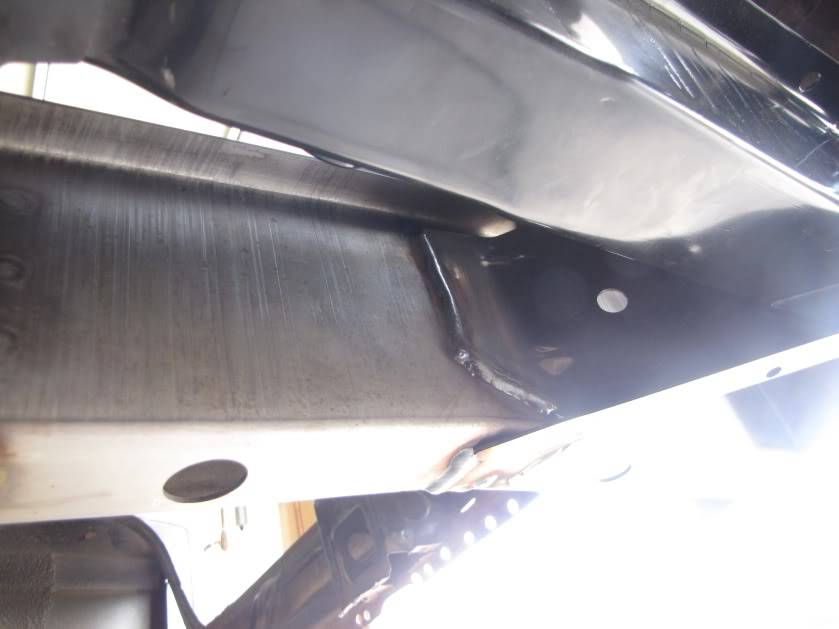

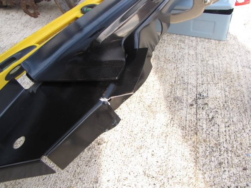

After getting a sideways answer about the offset in the shackle mount bolt/bushing housing from AMD, and recommendations from a bunch of different folks, I decided to weld in the shackle mounts this afternoon. Jigging required quite a bit of help from Mr. Vise Grip and his friend the hammer.
Getting in some of the areas to weld is pretty tough, but deffinitly possible

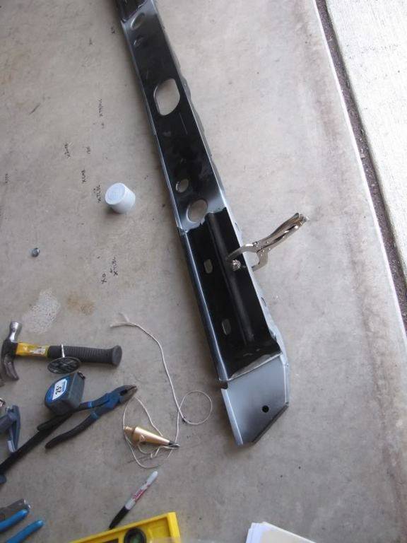

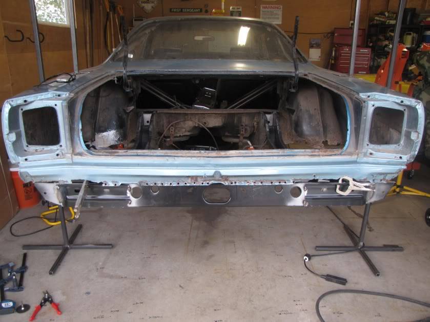

After finishing off the shackle mounts, I moved on to the rear crossmember.
This is the first car that I used a vast majority of AMD parts on. I'm finding out pretty quick that there is no "plug and play" or "turn Key" features about them. Quite honestly, as far as having to modify to fit/work, Sherman and Goodmark are pretty comparable. I guess what can you expect when you see "Made in Tiawan R.O.C." on your parts.:edgy:
Anyway, the crossmember extensions and the bottom of the new cross member both had to be pie cut/relief cut to be able to line up like the factory set up.
After wrestling with the extensions, it was time to weld on the reinforcement brackets. They went on pretty good without a hitch. Although I did notice that the rear crossmember AMD sells has a different opening for the fuel nozzle than stock (factory round, AMD oval), and the upper lip of the crossmember is 3/16" less in width across than factory.
Well after a couple hours of chuging away, old "skeletor" is starting to piece herself back together. Gonna collect myself for tomorrow, focus on fitting and welding in the rear crossmember and have myself a brew...Cheers fellas! :beermug:
Lookin' good Will, you are not waisting any time are you?. You have chosen not to try to replecate the factory spot welds on the frame rails?. What made you make that decision?. Your welds DO look sweet. I am asking because I was not faced with replacing any of those parts with repops, so all of the work I did do on the rear rails, I was having to refill all the spot welds I drilled out. Just curious.
You might have mentioned it before but what are you using for media blasting, (unit and material)? Did a Great job! I know this "old iron" helps too.:)

Thanks for the compliment. I did punch some holes on the top side of the frame rails and the bottom tabs of the shackle mounts. I think they're a bit covered up by the vise grips. However I did not for the sides. The factory used spot welds not to have a more rigid integrity, but to save time and money. I butt/joint welded the mounts in solid basically because it's stronger and i'm not too worried about having a perfect factory look. I plan on stroking out the 440 to a 512 stroker, so with having around 600HP, it gives me a little bit more piece of mind that the rear of the car is not going to be a weak link

I used an Eastwood 100lb. Pressurized blaster with a 3MM nozzle. I guess the biggest issue I have heard/seen with these is keeping dry air running to them. I'm running a Ingersoll Rand Filter/Regulator and Desiccant Dryer for my spray gun/media manifold. Then from there another disposable Desiccant filter at the blaster, then into another filter/regulator built into the blaster plumbing. As far as media, for this piece I used 70 grit Black Beauty at 90 PSI, seeing it around 14-16 gauge metal. I'm pretty happy with the unit thus far.
