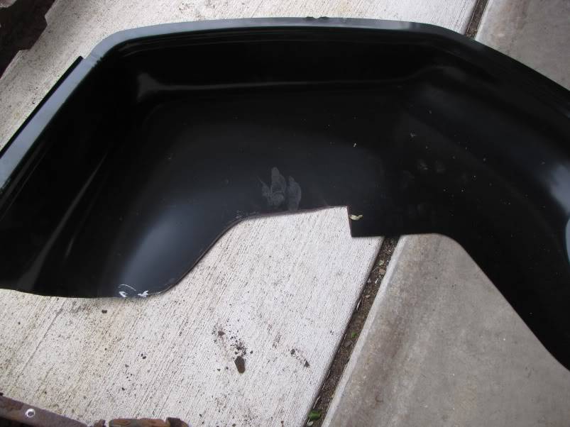

Now some may think it's pretty silly I hack up a new panel to patch in the old, but I do want to stick with as much original metal as I can. I actually find it more of a challenge to be a proficent welder/fabricator, rather than a parts changer...Just my opinion.
Hacked!

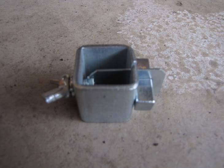

I tried out these little panel jig/alignment tabs from Eastwood and I must say they work great! Don't have to worry about the weight, reach, or obstructions you face with a vise grip, although I still utilized some vise grips along with the tabs.

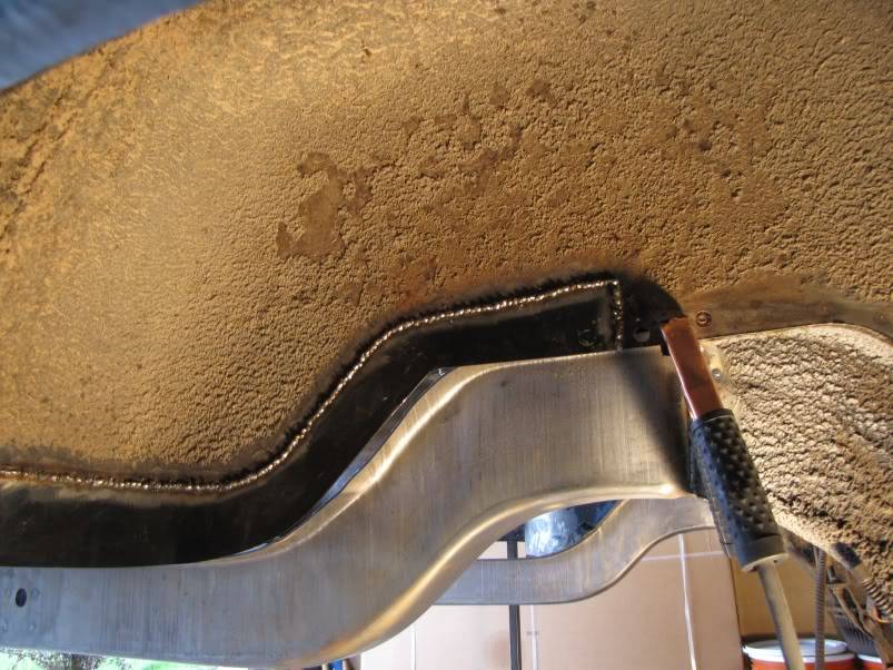

All the tac welds in place.

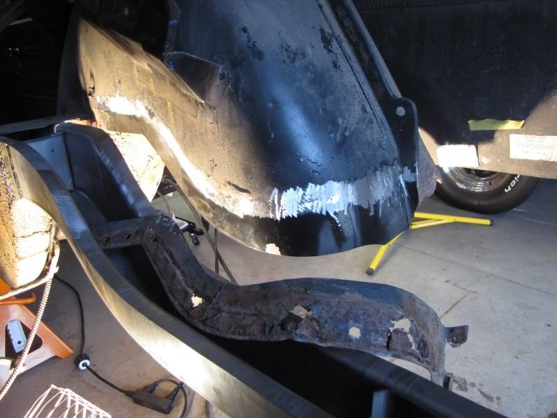

Just like new! As you can see, the old hunk was pretty rotten. I'll move on to fabricating new ears that extend out from the inside top lips of the frame rails for the shock mount crossmember tomorrow hopefully. The replacement rails did not have these ears for the mounting.
