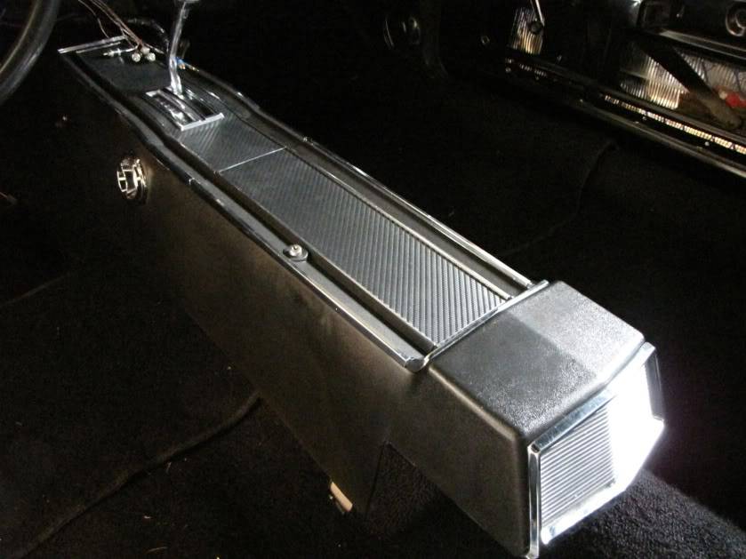

Console is assembled and installed. Just have the carpet to glue on and pop on the trim.

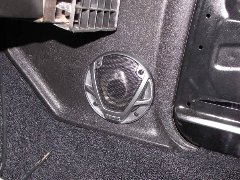

Installed a set of Kenwood Excelon 4" speakers in the kick panels. Was a little tricky lining up the right place to cut the holes in the kick panels. Being there isn't much depth to the kick panels, the magnet of the speaker needed to fall in the opening of the hinge pillar where the lower bolts for the door hinge rest. Few measurements here and there, holes cut and the speakers dropped right in.

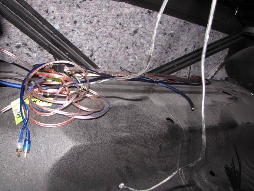

All the speaker wires, pre-amp out cables, ground and positive feed for the amp are all routed to the trunk area. I'll organize it all a little further down the road. With the two center speakers, two in the kick panels, two in the tray and the small sub that will go in the trunk, a total of 7 speakers will be in the car run off a 1000Watt amp and capacitor. Not looking for a trash can rattling in the trunk type sound, but just want a real crisp clear sound to play my tunes.

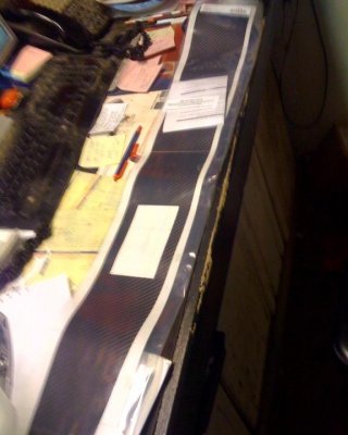

Well, decided to go with a Carbon Fiber Overlay instead of the Woodgrain sticker. The carbon stuff isn't just a vinyl sticker, it's actually a fine adhesive backed layer of carbon fiber made by 3M. I got it from Detroit Muscle Technologies, and just like everything else I got from them in the past, I'm super happy with the product. Love the way it turned out.

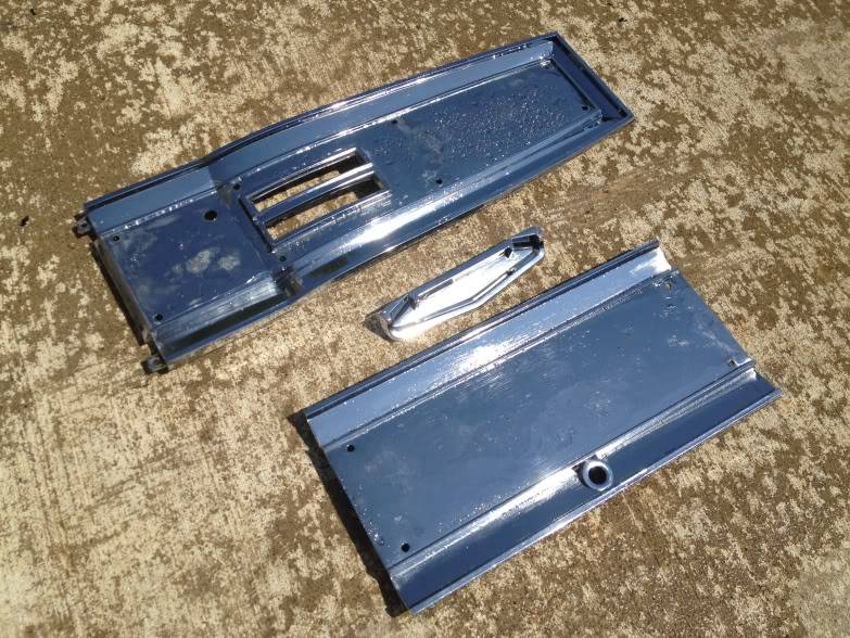

Console Trim.......So, why is it so impotant to have a bench buffer when bringing these cars back?
Skip the aftermarket aluminum stuff made in China...Put in the work and you'll have beautiful OEM american metal trim to put back on your car.

Will when you put your carbon fiber on did you put is right down on the lid surface ? or put it back on the thin tin the wood grain was on ?? if you put it right down on the shiny surface did it lay over the holes with no problems ( no shallow divets ) ? and stick to the polished surface ok .
Stu,
I took off that tin backed woodgrain via the little press clips and the 4 little acorn nuts on the door. I had one area up by the shifter hole I had level down flat with 220 grit. As far as the holes, I put tape on top, filled the holes with evercoat glaze, let it cure and pulled the tape off. Main thing is getting the surface as smooth and flat as possible. The carbon overlay is more rigid and thicker than vinyl so it is a bunch more forgiving than if you were to throw a sticker on, being it doesn't try to settle in every nook and cranny.
For applying the overlay, I misted the covers with windex, layed on the carbon fiber and then squeegeed out the air bubbles/windex with a body filler paddle. I let it sit for a day before handling it. I did have to trim about a 1/64" strip on the inside by the gear selector opening. I probably could have got away with not having to trim and it would have settled right in place, but it was bugging me at the time.
The overlay is stuck to the metal real good. No way is it coming off unless you're specifically trying to get it off.
Best of luck Stu...let me know how it goes and if you have any other questions
