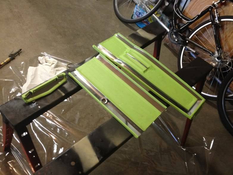

Well, I got the old black trim paint off the console lids........After 4 scrape and wipe's!!! Overall, not impressed. The black paint was pretty thin and worn out and this stuff had trouble with it. Aircraft paint would laugh at this stuff. I won't be buying again. Anyways...black paint is off as well as the woodgrain inserts
Masked off for the black..A little hard to tell from the pic, but the metal down in the valleyed down areas had open pore pits and pimpling spread about. Just covering it with a 1K satin trim paint would have looked like garbage. So, I sprayed a light layer of SEM texture before laying the paint down. Buried those flaws really well.

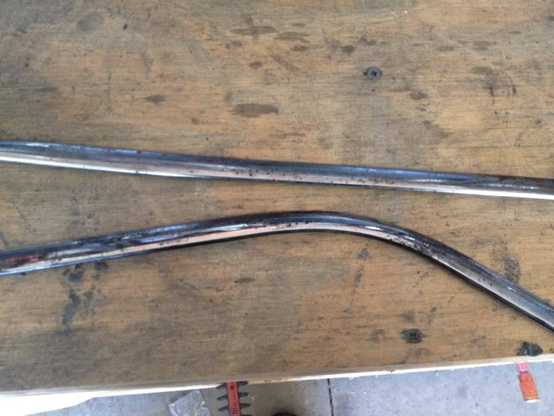

Console Trim.......So, why is it so impotant to have a bench buffer when bringing these cars back?
Skip the aftermarket aluminum stuff made in China...Put in the work and you'll have beautiful OEM american metal trim to put back on your car.
