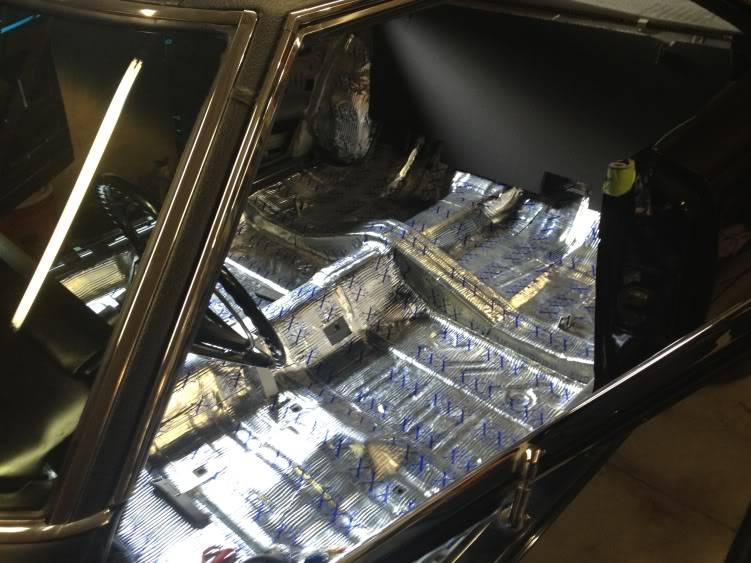

Finally got a little bit of time to peg away on the bird. Little bit of a product review. Stuff is called RattleTrap and it's a sound deadener. Same stuff as dynamat but costs less. Actually has better decibal reduction. So far...good stuff! Lays in and cuts pretty easy, use the provided roller to flatten out. Also installed the new AMD quarter glass, the divider and insulation.
Applied it on the floors, inside the doors and inside behing the quarter windows.
Also started the wiring from the trunk forward for the Stero AMP. 4ga wire that runs through the firwall to battery, 4ga. wire for ground, and pre amp outs. Picked up a set of 4" coaxial 160W Kenwoods I plan to intergrate into the kick panels.
More work to be done tomorrow!
Looks great man, looks like it came fit to put in, Triple x, that will give you a quieter ride ill wager! I put some cheap stuff down on my floors and behind back seat, problem is i have no idea how much it worked never having drove the car before i finished it.. Looks great though and it yet one more step to that first ride, i can imagine how you feel, but at the same time enjoying doing all this... continued good luck bud!

Superb work work as always, Will!!
Rattletrap, eh? looks like an interesting product...did you have to heat 'er up to get it around the uneven spots?

Those seats look GREAT!!! just missing butt prints! :3gears:
No Doubt Mario. I keep thinking, "i'm getting close now!", then I think of 20 more things to do..lol
How much rattletrap did you have to buy? 25-50sqft
I bought 100 SQ FT. Not seen in the pic's, but I also did the inside of the roof before the headliner went in. I would say I have about a quarter of it left.
