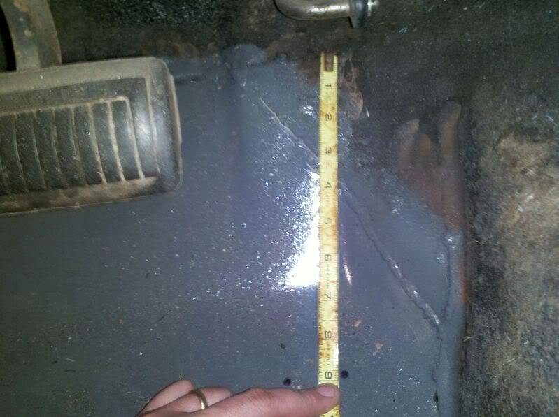

Will, "go pedal" bolt holes:
Hook the tape on the front edge of the toeboard where it meets the firewall seam. Do this centered under the throttle lever like so:
pull the tape tight to 8 3/4", don't follow the conture of the floor pan but pull it tight.
8 3/4" seems right for both holes.
Now measure from the left edge of the floor pan back towards the trans hump...
I measured from the outside of this bend where the pan edge lays on top of the inner rocker.
Lining up with the 8 3/4" mark down from front edge of toeboard, mark holes at 17.5" and 19"
I used my old pan as a template for these holes.
Use these measurements to get you close then rest your pedal studs on the marks before you drill and see what you think for any minor tuning.
Hope that helps.
