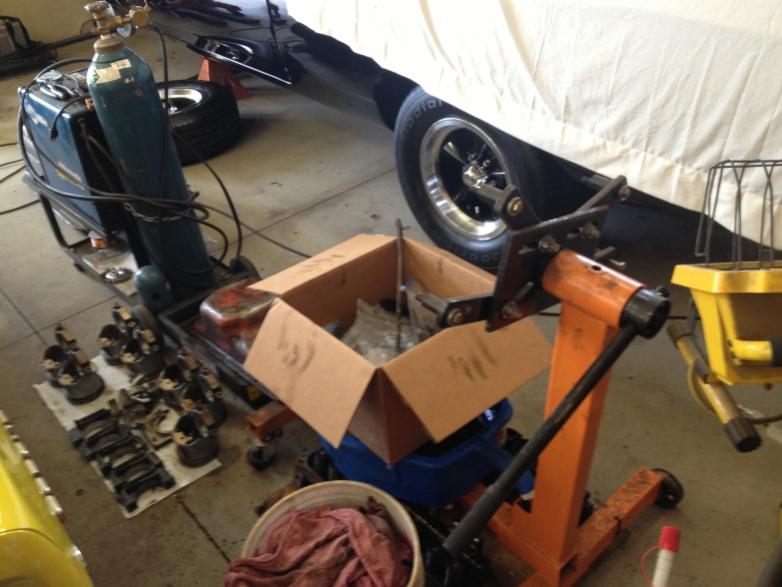

Alright fella's.....Finally!! Yes finally my budget/funds are in place for the 440 to be turned into the tire frying 512 Stroker. Tore the 440 down to the core over the weekend. Pretty clean inside and it looks like someone was digging in there lately. Had a purpleshaft Mopar cam in it and the lower assembly had a bunch of machining marks on the rods indicating someone did some balancing. No ridge on the tops of the cylinders, some honing was still visible and the valvetrain looked pretty fresh. Only strange thing I noticed is that I believe the person that put it together had some crazy fetish for permetex. LOL Unbelievable amount plastered everywhere. The front cam bearing's Babbitt was coming apart like shale and no oil slinger off the front of the crank... some slight scoring on the main bearings. Other than that, cylinders Mic'd out at pretty much stock bore so we're ready to roll.
So...Engine is at the machine shop ready to be hot tanked and then Magnafluxed. After we get that squared away it's off to the races with the machine work, balancing and adding parts. Good stuff!
