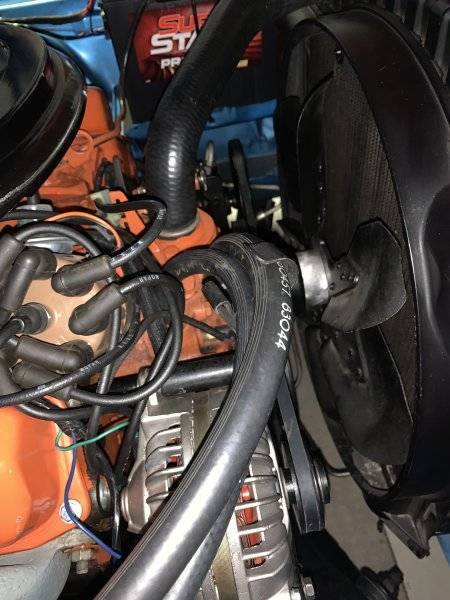

Hello,
Hope someone can help. I think I have the fan in backwards in the attached picture. I didn't take any pictures months ago when I disassembled the engine because" I'll remember how it goes" LOL!!!! The engine is a 440 and the fan is a seven blade off of a 413 HP engine. This is in a 1964 Plymouth Fury Wagon. I'm using a three row aluminum 22" radiator from "Flea Bay" Do you think I'll have any cooling problems?
Flip it, bent blade ends towards radiator, flanges that support blades towards engine
It is backwards. You may want to look into a thermo seven blade and shroud if you need more cooling.
