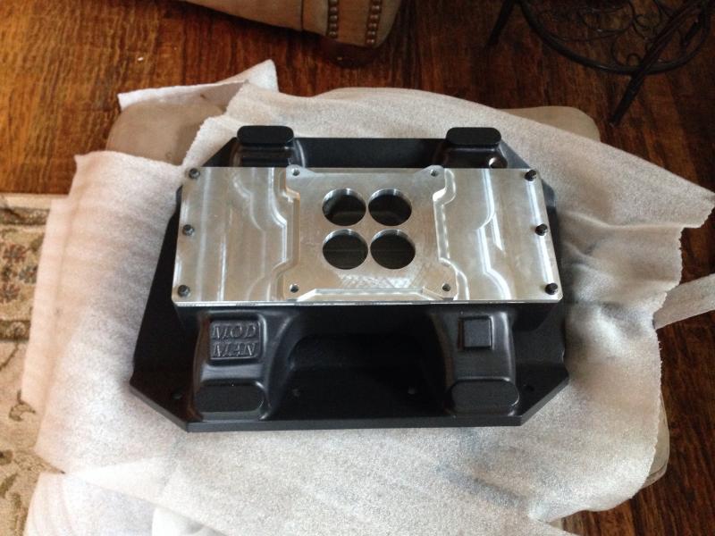

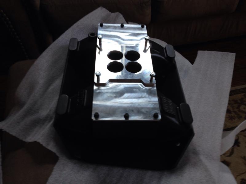

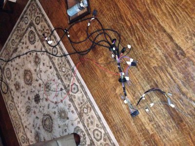

All the boxes just showed up. I am just about done with the complete re-wire of the car so the timing is perfect. I will post some pictures here in a little bit. I will take a lot of pictures and try to document it as a how to guide for those of you that might be interested in doing this swap.
Here are some pics so far
Looking good. if you don't mind me asking, how much does EFI that setup cost? I am already doubled over my budget anyway, looks cool.
The complete setup with fuel system is about $3100. Another $620 for tcm. You can do it for less if you have a magnetic pickup distributor and efi ready fuel system

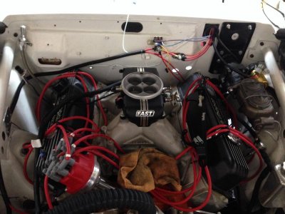

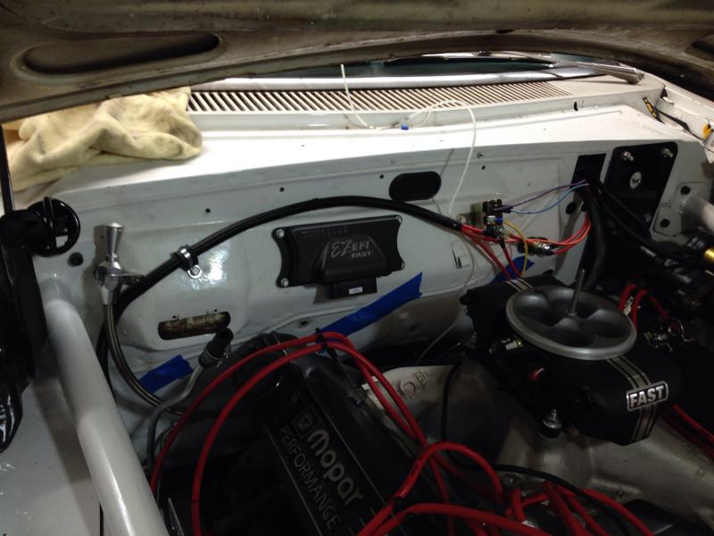

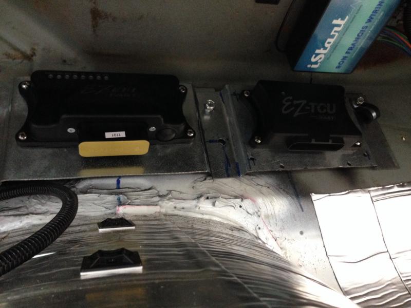

So the hardest part of getting started is figuring out where to put the ECM. It's hard to find a suitable spot that will handle the wiring. The sheer volume of wires in the harness seems overwhelming. A lot of it won't be used, but it's still a lot of wiring
Ok folks. The ECM has a new home. Now I need everyone to pray for me. I'm going to completely split this harness and put connectors where I need them and reassemble.
I give up, for tonight anyway. So the only thing I really dislike about the kit so far is the harness. I gets that it's supposed to be "EZ" but it makes you put stuff in places I really dislike. Oh well. I'm sure the first drive will make up for the frustrations

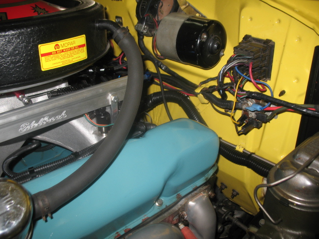

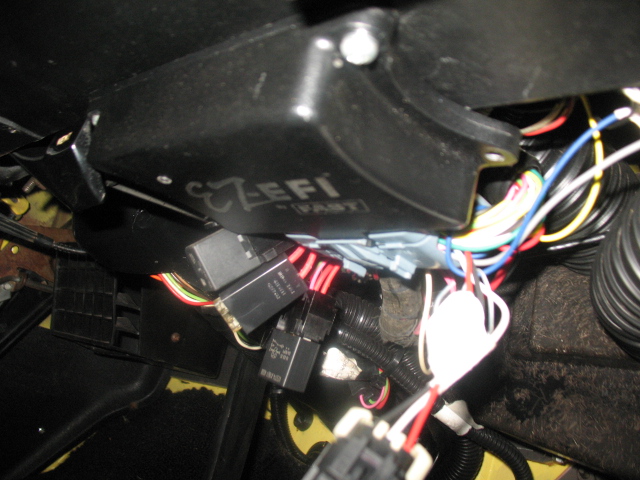

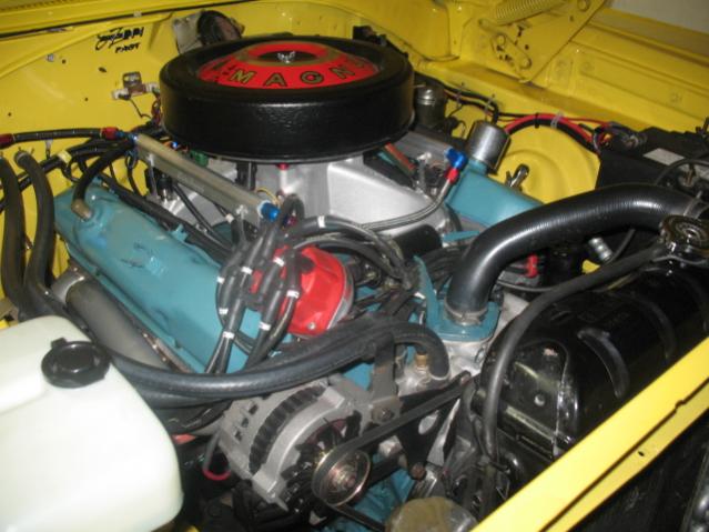

I ,ve just installed the first gen. EZ efi and found the instal went fairly smooth.I looked at the harness and laid it out to use the body plugs so there was no hole drilling.The computer mounted on the underside of the dash near the ignition switch ,routed the harness through the firewall plug for the manual trans clutch pedal rod along the firewall down the drivers side valve cover,pretty much isolated from any sources of electrical interference such as MSD . The harness is for the multi-port upgrade. Just going through the final computer learning stages. Had to upgrade the alternator and wiring to maintain constant 14 volts.The engine is a 496 stroker with a hydraulic flat tappet cam 244-256 IE @50 112 LSA 525-521 valve lift. Measured 12"-14" vacuum @ idle
