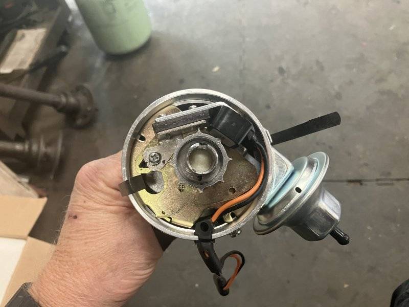

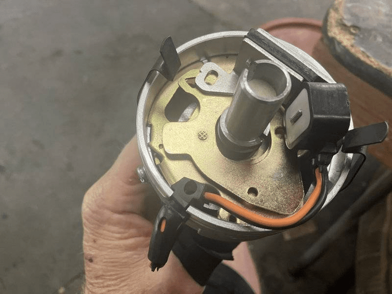

I just got this one that I am going to restore, taken off an old running 440.
I also run a limiter plate in my car now, 16 initial, adding 18. Great little metal plate.

Now you got me curious, Russ....
I don't recall seeing a notch in the Big Block distributors.
None of the LA series ones had it either but I've been looking on the notch side, not 180 degrees from it. I'll take a closer look.
It sure would help, sort of like a Woodruff key on a crankshaft dampener.
All the Mopar Electronics have them in cam plates for electronic ignition. I have a really hard to find Mopar clear cap prob from the 60's that some one made I use for phasing, 99.9% of the time they are right on if the pick up is right for the 8 cyl and not a 6 cyl one which gets installed alot. Thats a whole thread right there in ID ing them..
Thanks, but....not really. I can't tell the difference between those two.

I have never seen the single "hole" Reluctors except on aftermarket and some early lean burns. But with Mopar I would not doubt it!
Never did use a 6 pickup but never thought it would be different.....just thought the reluctor would be the determining factor.

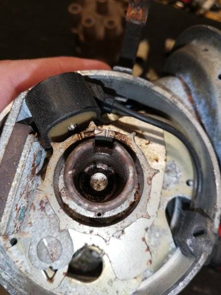

The ones I used are brass. What makes you think that steel were used?
Your eyes are better than mine. I had to get the reading glasses to see that.
It is probably a strand from the rivet I filed down. Maybe I'll give this a quickie blast of compressed air before using it.
