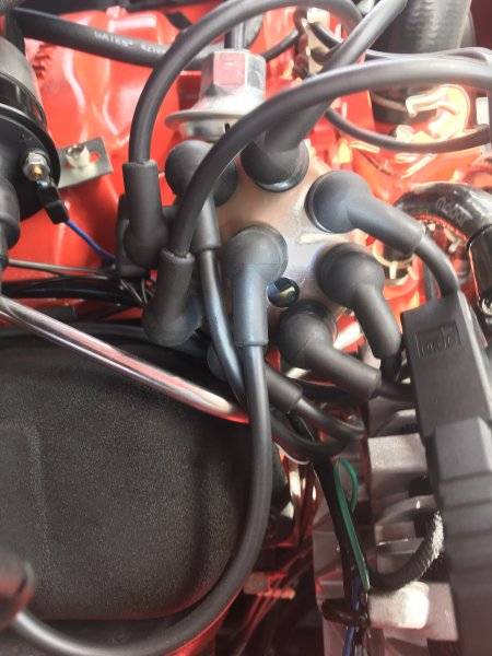

I've got a stash of original Mopar electronic distributors for the 440 in Fred.
They're all at least a couple decades old, but new (as in not been used).
Two are original DC/MP units and one is a reman Arrow original and I've played around
with using each one in the car - and there was very little difference in any of them when
used in the manner I do.
I don't typically run the vacuum advance (mostly because I hate fiddling with the tiny
allen screw and messing with things until the jitters are taken out of the cruise condition
timing) and I set full advance to 35*, which this particular engine likes best (confirmed by
vacuum gauge as well as seat of pants).
I don't really care much what the timing is at idle, but it winds up being about 15-18* BTDC
typically.
Happy to also report no issues with knocking or such and I run 93 octane meth-free gas in him only.
On the odd occasion I've had to settle for other gas, Fred does NOT approve - and proceeds to digest
it even more quickly than the "good stuff".

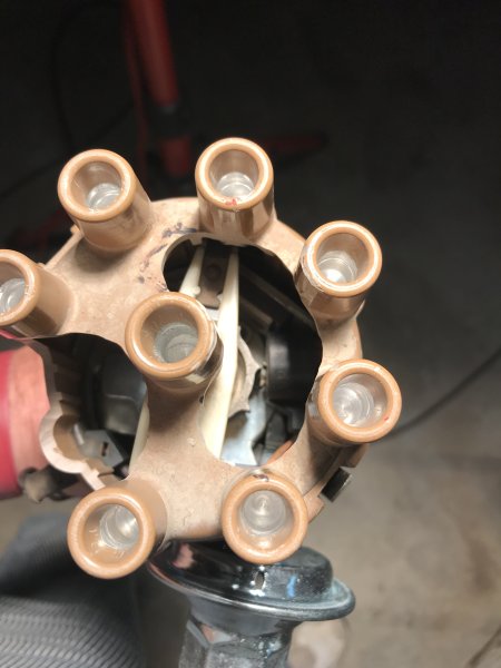

I keep an old cap with an hole to check rotor phasing on Mopar Distributors
Idle
Cruise
Vacuum
Check at all RPMs with timing light

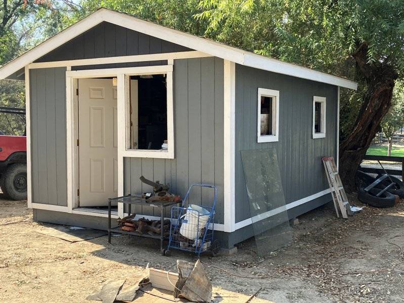

Where did you stack them all!!?
They are spread around. I have a couple rows in this:
It is a 12 x 16" horse barn that was here when we moved in. I moved it when I cut the area down 4' in 2011.

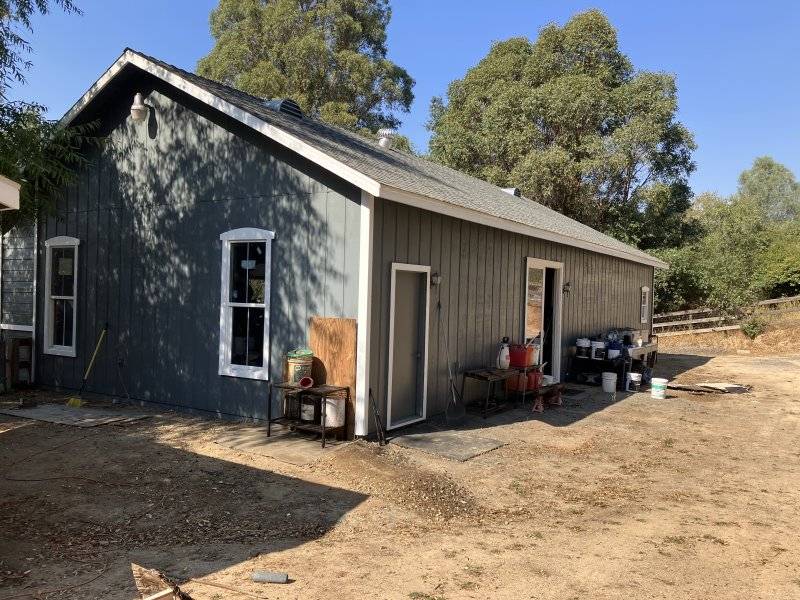

I also have more cabinets in the shop next to it.

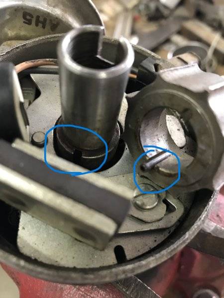

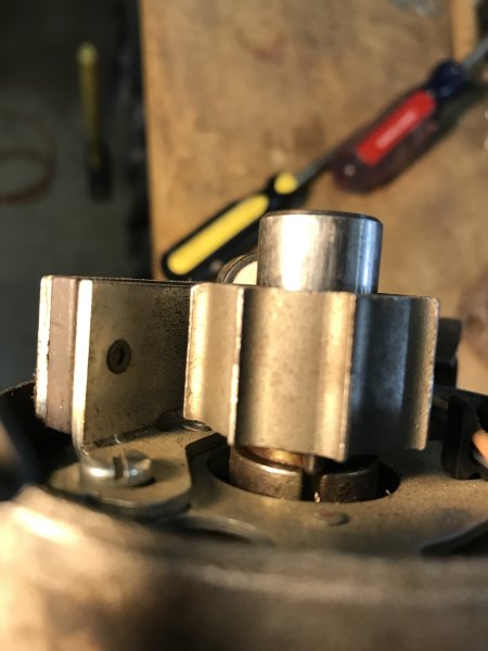

Maybe this helps some.
This shows the slot in the shaft (180* from the rotor slot), the shaft shoulder the reluctor will get pressed down to, and the keeper pin in relation to the reluctor.

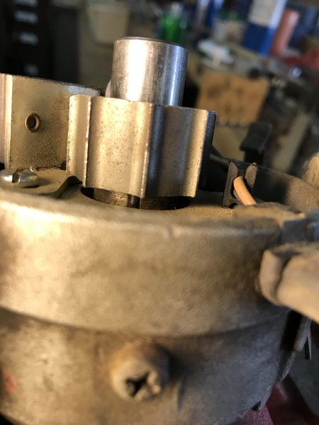

Going back on, pin lined up and reluctor about 1/8" above the shoulder.
I use a slot screwdriver to push both the pin and reluctor down together. If the pin comes up after pushing the reluctor down it's not lined up correctly. There is room for the pin to be lower in the reluctor slot but not more than maybe 1/8".

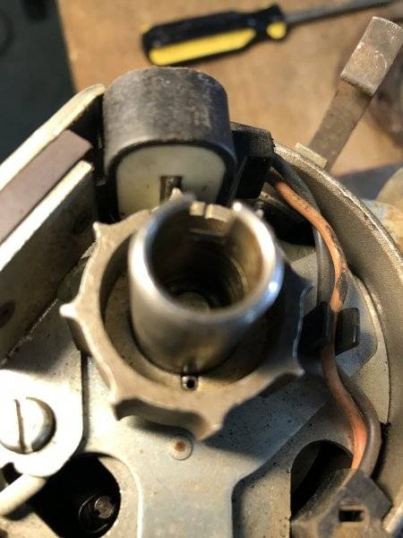

Seated. This can be done in the car, just don't drop the pin.

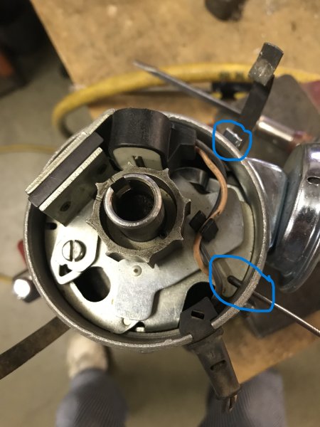

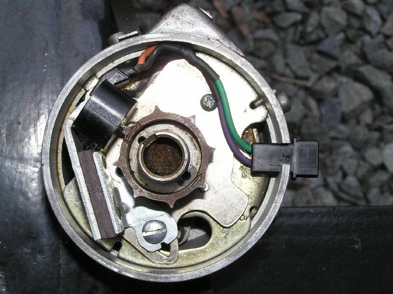

Also don't overlook this. There should be a roll pin lining up the plate with a hole in the housing and a hole in the vacuum advance mount. This helps phase the pickup plate with the distributor cap tang on the advance mounting. I'm using a drill bit, (or that might be a finish nail), in this pic to line things up before tightening the screws.
