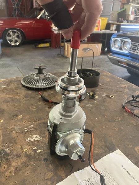

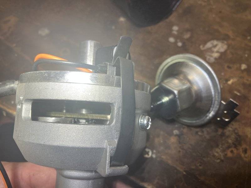

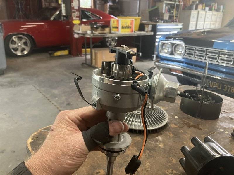

Last night at our monthly Mopar club meeting, a member put out this for the raffle:

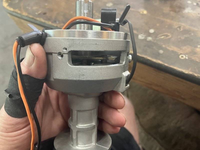

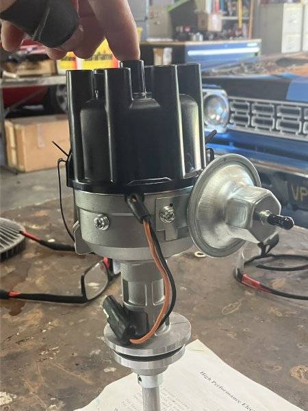

This is the same model as the one I bought awhile back. The guy gave it up because he found that if you invert it like this….
The shaft will spin but sometimes stops and won’t spin unless you twist it harder. Something is making contact inside. It doesn’t do this when standing up normally. We told the club guy that unless he drives his car upside down he would be fine. He contacted Rick E and the man just sent him another and said to just keep the “bad” one.
I don’t think it is terminal… I’m going to take it apart and see where it is making contact. The reluctor and pickup are not touching at any of the 8 points. It is below the “breaker plate”.

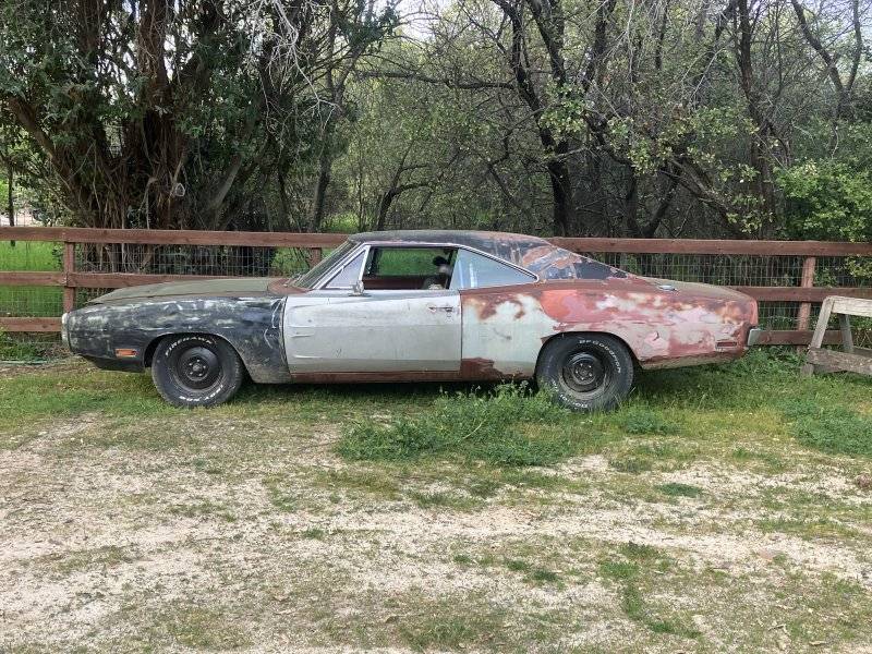

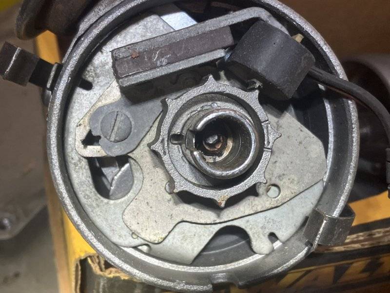

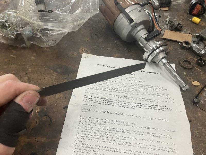

For my Jigsaw Charger, I had a nice stock 400 electronic distributor. I did the old school trick of welding up the slots on the T bar.
Now I don’t pretend to be an expert on this. I’m just a guy that jumps in and fiddles around until I break or fix stuff.
Welding the slots works but you have to take the distributor apart to do it. If you weld too much, you just take a round file and saw it open more. I welded up about half of the opening because I figured that I only needed about 14 degrees of the 28 degrees of advance the distributors often have.
For my first effort, it worked. Jigsaw idles at 18 BTDC. And tops out at 32 degrees. This is an iron head 383 with 9.2 compression and 91 octane gas. It has not detonated yet.
Yeah, it is ratty but it runs great and is reliable. I have not had a single “no spark” issue. If it has gas and a battery, it fires up and runs.
This car though…

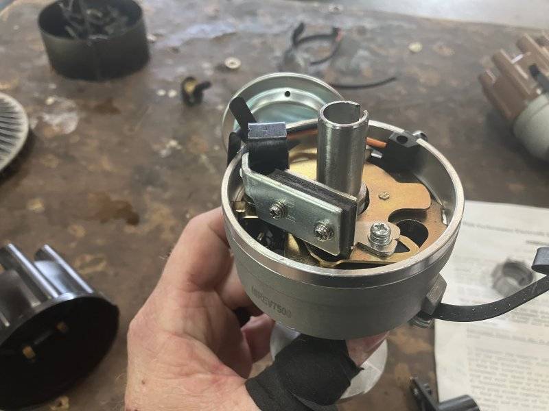

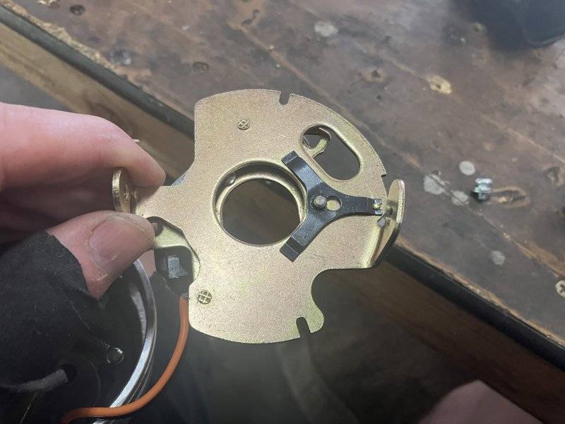

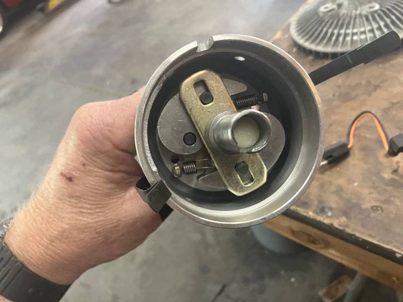

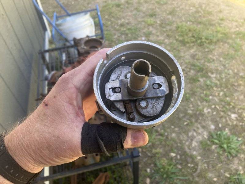

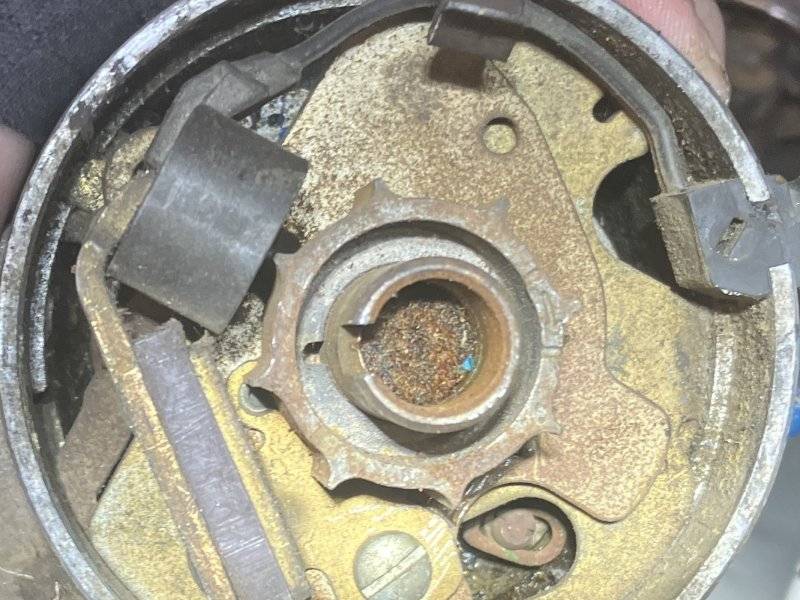

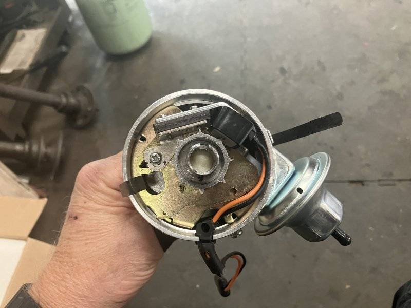

It is mostly apart.
I see no contact marks on the plates.

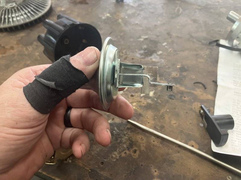

The vacuum can seems fine.

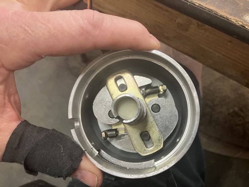

Down to this, it seems to spin freely.
You can see it has one stiff and one light spring.
I’ll reassemble it and see if it still makes contact.

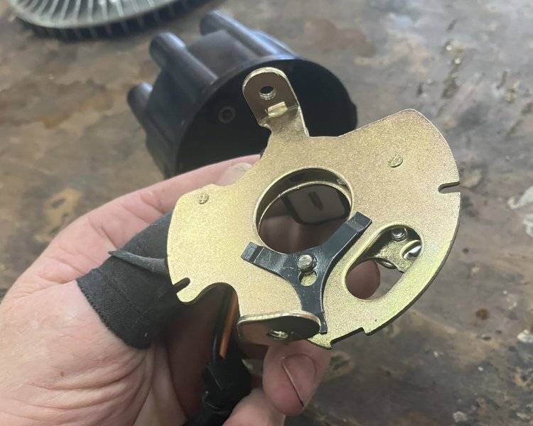

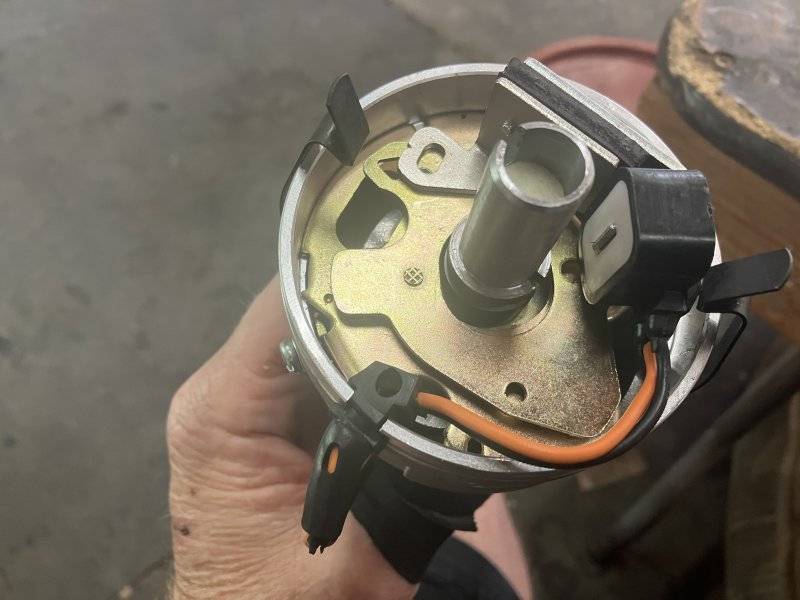

Is the clip in place on the center of the shaft?
Here it is. With the breaker plate back on, it makes contact again.

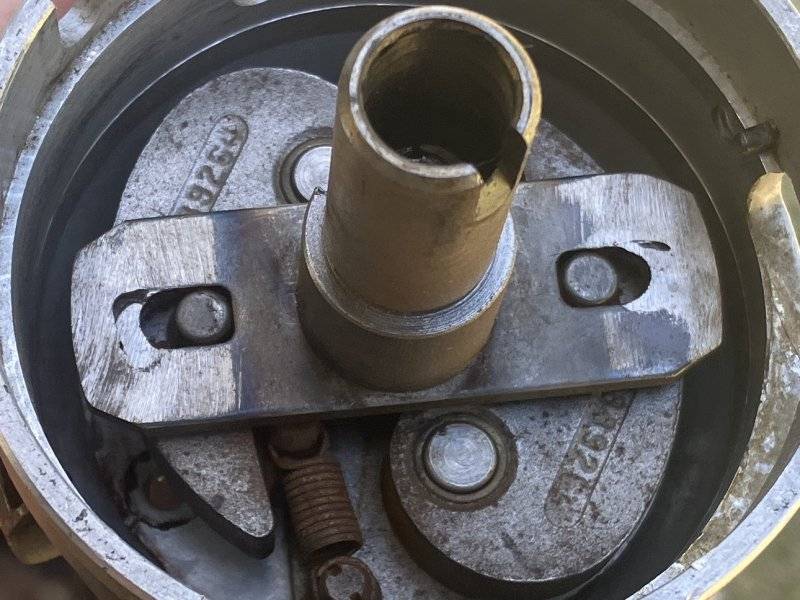

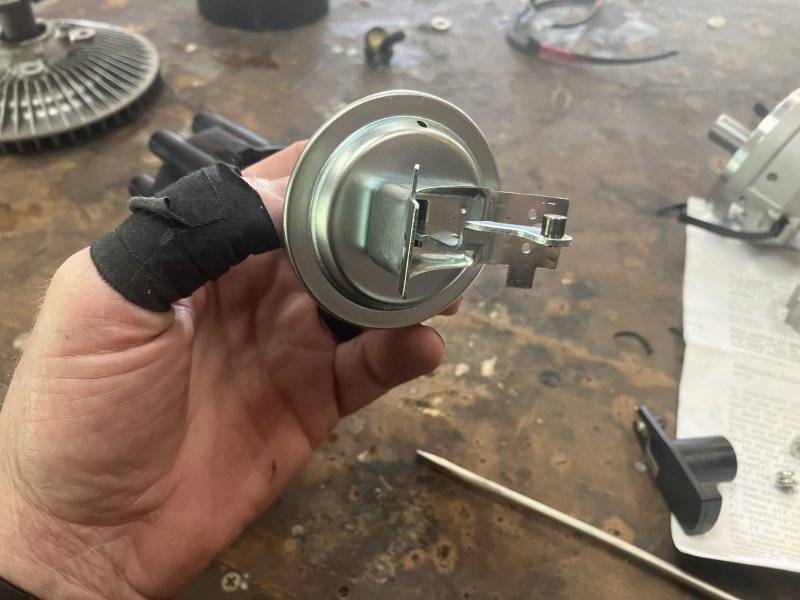

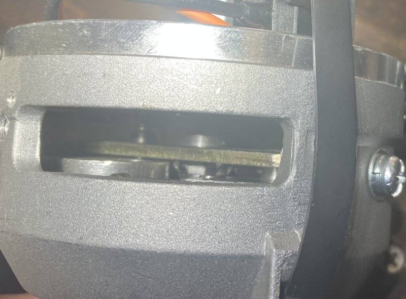

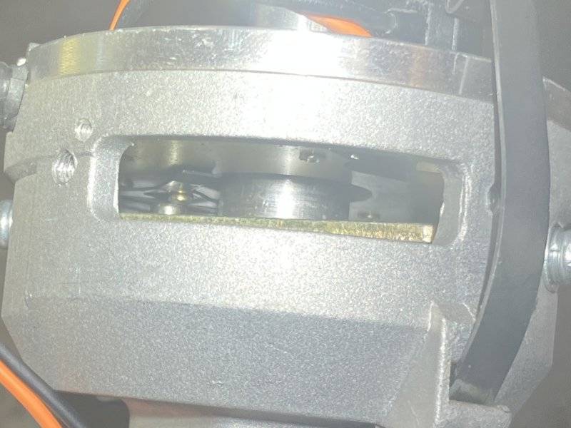

I had it back together complete with the vacuum can and still couldn’t see where it was touching. I pulled the can…
Big window now to see through and….

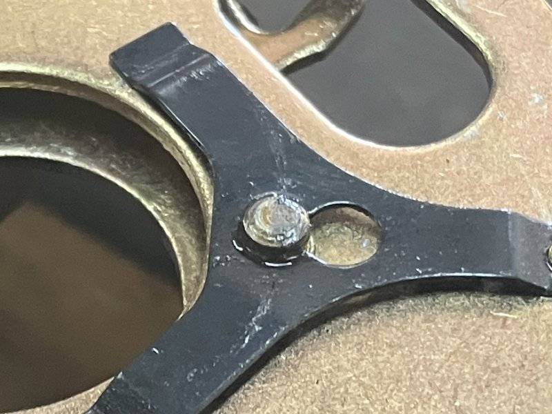

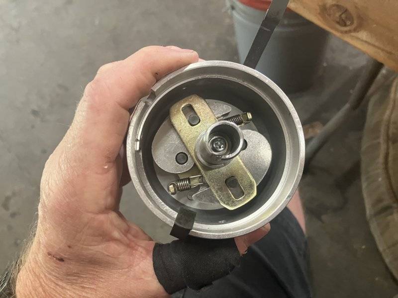

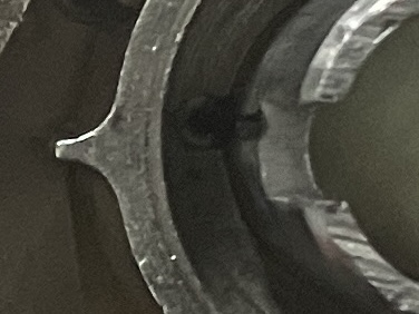

One peg on one of the advance weights was touching a rivet.
Center of the picture…

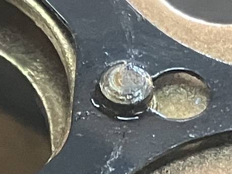

Upside down. The one with the black triangle spring.
You can see the gold anodizing worn away.

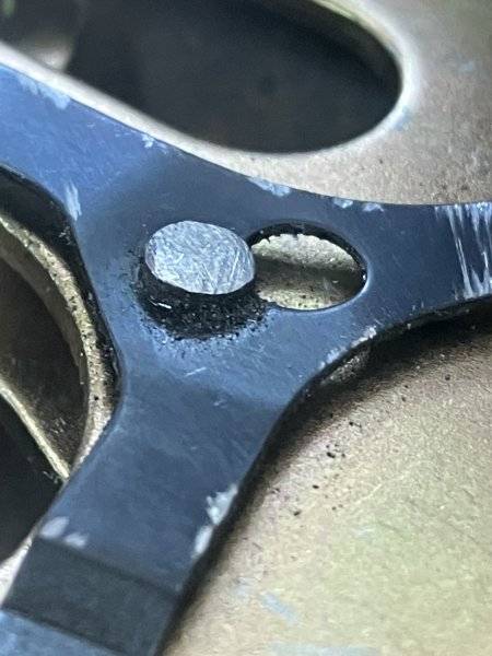

Looks like I can file a few thousands off and clear the T bar.

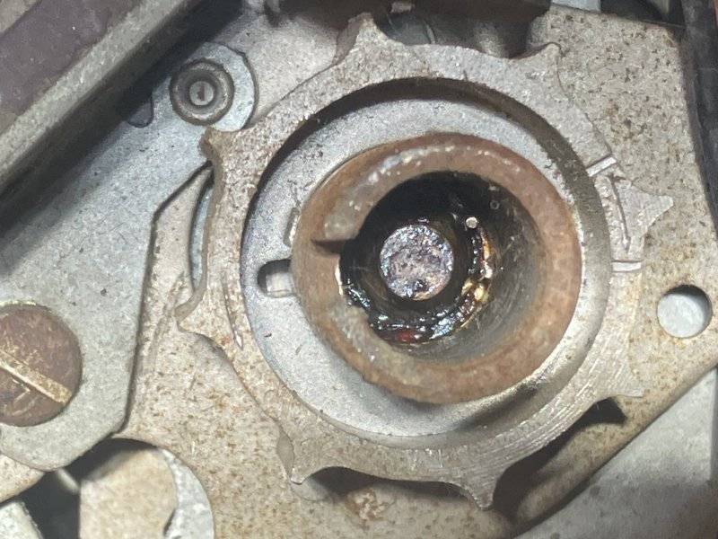

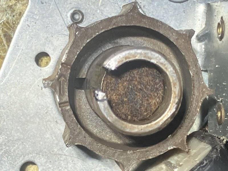

I don’t see any clip.

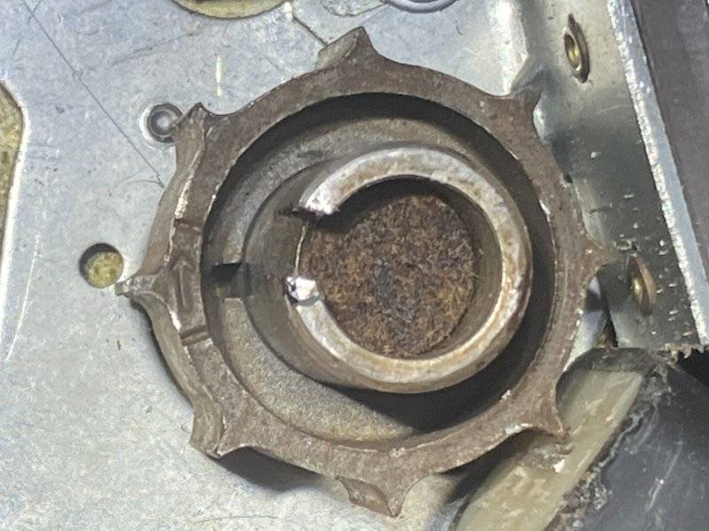

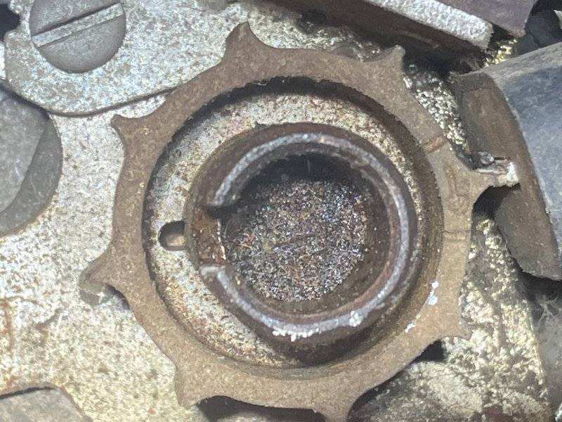

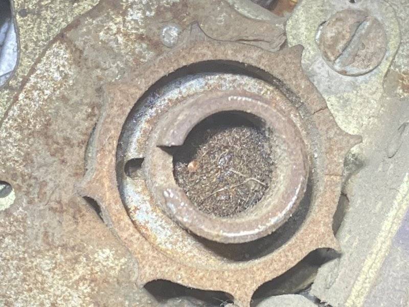

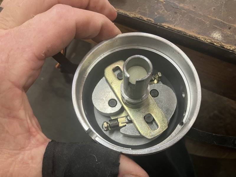

When I took that fibrous washer out of the inside of the shaft, I saw this:
Different way to retain the T bar but it seems okay.
I’ll file that rivet end a bit and test.
Boom.
No more contact. It clears.
Score!

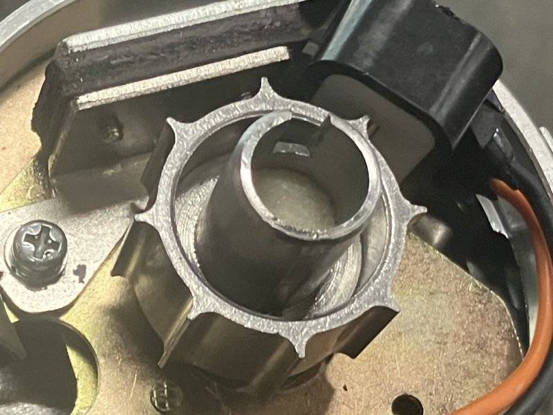

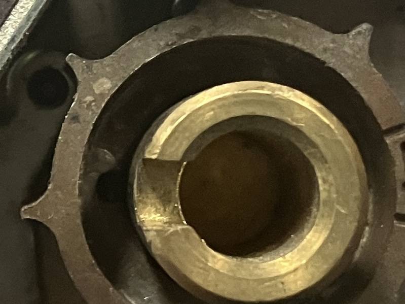

Here is one though…. The reluctor wheel isn’t indexed with any sort of key way.
I did mark it and pressed it back into the same position but it has 8 points that are evenly spaced to match the distributor cap terminals. I don’t understand how these can be in the right place for each one. The rotor is indexed.
Can someone explain that for me?

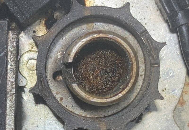

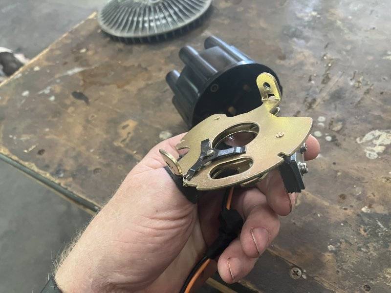

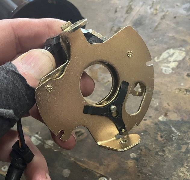

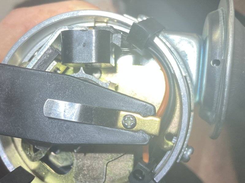

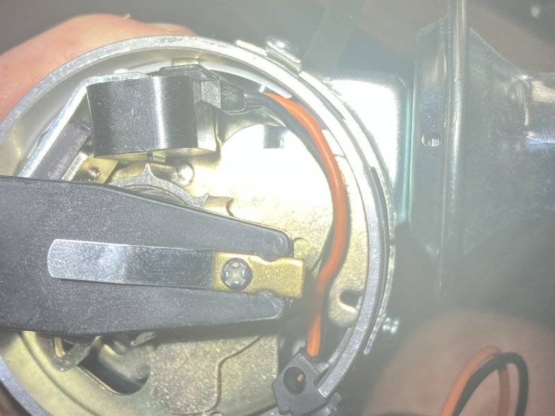

Here is my point.
The first picture is the distributor I’ve just reassembled. The rotor tip lines up with the vacuum can. See The reluctor and pickup coil.
The reluctor terminal point is slightly away from the pickup.
Now the untouched RE distributor I bought from a FBBO member.
Rotor pointed the same yet now the points align. What issue could this cause? Would the distributor just have to clock one direction or the other and sit slightly different from the other but still work correctly?

Makes no sense. The reluctor has to be phased to the rotor.
I would expect that too.
The second to last picture in post 9 seems to show a slot in the reluctor that almost lines up with a slot below it, could there be a pin that goes in there? It is hard to tell from the picture.
I saw that to but figured he would of questioned that.
Three distributors are shown below. All three with shaft in same position. You can see the roll pin in the reluctor lines up with the rotor notch in the end of the shaft.
The above is the RE distributor I had apart. I put the reluctor wheel back on as it was before. The one roll pin in the wheel (two are in the wheel) that is visible is in the center of the notch to index the rotor.
Here is spare Mopar Performance distributor.
Roll pin in center. This last picture is of the RE unit I bought awhile back.
The roll pin is slightly off center. The scribe line on the shaft is off center too.
All three have slightly different positions of the pointer on the reluctor despite the rotor tip being in the same position. I know the MP unit (brass shaft) works. I haven’t tried these other two yet.
Eberg was selling adjustable reductors with several slots to choose from, so you phase the reductor to rotor. You say there is no keyway. Just a press fit?
