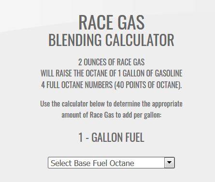

Blending of "Race Gas" octane booster, note wording 40 points of octane. Comments.
