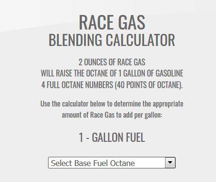

Blending of "Race Gas" octane booster, note wording 40 points of octane. Comments.View attachment 922809

Just curious as to the source of the Race Gas Calculator? Looking at the posting, it appears that the program came from "The Race Gas" company which may be slightly "biased". I would think that its not simply a volumetric or octane averaging calculation, but may (or should) factor in the heating value, in BTU/gallon of the components as well as, possibly, other factors, like specific gravity, Reid Vapor Index (measures volitility) or simply the octane average. But not knowing how it, the program, was derived or the overall objective (to sell their product?), it's difficult to predict (or accept) the results. I'm skeptical..... Just my opinion of course.
