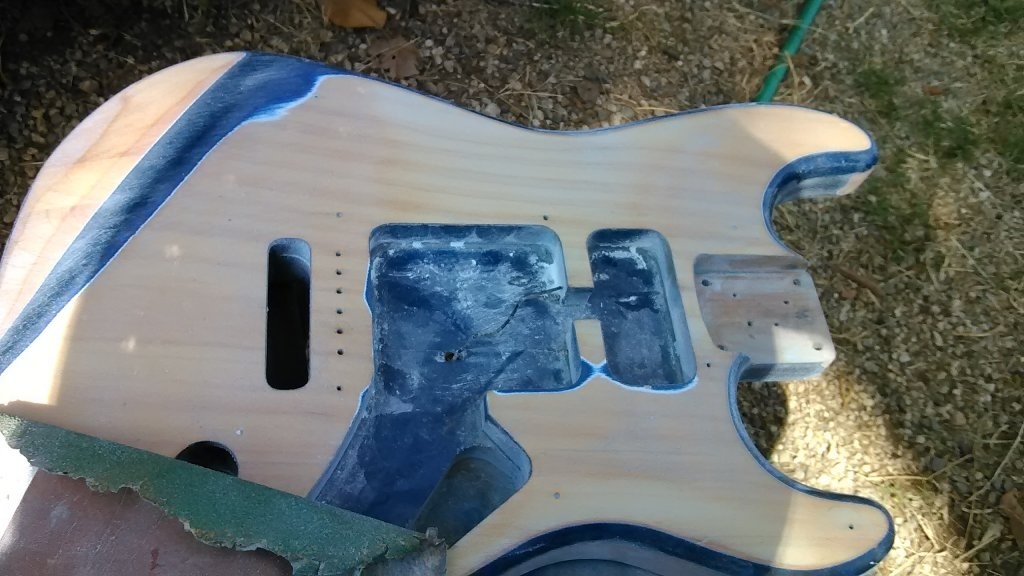

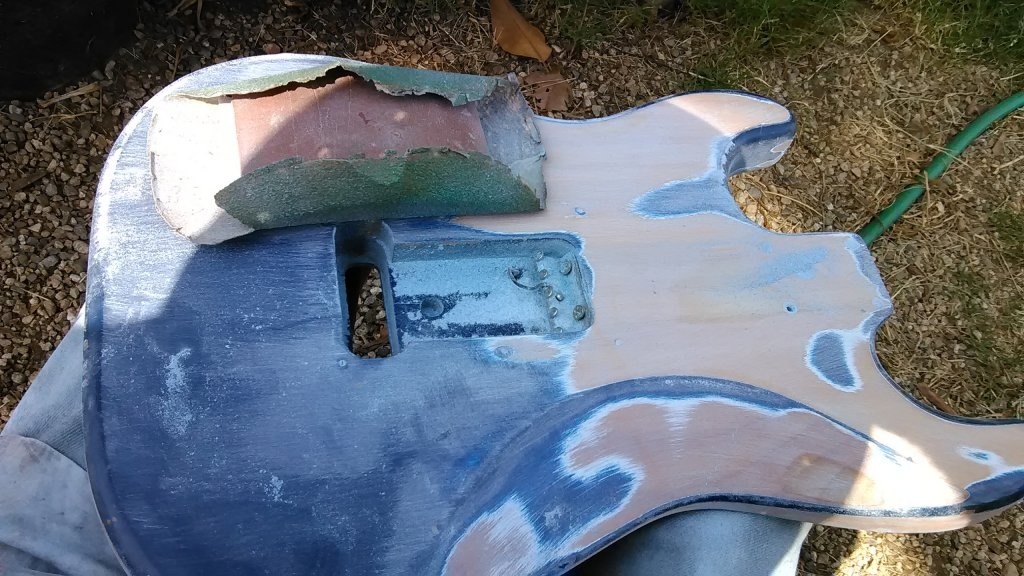

Doing some wood refinishing.....old strat body, had a ton of checked paint & clear.....blocking it out, thing had swelled badly...so flattening it out again....that's wood......never stops moving. This will be French Polish, no chemicals other than oil & red wax.....starting in worn 40 grit
,block it up to 320 dry....then wetordry w/ oil up to 2000.....then buff in red rouge/wax..gives the wood a nice natural stain & gloss

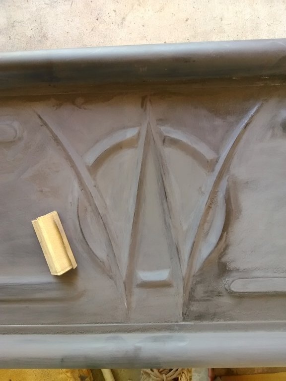

Finger f-ing, hair pulling madness....time stops! Try blocking crap like this flat, without 'ditching.'
Oh just spray primer & whip sand it....no big deal.......

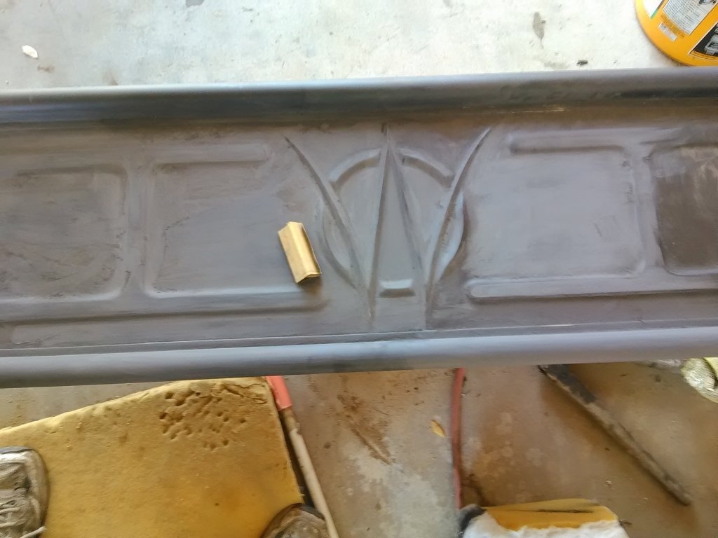

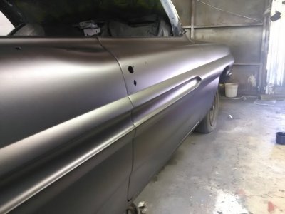

Repost. The Jeep PU body parts are going to be painted within the month & then the 62 Poncho GP is up to start getting some black.
