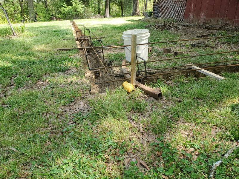

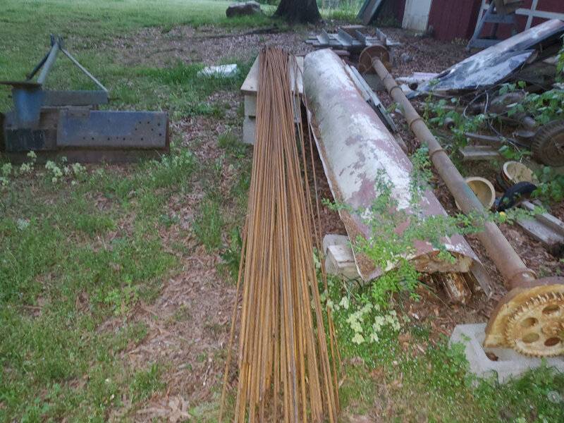

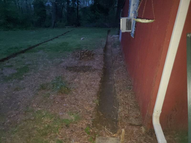

The weekend was pretty productive, but I had hoped to get all of the cages done and start working on building forms around the slab . . .
But here's the progress . . .

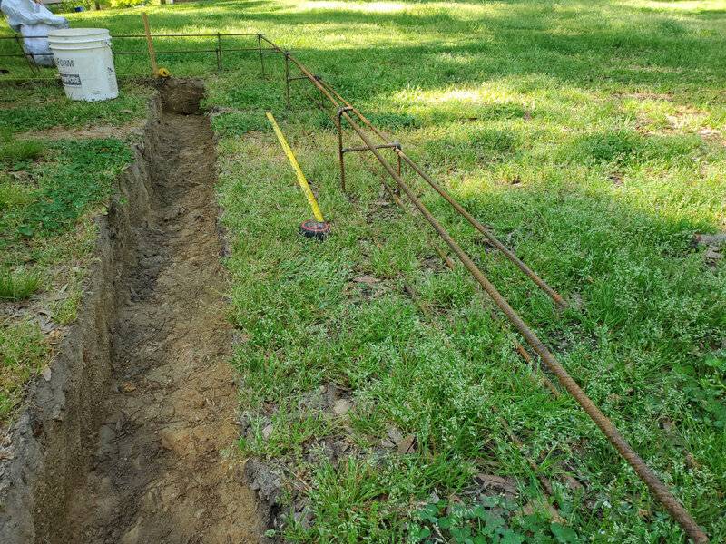

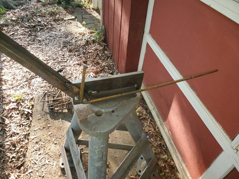

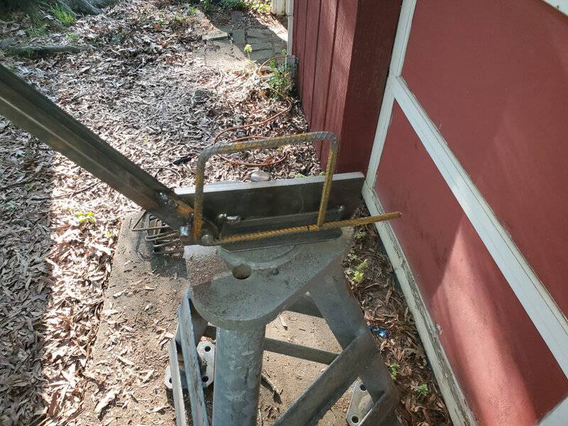

Started at one of the corners because I figured that would add strength in the corners . . .
Then worked the other corner and down the other side . . .

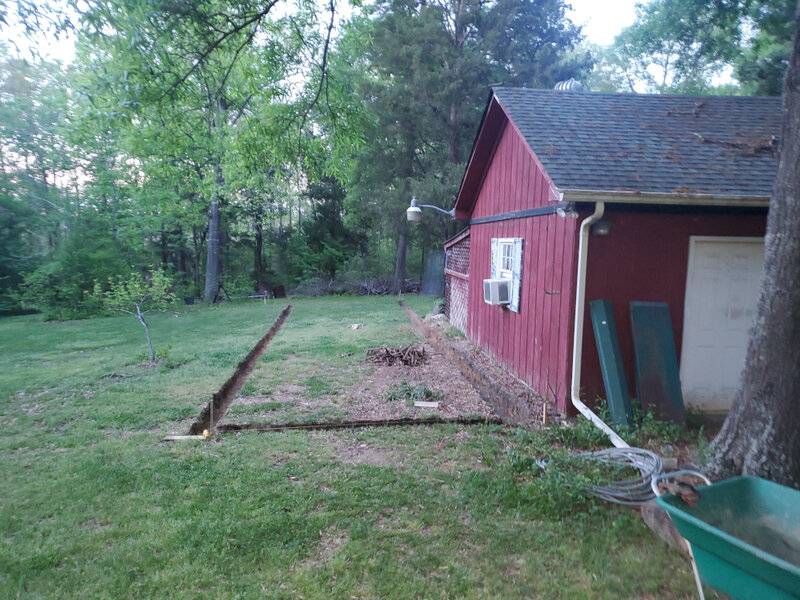

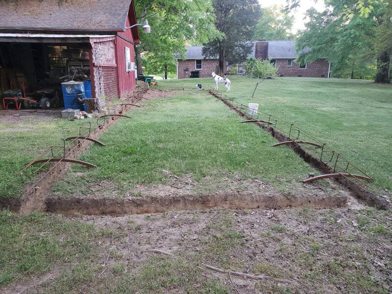

Then I needed it set up to get a better idea of the lengths . . .
Not so bad . . . moving along pretty well with the pieces that I made . . .

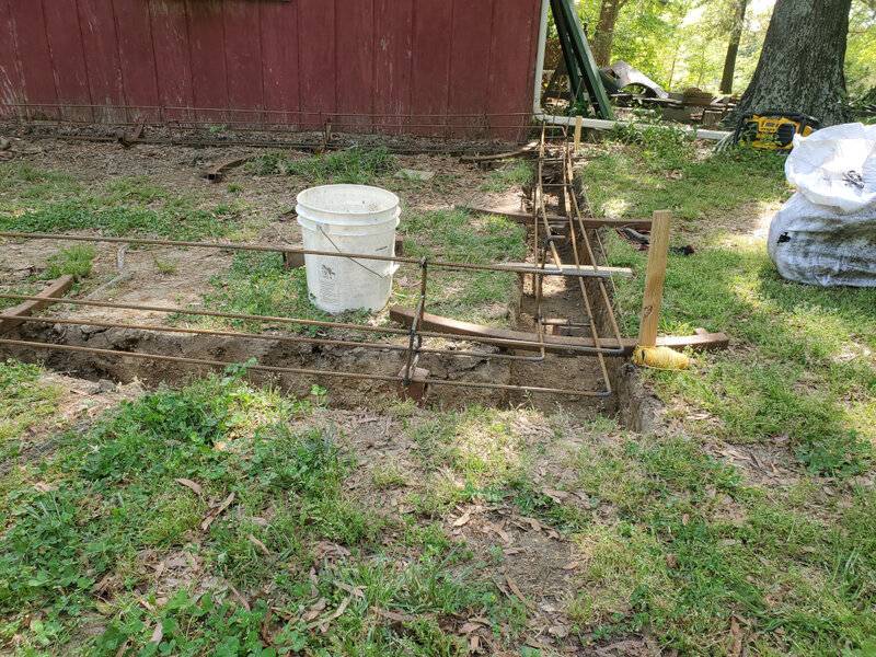

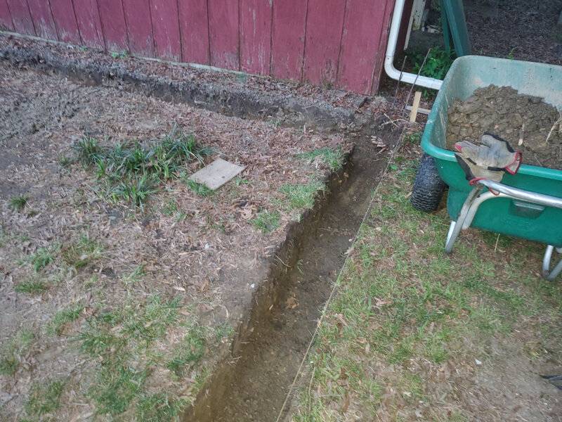

Someone mentioned that I was lucky and didn't have to remove any trees . . . this BIG Cedar is going to have to go . . .
Got this far and then ran out of the supports that I built . . . so I had to make more . . . more later . . .

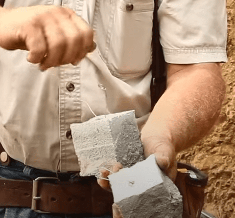

they actually sell these things . . .
These are call wired dobies . . . concrete with wire imbedded keeps them spaced off the ground . . .

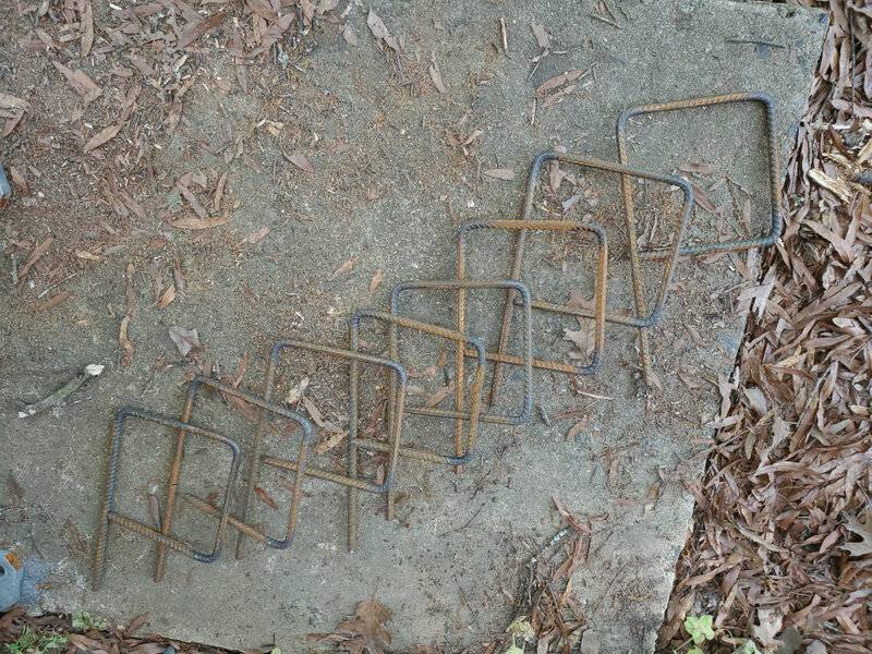

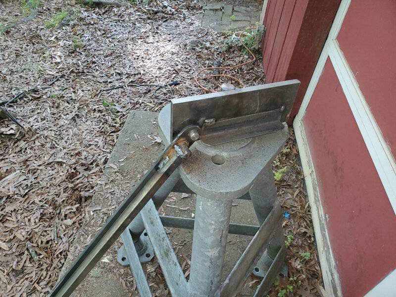

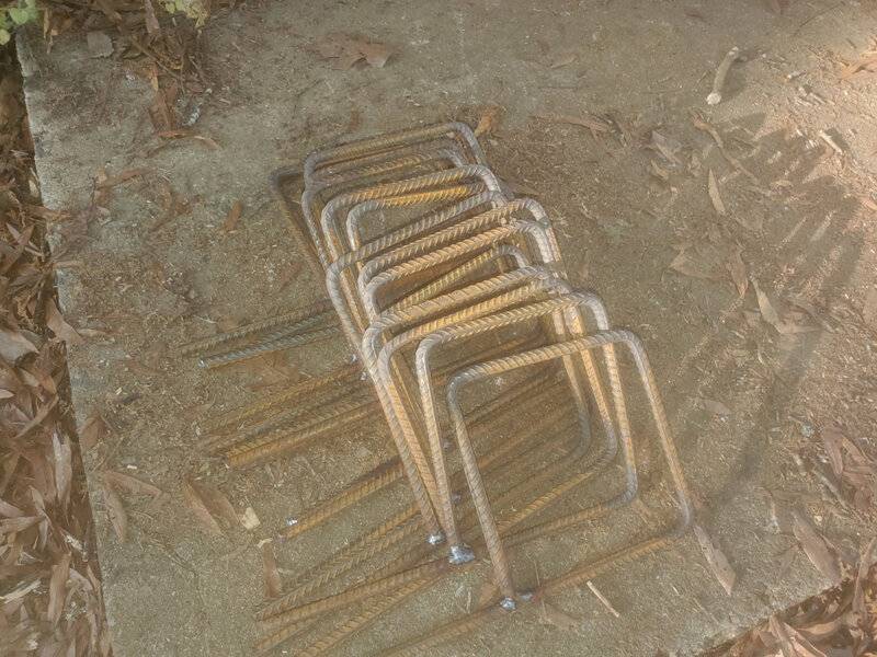

Now for the more later . . . had to make up another batch of frames (again) to hold the rebar like these:

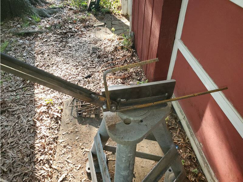

SO worked on the Sunday morning . . . and I've got to say now, I'm GLAD that I'm using #3 rebar (that's 3/8") as the making of the 16 that I did, kicked my behind, if I had used #4 ( 1/2" ) I can only imagine how I'd be feeling now. It's like "isometrics" where you push on something and it doesn't move . . . that about describes it . . . that's the reason that I didn't complete the cages . . .
