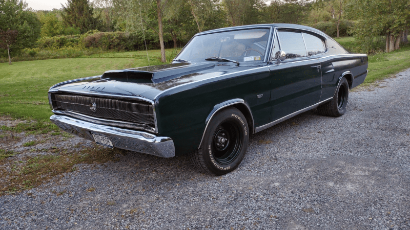

I have the 1.03" bars in my Charger and they are very nice.
