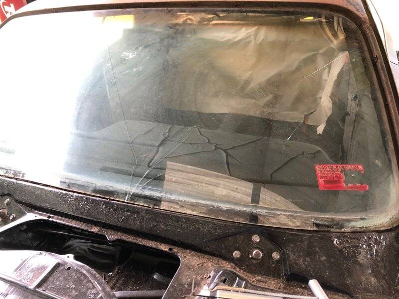

First use of windshield removal tool....

Lots of soap and a couple of whale bones. Ready makes it easy. But I have been there broken a couple also.
That's a bummer. I trick I learned long ago was to take a heat gun and go around the gasket, softens it up and makes it easier to work with. Soap is your friend like bearman suggests. I'm sure you'll find another windshield to replace the fubar...
I m assuming a new one is available. The heat gun to presoften the rubber sounds like a good trick that could help, never thought of that. Yep, one thing leads to another, with a new windshield , now I will have to get a new dash to match....
