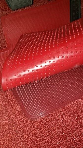

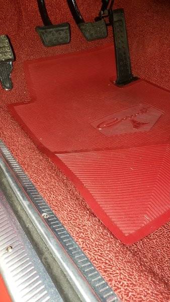

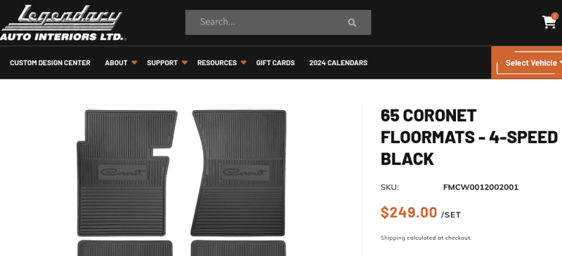

I have these in my 65. They are excellent. They fit perfect and have grippers
on back... And they look correct for the year. If you need pics let me know
but they are $$$.

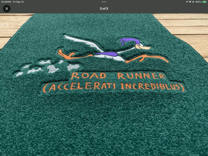

Yup I have to reset my "SATELLITE" monogramed floor mats basically every time I get in the car.
Me too. I was just looking the other day on eBay to find something that would fix the problem. I couldn’t find anything that didn’t involve drilling the car or the mat. Neither of those are an option for me.

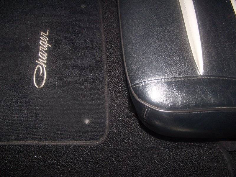

While the jury is still out as to whether these anchors actually hold my mats in place, they are doing the job for the time being. The only one really giving me grief was the driver side mat. Something about fitting my carcass behind the wheel always seemed to force that mat up under the brake pedal in short order. Hopefully this was the cure.
Do you have a link. Do they just grip to the carpet and mat? Let us know how they work.

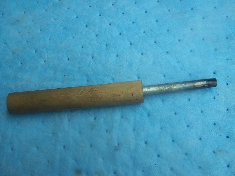

There is a link to an Ebay site where I bought mine in post #1. You get eight of the anchors. You have to make a hole in your floor mat for the plastic bolt to go through. Once you get them mounted to the mat, you put them in place and push the spines into the carpet. I used a rubber mallet. They have a tool to cut the holes in the mat but I made a tool years ago to burn holes in my carpet for the seat frame and seat belts. I like to melt the hole rather than cut it since the tool does a better job of making the hole without ripping the threads in the carpet. Here is a pic of the tool I made for making the holes. I heat the end of the 1/4" pipe with a benzomatic torch for the hole which ends up about a half inch. By the way......I only anchored my front mats since they are they ones that seem to get out of place. No one ever sits in the back anyway.
