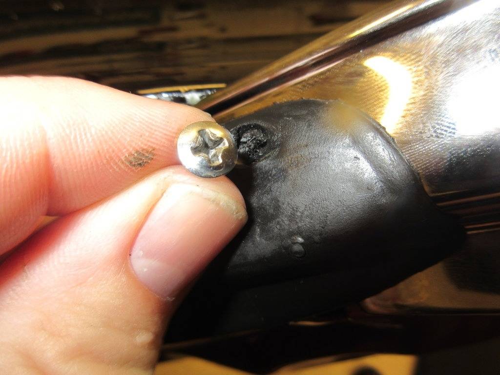

Got the glass/vent window installed...Special thanks to RC's advice on installing the glass prior to the fuzzies...I have always done it with the fuzzies installed and it was an adventure, lol....There is enough room RC my friend:thumbsup:
Don't forget the foam in the lower adjustment rod or you will have a rattle...
Correct chrome screw for the door seal end to the chrome vent window...the other two screws are phosphate...

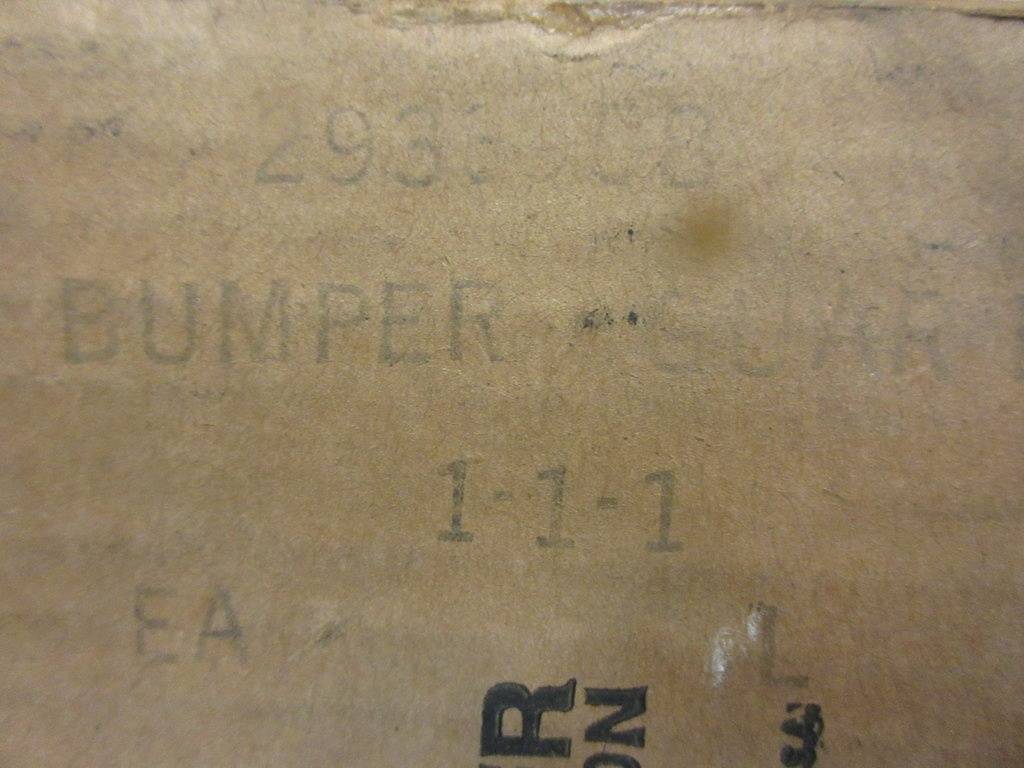

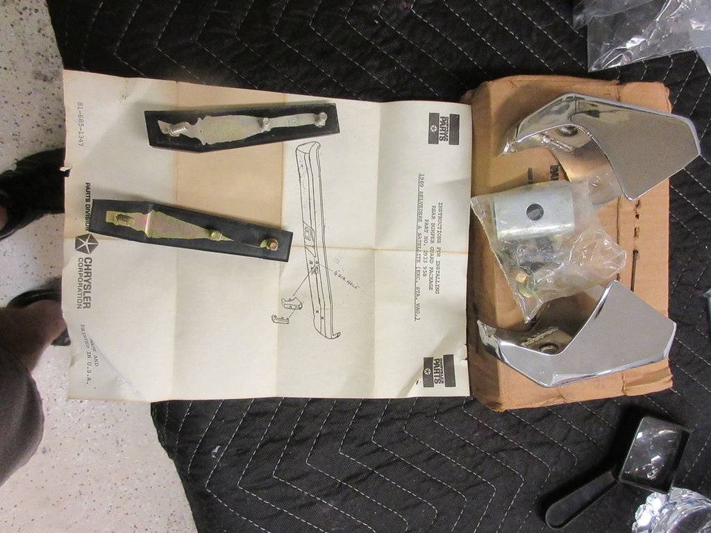

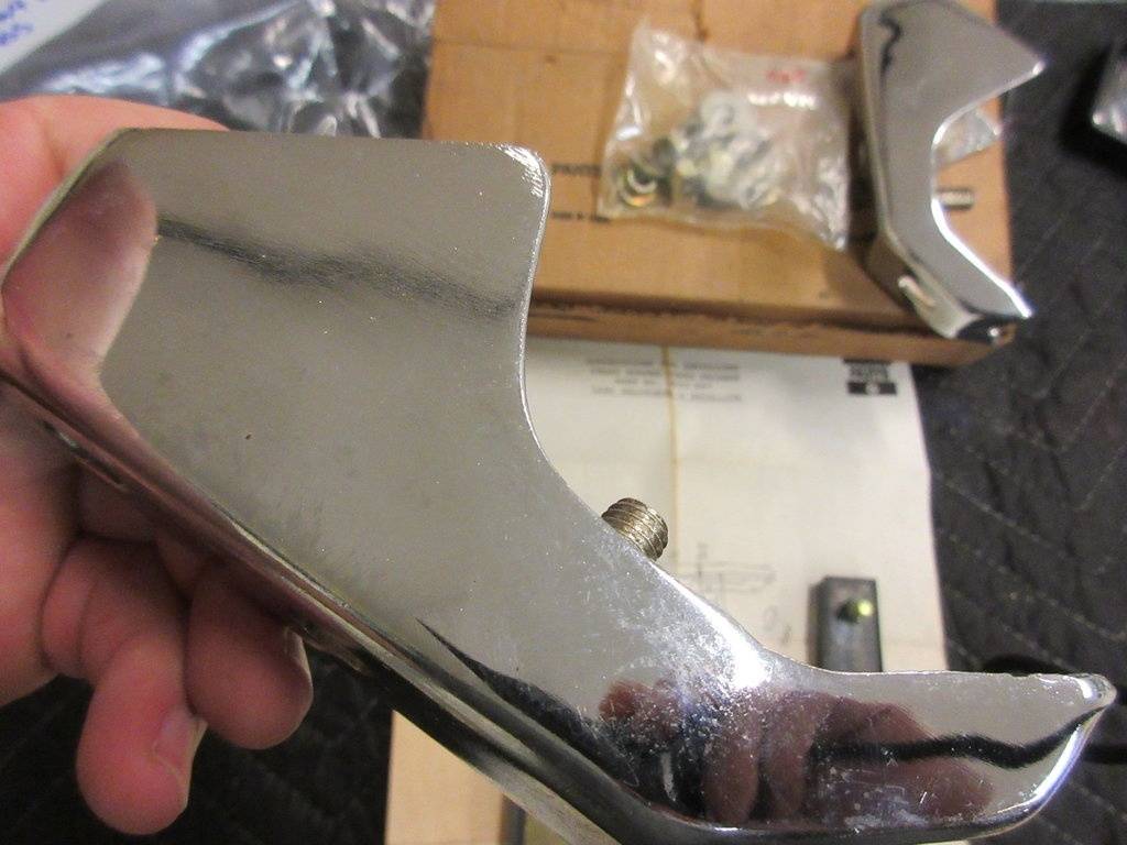

My NOS front and rear bumper guard kits came the other day.....What a find!
Try city plating will chrome these...
