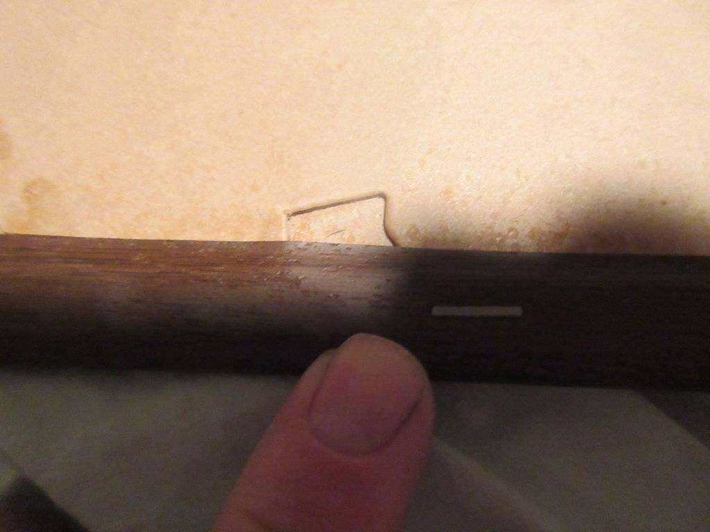

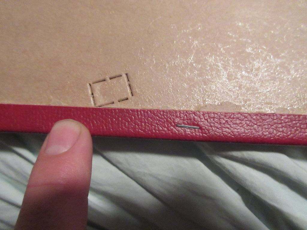

No kidding...at that price all I should have to do is to insert the clips...anything to save a penny...I wasted a fair amount of time prepping for the clips and mocking up because not all clips recesses were stamped out....
Plus, one of the staples was place in the way for the clip to slide all the way in.....That good QC there...Of course when I ordered it I had to wait 3 months for it.....
Pics below are of the old panel and new panel...The old one used bigger staples and the recesses for the clips were pre cut. The new ones you have to go around with a razor blade and pop out a portion of it and you have to be careful not to go too far...Thats crap...and time consuming..
View attachment 495558 View attachment 495560

Looks like they don't cut holes to come out. Wonder how factory did holes and cut out for clips. Does it look cut or stamped flat for clip recess?

Factory panels had the recesses as the old panel I had pre cut. The new panel they are stamped. If you look closely you can see tiny tabs. So you have to take a razor blade and cut those. Once cut, I used the razor blade as a pry bar and pop out a portion. Keep in mind not all pop out at the same depth so you have to slowly pop more out in order to get proper clip placement. If you do not you will dimple the cardboard and hence it will be noticeable on the panel.
Plus on the front door panel I had to create two openings for clips that were not even stamped. If I did not do that it would have had a large gap.

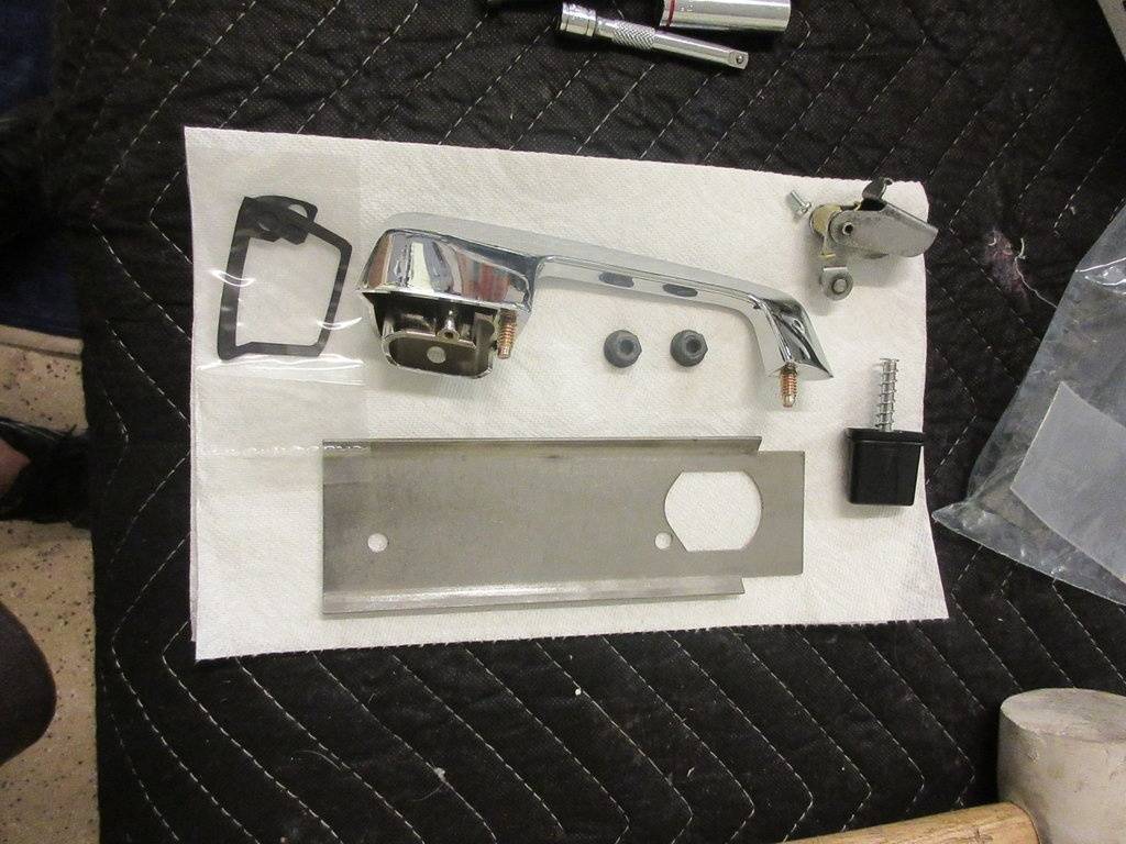

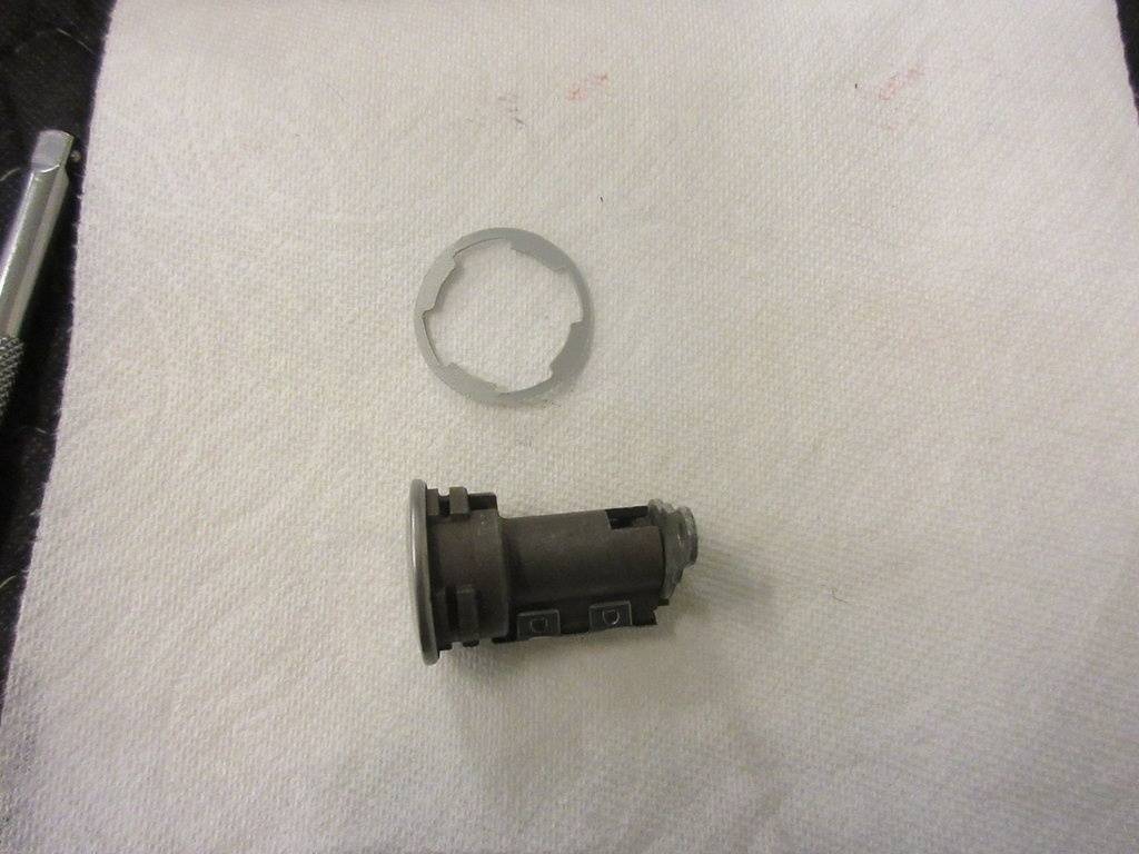

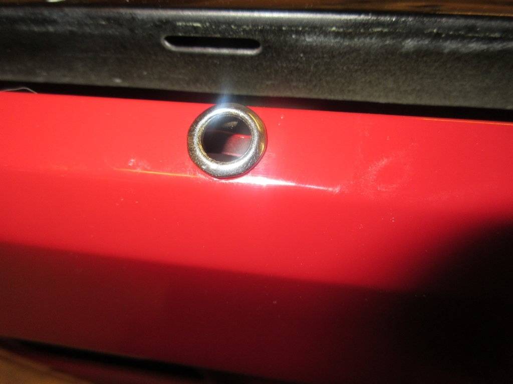

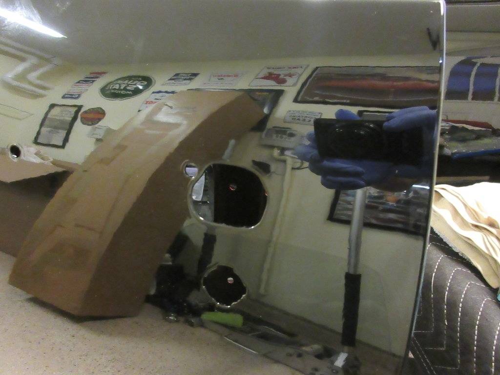

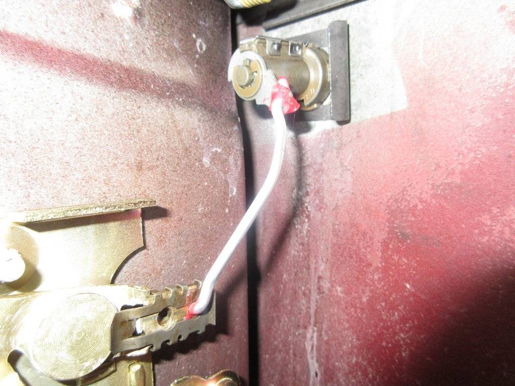

Starting on the drivers door.....Can I say again I hate doing door glass and mechanisms, lol

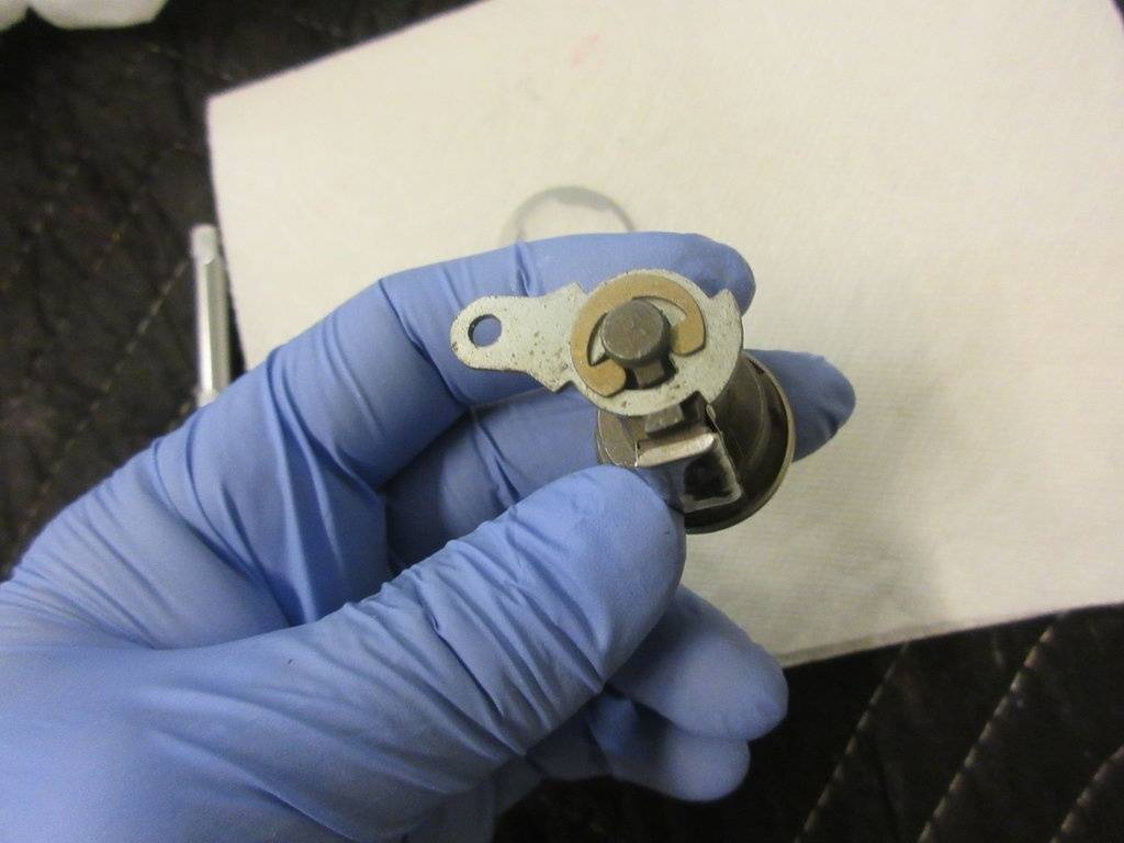

Filed out the holes/openings to accept the door handle and lock cylinder...Remember the cylinders go in one way only....Also reuse your old door handle mechanism the props do not work well....

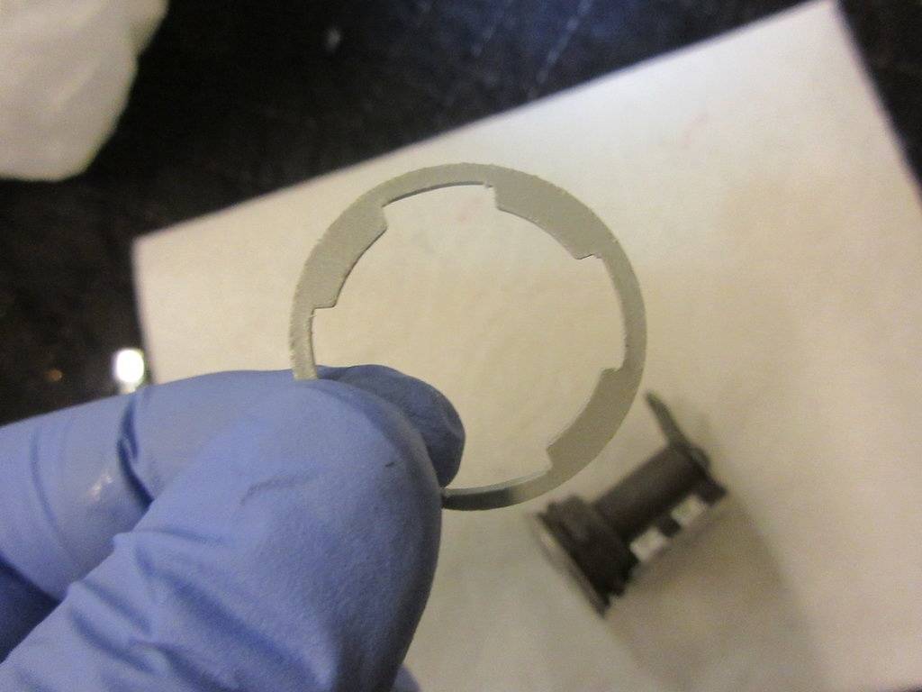

Look...The Grey lock cylinder gasket....
Wow that picture just goes to show what a great paint job you have, I thought it was a mirror til I saw the handle openings!
Tim, no kidding...I almost deleted it till I saw the openings as well....believe it or not the car has orange peel all over to.mimic the factory look....
Thanks for the compliment....The bodywork and paint is stellar where I had it done.....

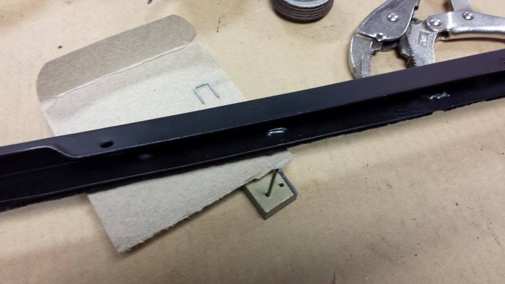

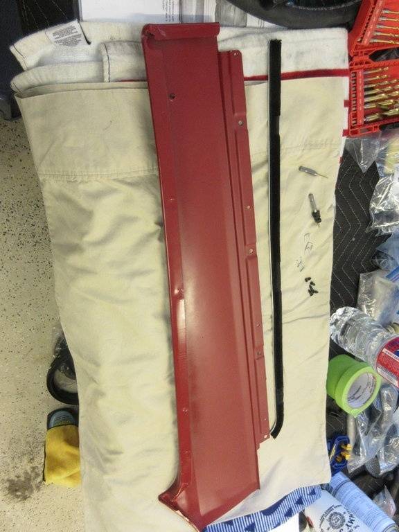

Passenger upper door pad. Installing the fuzzies. The originals used staples which these came with but when I asked the company how to staple them? The tech guy said, "I do not know?" lol I asked so you sell them like this but do not offer a tool or advice how? WTF
So I did them as I have done and that is to use small screws...
View attachment 495454 View attachment 495455 View attachment 495456 View attachment 495457 View attachment 495458 View attachment 495459
"Vise grips".
Or maybe some cases, "Vise gripes".
http://www.forbbodiesonly.com/moparforum/threads/66-67-charger-quarter-window-trim-fasteners.127721/
True...but yours is a little different than 69's....I am dealing with a full painted panel and at the cost of the body shop work my nerves could handle screws better than staples....
If only they were like the one you have above for the earlier B bods....
Your method is the best method to install them btw....I was hoping in 2017 the company had a better option but....they did not

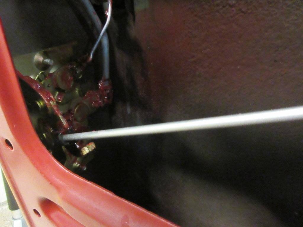

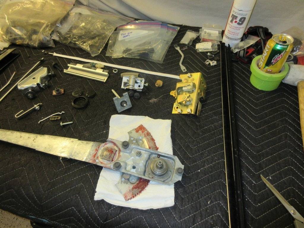

Working on the driver side door.....When I assemble the parts I test and retest the functionality of those as I progress and for good reason(key function, door handle function etc) . My driver side window regulator was working fine when I cleaned it up a year ago but once installed it did not function well an is unusable. So I will get another one soon of course and install later but that will not hold up the glass install. Better to find out now than later down the road....
I recommend long sleeves or split rubber hose around the sharp edges of the door to protect your arms when reaching through to install those itty bitty parts.
