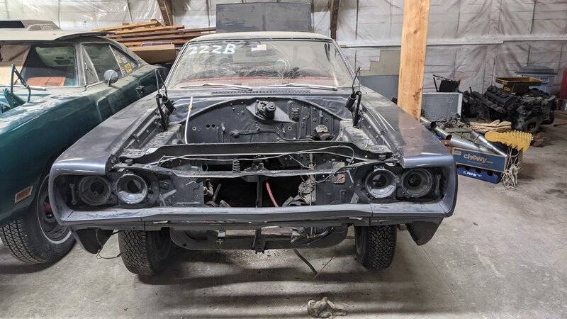

Stripped down before getting into the body shop
