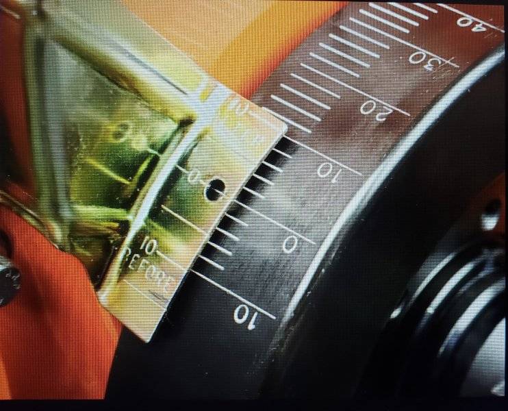

driving the distributor and oil pump. A 440 turns clockwise facing the front of the engine, right? Look at the helical gears
and tell me which way it thrusts the cam.
Since the oil pump drive/distributor drive turns COUNTERclockwise, it sure looks like if anything, it pulls the cam forward.
