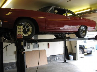

Four post lift installed today
One note: I have the same type of lift but bolted mine down to the floor. I know that you don't have to do this but I was worried that if for some reason the bottom car bumped into a post the whole thing could topple. I might just be paranoid though.
I wanted it bolted down but the salesman at Greg Smith talked me out of it and the installer did likewise.I'll just have to be careful when pulling in.
I have two of them and they also claim they don't need to be bolted to the floor. For me, they are currently in a temporary position, and with radiant heat, I didn't want to drill into my new floor. I chose them because they were sold as not needing to be bolted down. Unloaded, I didn't like how they wiggled. What I did was secure the top to the walls with 1 5/8" strut. Personally I'm not sure I'd really wrench on the car for fear of the lift falling over. Most likely you'll be fine, I tend to be a little paranoid.
They did warn me that the lift would creep a little every time you ran a car up the ramps. Keep that in mind, if it bothers you, maybe mark the floor to keep track.

The bolt-down issue was a little unnerving at first, but now it doesn't bother me at all. Just like you guys, Greg Smith said it would be fine....so far they are right. Going on 5 years.
I've been on and off a dozen times now and it hasn't moved at all, I traced the outline of the post on the garage floor.
Congrats !!!!! After owning lifts,would'nt want to be without them now !!!!!! A little tidbit,after you've run that up and down with a car on it a dozen times or so,recheck the cables as the longer ones will stretch,I mean,when you start to lift the car up,make sure it picks up dead evenly at one time.Mine started picking up on the shorter ones first,then the longer two were kicking in.Thats to much strain on just to cables to start.Once I adjusted them,never had to do it again ,yet !!

Been waiting for this day for a long time,finally had my four post lift installed today.Two guys delivered and installed it in under four hours.
Nice lift, wish my celling was high enough to install one.
how tall is your garage red 69?
10'6".I got 4 1/2" to the ceiling and thats enough to release the locks to lower it and I got 62" to the bottom of the runways so another B Body will fit underneath,Just have to find a good deal.
I figured that 10'3" was about the minimum to get two stock B-bodies to fit.
