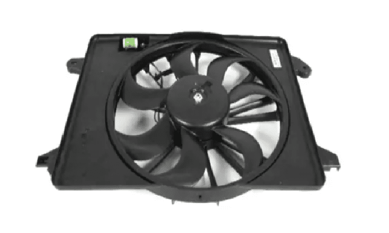

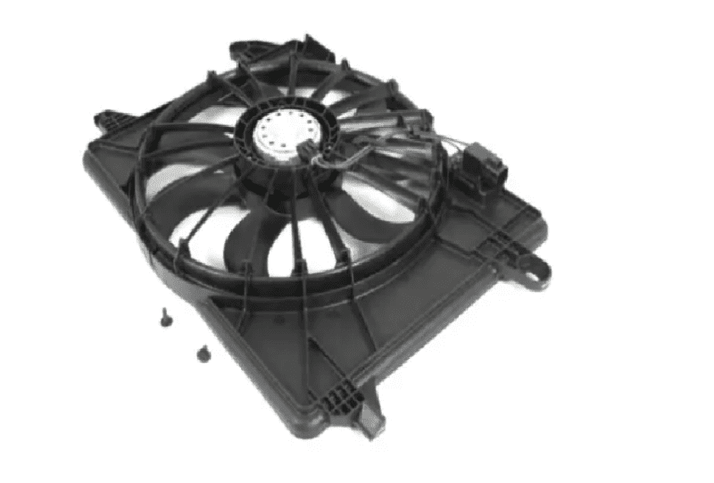

Oh dear....upon further review, it does appear there's some manner of sensor in the fan shroud itself.
APOLOGIES to anyone who suggested this might be the issue....
See that little green jobber there? That's it, on the back side of where the wiring harness plugs into
the fan shroud.
Further....it appears it's not available separately from Mopar or anyone else - gotta buy the whole damn
fan/shroud assembly to get it.
Ma is looking like an asshole here on this one...:mad:

I have a feeling the one I posted ,is the same unit you require. Should be a generic piece across the product line.
