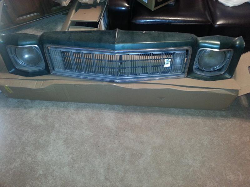

Here is my progress. I need advice if removing the headlights will help me install the stud nuts...? Its just sitting there. The buckets are integrated into the plymouth header...so I think the studs are Damn near inaccessible? The monaco buckets come out..so I could get at them.
For anyone that comes across this is the future. The header is fully installed. The mounting studs are accessible from the inside of the fenders, through the engine bay.

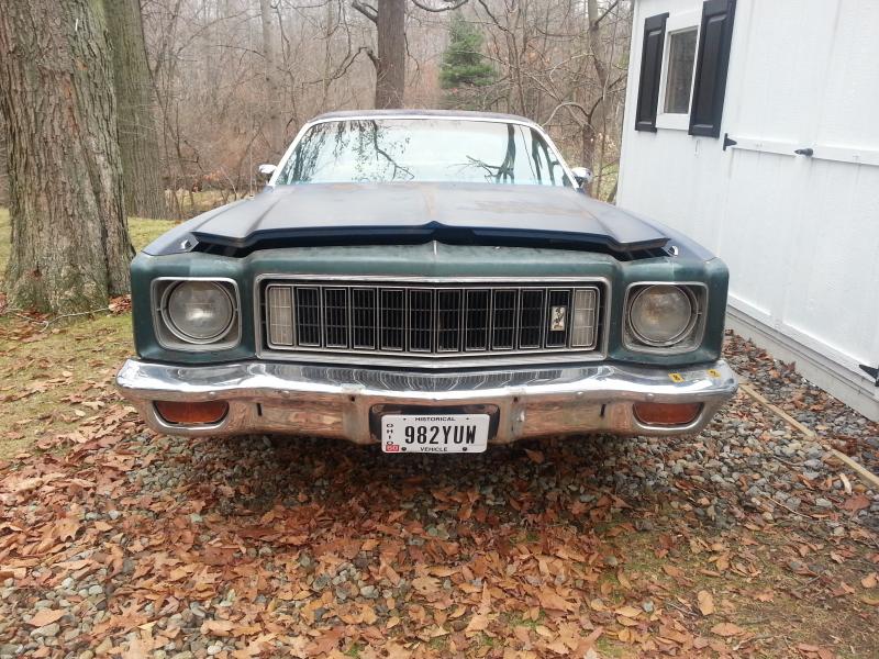

Need help converting the 2 headlight plugs into a single h4, so the high and low beams work. I currently plugged in the three terminal h4 plug onto my single beam lights, and the low beams work. The two terminal plug is currently not plugged in, and when I click the highs on, the lights go out. im assuming I need to take the wires from the 2 prong plug and splice them onto the three prong plug...but trying to get some direction before frying something.
