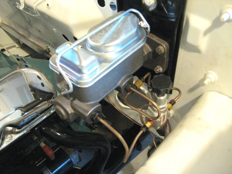

Might not be much help, though I went through alot of crap on my 64 Ply brakes. (It wound up so simple, I could not believe it.)
I admit, on mine, I already knew I wanted to convert my brakes to manual disc/drum. Just had to get the correct parts and pieces, to make the system right. I screwed up, trying a 'rebuilt' MC, that was assembled wrong, and had trash in it.
Had replaced every brake line/part, except the rear axle 'Y' fitting. New brake hoses all around.
Either from the MC, or otherwise, and several attempts to bleed all the brakes, could not get good fluid to the rear brakes. Stopped! Stripped most of the parts, and re-checked everything.

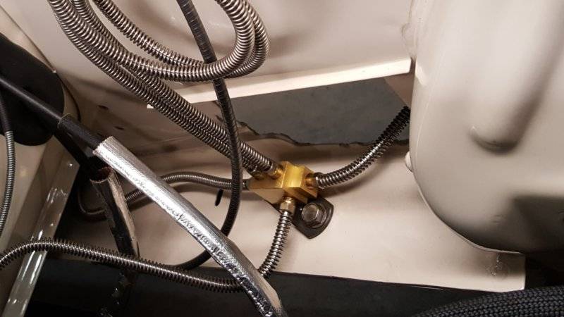

Then, I 'finally' found it. A piece of trash in the 'Y' fitting, a little out of the new hose, was blocking my system. Put a new MC on, cleaned the system, and away we go.
64 drum brakes were already known to be on the poor side anyway. Good luck on it!
