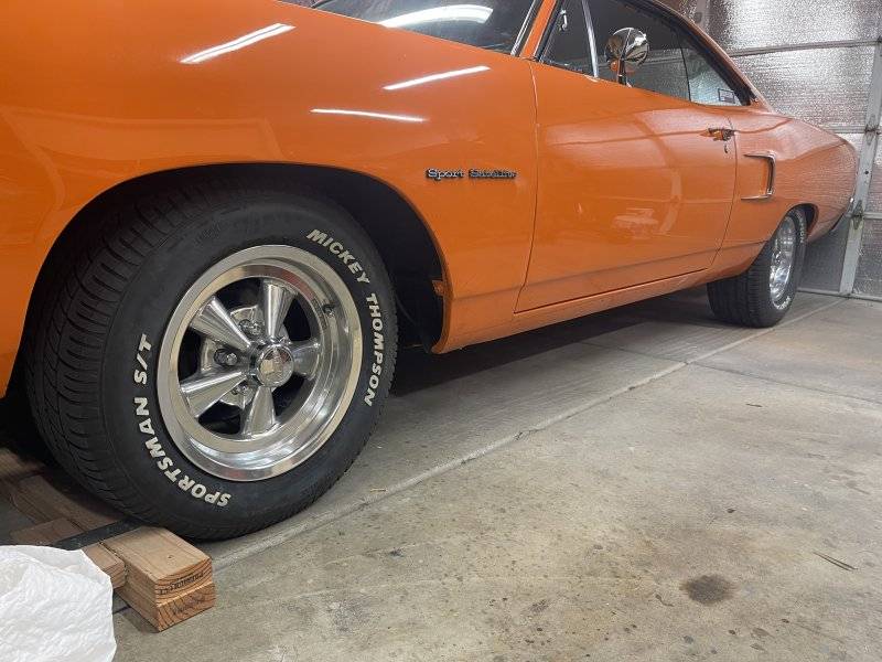

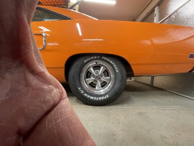

So I have a few questions and Ill just bang em out right now.
Front wheels are squealing over 20mph driving straight. Car does not pull but IS A BIT TWITCHY. I am not to familiar with bbodies drivability because all I have been doing for the last year is work on it lol.
Bbody with a small block. Original suspension but using gas shocks not hydraulic. Also front tire size is 235x60x15
Rears 275x60x15
Q1. I assume it needs an alignment but my question is does a squealing tire indicate more a toe in is off as compared to camber or caster?
Q2. I assume if it’s over twitchy that an alignment would help. If not what should I be looking at?
Q3. Do you guys to your own alignments or does it really require a rack with lasers and computers? Like they had that in 1970 lol.

Generally yes To all. I do my own with a gauge on the spindle. Just because a shop has a modern machine doesn't mean they have a person that can use it to success on an old car. Better not drive it much with those new tires or they could be worn wrong in no time.
A helper and a tape measure can measure toe. Adjust as needed. Camber you can look at and get close. Caster is not a tire wearing angle.

Your description sounds like a toe problem. Caster/camber has to be really bad for tires to squeal.
Moving the cams for caster/camber affects toe. Toe doesn't affect caster/camber.
You Tube is your friend. Many videos on the subject. Tape measure and bubble gauge works just fine.
In a pinch a 6'' level works too. And don't be too concerned being dead on with specs, you may have to compromise .
