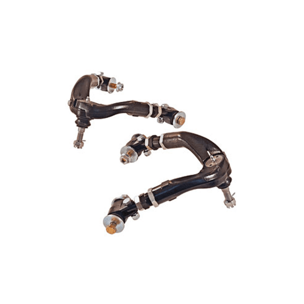

I like & have used Capps Automotive/MoPar Performance,
from Mancini (were made for MP)
& the later QA1 tubular stuff
(QA1 is who bought out Capps, still use their designs it appears)
on several different builds
Suspension Mopar Performance {Capps Automotive} Mopar B-body Adjustable UCA's.jpg

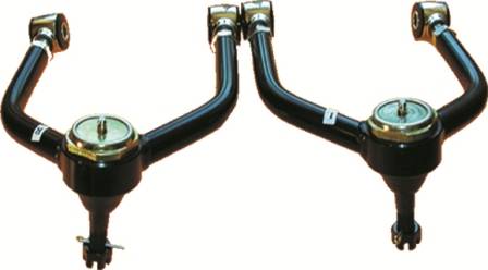

I've used SPC UCAs double adjustable on the car,
come with HD high angle upper ball-joints installed
way more range of travel 5"+ to the bump-stop, free travel,
with lil' to no binding, than any of the OE stuff
going to use them again

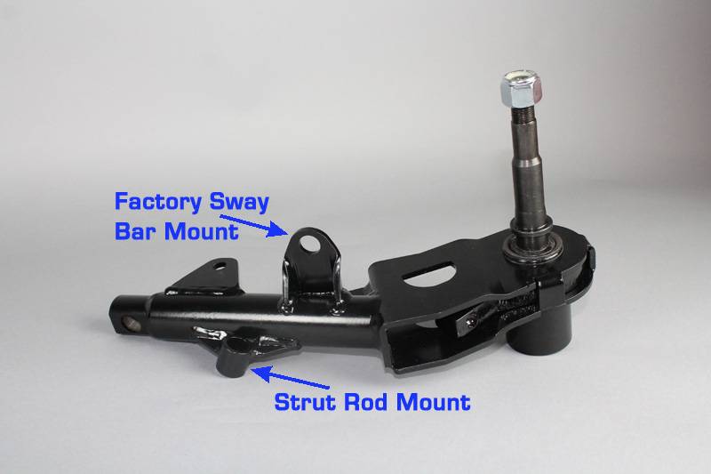

QA1 LCAs with the sway-bar tabs for street driving, car handles' great
I remove swaybar links for drag days

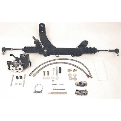

I also have used a power steering, Unisteer bolt-in Rack & Pinion
albeit pricey, I like the feedback & feel
it handles like a dream, albeit pricey & needed to correct some bump steer

I know the bolt-in Unisteer Power Rack
rear steer, reverse rotation, like OE, behind the centerline of the spindle)
is was way lighter than all the OE stuff
Power steering box, heavy cast iron, drag link, tierods/sleaves,
the pitman arm, Heavy OE PS box, OE pump brackets/hoses,
steel pulleys etc.
It's not a necessity, but I like it, for my purposes...
But for dedicated real racecars for 'drag racing use only'
I think I'd go to a front-mounted & front steer Rack
(It's opposite rotation in the box, needs a longer steering shaft & swivels)
with lower ball joints/arms facing forward, custom rack,
probably manual
maybe even an adjustable strut front end, over the std coil-overs
it's way lighter or than any stock geometry or OE stuff
Have used (old Capps Automotive from Mancini)
now QA1 dynamic adj. alum. struts, that really frees up the front end

You know I bought ALL QA1 front suspension parts, K-member too, but just like you, I chose the (old) SPC UCAs, because they offer tremendous adjustment and I heard from experienced, talented, friendly (guys I've known for decades or done business with) "Your UCAs don't have enough adjustment in them for me to get the suspension geometry perfect" referring to my factory stock setup, well-I knew I'd never hear that **** again with the SPC UCAs...
I say (old) design because Bergman offers, or used to, those same UCAs with his own touch added, but he also has the new design (they "look" stronger), but just like the Hotchkiss UCAs (the only other ones I considered), they are over DOUBLE the cost, and I'm not sure that's worth the price difference.
"old" SPC UCAs you and I have:
"new" and over DOUBLE the cost SPC UCAs:

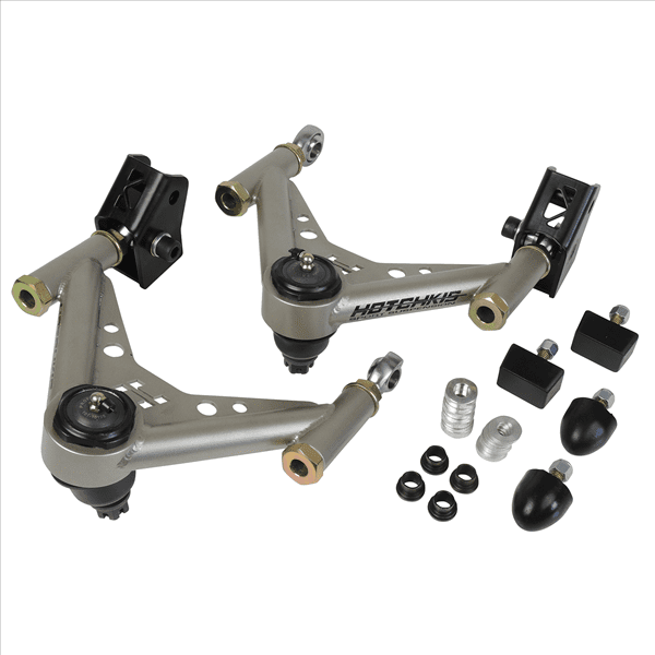

...and the Hotchkiss UCAs, which is the only other UCA I have ever considered:

I almost bought the Hotchkis too
too long out too, & wait, sort of way-overpriced (but are really nice)
& I knew the SPC worked, worked very well...
I still haven't put the sets, I have on my current car
I loved them on my Silver car & the Black car too
I was just 'maybe' going in a different direction, with this car (?)
I still haven't made my mind up :BangHead:
not for lack of 'the performance, or strength/design', at all...
I was just 'maybe' going in a different direction...
