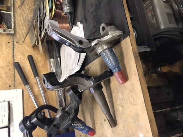

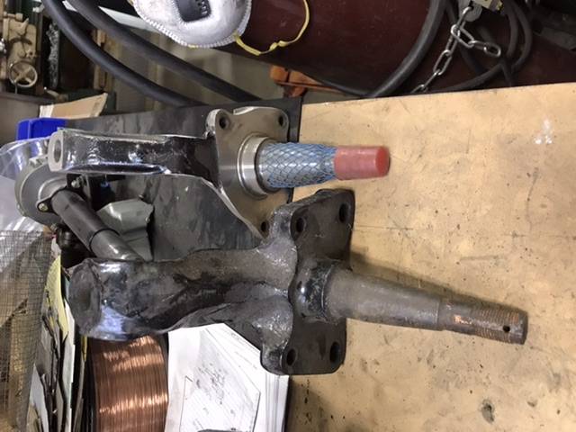

Different strokes for different folks for sure, and I’m not trying to change your mind but here’s a side by side of both spindles. B-body is all black, M2 is the other. I cut the steering arm off, but as you can see, It’s plenty beefy. The difference is, the mass is placed where it’s needed and isn’t where it’s not. The bearing diameter is even larger.
Oh yeah I know those spindles are huge. The guy that painted my car is huge ford guy and I’d say he does at least 10 of those swaps a year in the older Ford cars and trucks. My factory disc spindles is probably the smaller of the bunch. It never crossed my mine one time to change them for some bigger ones. Never heard of any problems with them.
