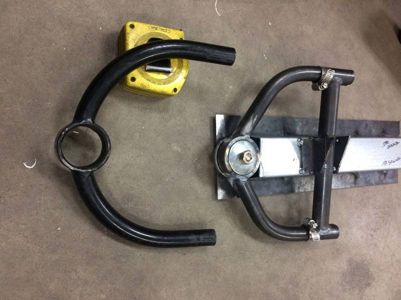

Interesting. I made my own uppers with spherical rod ends. They still require removal for adjustments if the cam bolts alone can’t get it done. I’ll be building a new set for more front suspension travel.
Yeah, I think the SPC UCAs will always have enough adjustment leeway as installed, by just backing off the lock nuts and twisting the fat section marked "SPC"
I’d like to see the ones you made. As mentioned before I did not like the look of the SPC because of the small adjusting bolts so I sent them back. I looked at the Hotchkis and they also have small adjusters on them. They may be good for racing and staying on nice blacktop roads but here in Kentucky we have potholes that would swallow a car. I hit a pothole one time so hard in my Charger that it broke/ripped the metal that holds the camber adjusting washers about half way out, the one on the outside inner fender by the shocks. It Immediately started pulling hard to the left. I could just imagine hitting one that hard and it easily braking one of those adjusting bolts. The non adjusting Qa1 are ALOT stronger built because they don’t have those weak points and they have 3* of caster built in them.
In the fixture prior to tapping the tubes for rod ends.

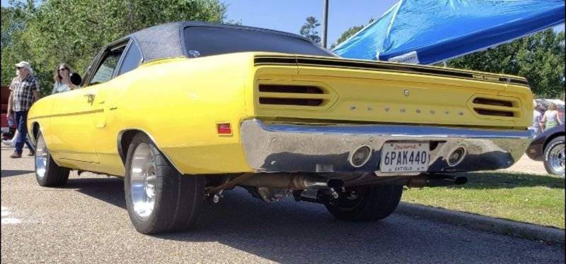

Those are huge! I’m running 285 and my car just blows the tires plum off of it. I didnt dyno it. FASTMAN said he guessed it between 580 and 620 hp with my first tune. It’s a 440 I built back when the TF 240 first came out. I actually bought one of the first sets came out. When I’m done with this motor I would like to build around a 500+ stroker with an aftermarket block and still run my T-56 Magnum and do the AMD wheel wells with 330,s out the back.

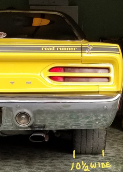

Yes, the rear tires in those pix are very W-I-D-E and MAN! do I like that look, ESPECIALLY on the "Coke bottle" shaped B-Body cars. I have posted (as kindly as I can) that wide tires (no need to be that wide) are mandatory for the 71 and newer Roadrunner/Satellite cars, and although the bumpers on the 71 and newer early 70s Dodge Chargers aren't as obnoxiously huge as the Roadrunners of the same era, they "need" wider than stock tires too, to offset the ENORMOUSLY wide "hips" on those cars.
The 68-70 Roadrunner, 66-70 Coronet, R/T and Bee, wide tires compliment the wide rear quarters and back decks.
Look, I am beside myself with joy that I am able to have 315/35/17 Toyo Proxes TQ drag radials on the widest Rallye wheels available (9" Year One) and that's with ZERO body or suspension mods. NO RUBBING and with the 5" backspace that the 9s come with, the tires are perfectly centered in the rear wheel opening.
I think they look AMAZING,
BUT
IF there's NO chance even the WIDEST DOT legal tires will be able to offer any kind of traction once my 6XXHP/700TQ 572 goes in, and it may turn out that even having steamroller wide DOT legal tires is a fruitless venture for traction. IF it becomes obvious that ONLY a drag slick can offer any significant traction with the 572, then I may have the rear wheel opening and whatever else made to accommodate the slicks, but then again, I think it would be difficult to resist putting really wide tires on my car.
I guess there's too many variables to say.
Nitto has my tires 285/40r17 listed as 11.42 inches wide and their 315/35 listed as 12.60. I’m also running a 9” rim with 5” backspacing and I have room for a bigger tire. I’m going to take a measurement today to see if they are actually that wide.
