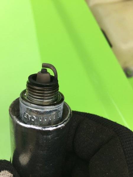

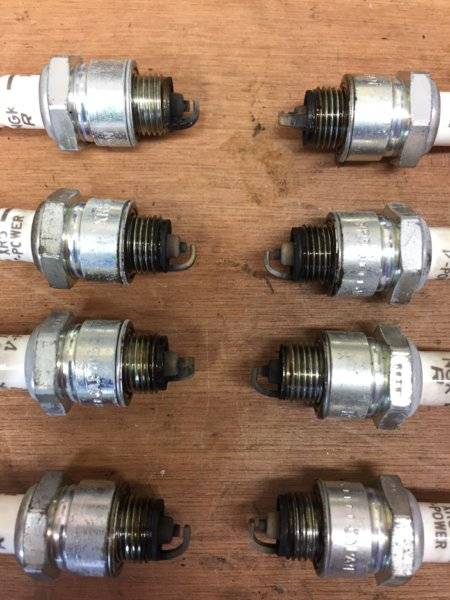

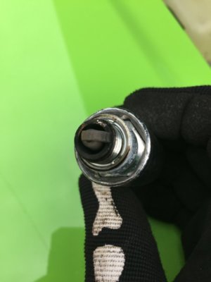

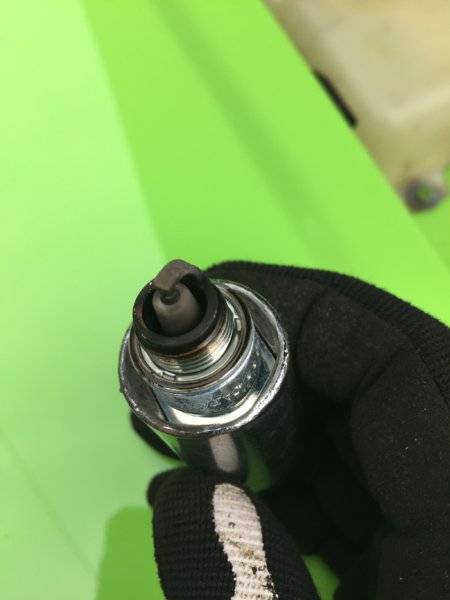

I went for a drive around town, when i came back i pulled all the spark plugs, which IMO look ok.
Not wet and fouled with carbon build up, heat range looks ok as well i guess.
All gaps were double checked and were at 0.035".

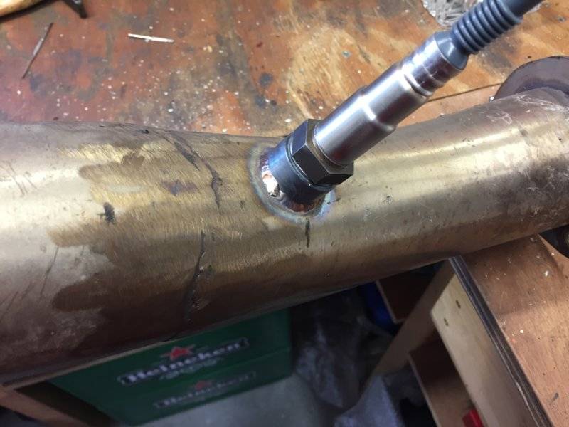

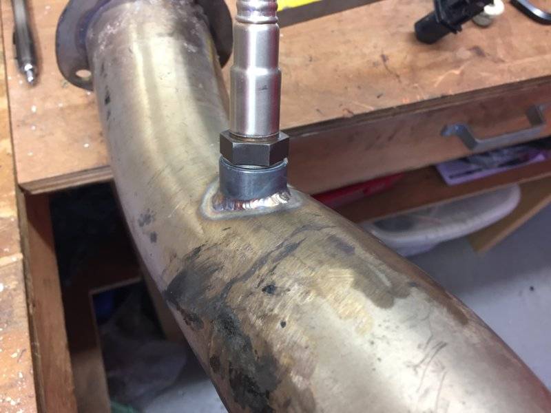

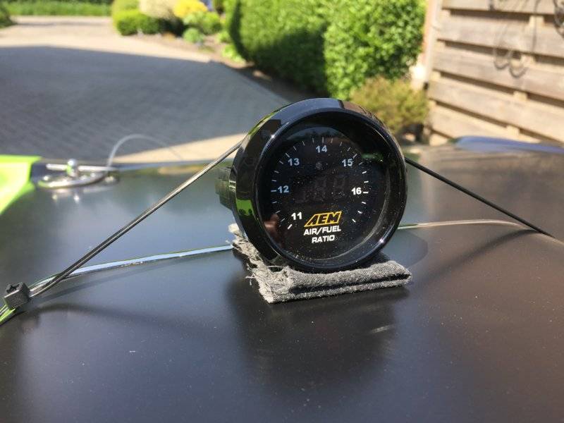

I did manage to get the AEM A/F sensor installed this morning.
I made it such to be a temporary setup to do the needed adjustments/troubleshooting, if not required i can remove it from the car and put a blank plug in the exhaust nipple.
Run the wiring through the hood scoop and secured with a strap :) very good visibility during driving==> safety awareness) :)
Noted the readings at idle, different speeds and near WOT situations.
I wrote down the average readings during constant speed.
Idle: 13.2 ("cold") / 12.8 after a drive with engine at operating temperature.
20 Mph: 12.0
30 Mph: 11.5
40 Mph: 11
50 Mph: 10.5
Several hard launches, mid sprints 30 ==>60 Mph i have not seen it go any higher then 13.5 (maybe 12.5 -13.0 average)
When speeding up normal it shows between 10.5 and 11.5 on average.
I think it could be leaned out slightly, or leave it as is?
20 Mph: 12.0
30 Mph: 11.5
40 Mph: 11
50 Mph: 10.5

This article might be helpful: http://www.hotrod.com/articles/innovate-air-fuel-ratio-meter/
Good info on that article.
As they mention, 12.8 - 13.2 is the ideal mixture for power.
Mine is near enough in that range, and i think this minor changes are not possible to be made by changing jets.
More likely this is stuff to change with air bleeds....which are out of my work scope :)
It feels good to know it's running good, i always worry after setting things up it leans out and i burn a piston or so.
To change anything on the fuel consumption will screw things up, which was not the plan in the first place.
Very happy to get a lot more sight and knowledge about these things to know what you are actually doing! :)

AFR acceptable or should i try a smaller size jet in the primary? (#78 ==> #75)
I went ahead and changed the primary jets to the #75.
During driving noticed at different speeds the AFR values are slightly higher, say i gained 0.5 at lower speeds and up to 1.0 at 50-60 Mph.
At harder launches and heavy speed increases on the primary's only it still ends up at 13.2 - 13.3, although i did see several times it peaks to over 14 but is not maintaining. (probably a lean moment at or after the pump shot)

I installed an AEM gauge several years ago. I chased the magical 14.5 number for quite awhile, thinking that was the right number for clean running and decent performance.
Maybe I am chasing a ghost. I have a 440/493 with 10 to 1 compression, Edelbrock heads and RPM intake, 2" headers, the MP 528 Solid cam with 1.6 rocker arms. The carburetor is a Demon 850 vacuum secondary. I have #83 primary jets and #92 secondaries. I have found that by adjusting my idle mixture screws to 1 turn out or less, it will idle in gear in the 14 to 14.9 range, cruising down the road at 13.5 give or take. It does hesitate off of idle and the gauge shows it goes off of the charts LEAN, 18.0+. Once past that stumble, it runs okay but is a little down on power. If I adjust the idle mixture screws to more than 1 turn out, say 1 1/4, the idle numbers go below 14. I took advice from others that the 14.5 number is the target for idle and cruise but I'm catching on that my car seems to run stronger with a richer mixture.
