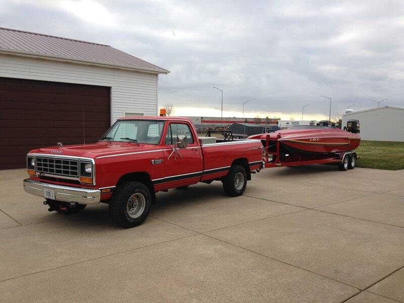

I know it's not apples to apples, but I have a really nice '84 W150 w/ a 318, it had a 2 barrel and ran so nice and smooth you would of swore it had efi.
Anyway, I put eddy 4bbl intake and 600 Holley on it, just so it had "some more suds" and fuel mileage actually increased.
