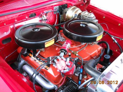

Benno,
Carter mechanical pump, 3/8" lines and dual Edelbrock carburetors. Motor pulls to 6800 rpm. No return line to tank, no tricks. Sometimes I think we over-engineer our rides...

Benno,
I agree 100 percent.Had the same setup on a 64 Belvedere a couple years back and it worked flawless
Those Carters are damned good pumps. They suck. In a good way. lol
