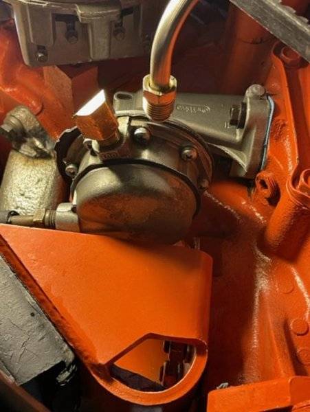

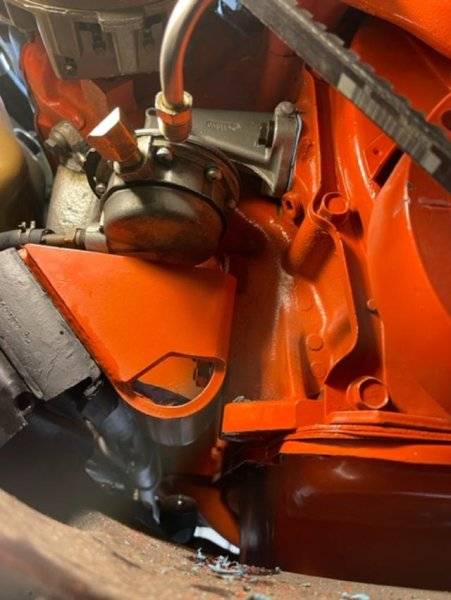

I installed the fuel pump yesterday and had two issues: First the outlet port did not line up with fuel line to the carbs, see photos. But I cranked the engine anyway to see if I had fuel from the tank and I did. When I removed the fuel pump, fuel came out of the lower bowl on the inlet side and the hose from the gas tank, so I figured it is good and at least bringing the fuel up from the tank. I take apart and re-position the lower bowl to line up with my fuel line to the carbs. I also changed my 3/8" brass fitting to aim straight to the carb fuel line. I put back on the car and connect the fuel line to the carbs and I still have no fuel to the carbs? I will go back at it today but I am wondering if the push rod is worn and not giving the arm enough of a push to generate the right amount of pressure. Your thoughts?

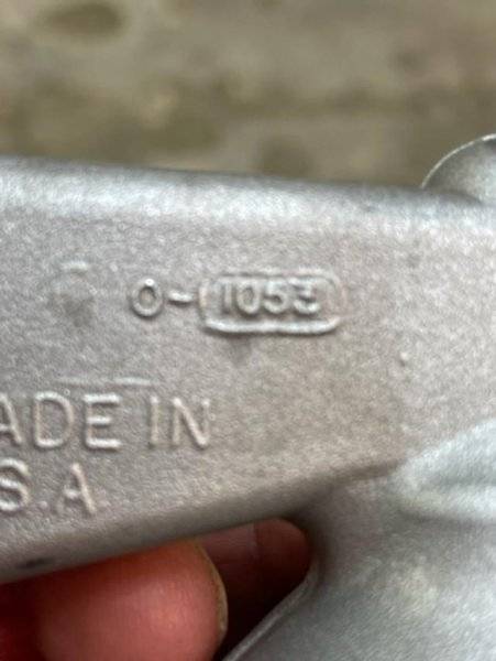

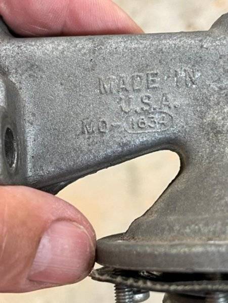

P.S. The reason I changed the brass fitting is I had a new rebuilt fuel pump but it had the 1/4" NPT fitting and I need the 3/8" NPT fitting, so I disassembled both fuel pumps and used the bottom bowl with the 3/8" NPT and fitted to the rebuilt top half so I would have the new diaphram/spring. The numbers on my original fuel pump are MO-1634. The pump arm I replaced it with was O-1053. I am not sure on the spring load and need to check it out today.
