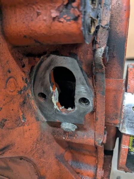

I am almost positive this is the correct plug, 3/8NPT, but it's only screwing in about two or three threads? It's a 1968 440. Is this common?
Thanks
The plug is new, I may have a tap for that but female pipe tap is something to be careful with probably.. maybe I can look for a tap and chase it a little?
Someone has grit all over that area. Clean the threads. You can use brake cleaner and a toothbrush.
Clean the threads up in the block with a tap. Don't try and get the threads deeper. The plug doesn't have to sit flush. It's just there to plug the hole. You can use Teflon tape or paste; either is good.
