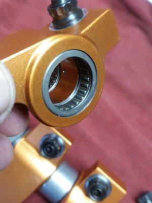

(Ok I'm sure that's just a typo!?) I've used Harland-Sharp before and they were excellent but can be very pricey. I can say this, you are wise to avoid the need-bearing styles. Try to use bushed rockers. I don't believe Crane makes the full-roller style for B/RB anymore (I could be wrong on that)..Comp's are good too.

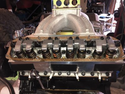

just picked up the Harland Sharp for the part #s are different for the Trick Flow heads, they are super nice!
probably a little over kill for an engine thats not going to the races much, but i wanted some nice stuff...not disappointed
I'm running Indy (not sure who makes them) rockers on my 493 RB. Knock on wood, haven't had any issues so far. I went with the bushed rocker to avoid the oiling problems I encountered years ago with the full roller. I assume they have corrected this problem with improved technologies.

Great article, as all of yours are. One question I’ve always wanted an answer to is the use of needle type roller bearings on a rocker arm. They may lower friction but at the expense of lowering oil pressure through the extra bleed off area and reduce longevity by reducing the contact area since most of the load is supported by just a few needles. Have you ever done back to back testing on bushed vs bearing rockers to see if there really are any horse power differences?

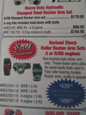

I noticed in the new Mancini Racing flyer they have a Harland Sharp (MRE57001-15)1.5 bushed roller rocker listed. After some research, I discovered these have the same warranty, built by HS, in the USA, using same materials and process as other HS rockers. Only difference is they're bushed instead of bearings. I'm not trying to "cheap out". But at almost half the price, these may be the ticket. Anyone have real world experience with these?
I've used the Mancini rockers and have had no problem. However, they are not bushed, the aluminum body runs directly on the rocker shaft.
Mancini and Harland Sharp claim the 57001-15 rockers are bushed. Guess I'd better do more research.
