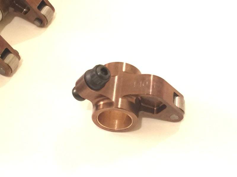

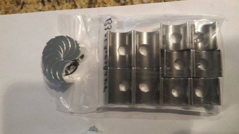

I have some of their SS bushed ones going in my engine & they are fantastic.
I've used the Mancini rockers and have had no problem. However, they are not bushed, the aluminum body runs directly on the rocker shaft.

There is supposed to be an oil wedge between the aluminum and the rocker shaft. I've heard of people running the old Crane Gold Race aluminum rockers for 100,000 miles. And they are not as heavy duty as the Mancini rockers. Hughes Engines make a good aluminum rocker that runs directly on the steel shaft also.
That is the only thing I could think of. I guess I should have put that in my post.
That and depending on the aluminum alloy, the hardness could vary?
Thanks IQ52!
1Q52, You're right as right. I just got off the phone with Randy@Harland Sharp. The 57001-15 is NOT a bushed rocker. However, it it constructed with an alloy designed for this application. Not sure why Mancini advertises it as being bushed.
He said these rockers are perfect for hot street/strip cars. As long as lift is less than .700" and below 575 lbs spring pressure. Same warranty as all H rockers.
