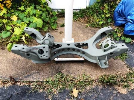

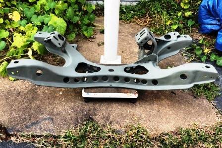

Hey Bob, I lightened my K frame also. All the holes I could reach were dimpled.
Went from 43 pounds down to 34 pounds. I took 3 pounds of dirt and gravel out of the K frame, the rest is hole saw.

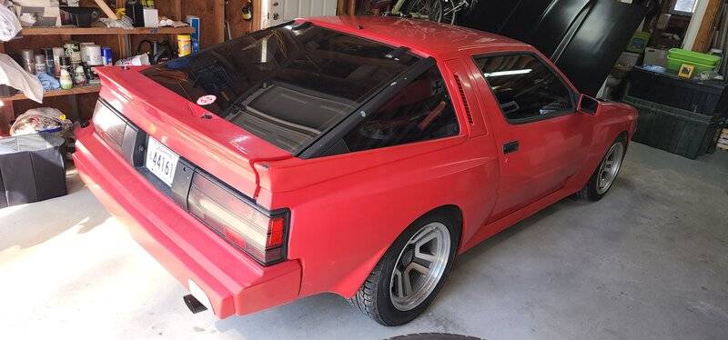

My buddy I visited today is THE or was the, BEST motorcycle rider I know. Back in the late 70s, early 80s, he would ride his Yamaha RD Daytona 400 2 stroke street bike down to the local New Orleans street race area, hoist it up on the rear wheel and ride that bad bitch all the way through the quarter mile. At the finish line he'd drop the front down and the speedometer read from the front wheel, that needle would jump to about 90 mph. I mention that because like many of us 60-ish guys who have all worked and/or played hard, and now we still may but it hurts, my friend lost his left leg below the knee from a bad motorcycle wreck, just too hot into a turn and a fence post in a bad spot. I'm proud of him for working on his cars, even though, like us and maybe worse, he gets through it.
Here's his latest project that just needs dyno tuning. A 2JZ powered Chrysler Conquest TSi. (He's the one who got me interested in them, and went to Ohio to get the 89 TSi I had and drove back) This is going to be a low to mid 500 HP blast to drive, yet reliable enough to be a daily driver.
He did ALL the work in his garage.
