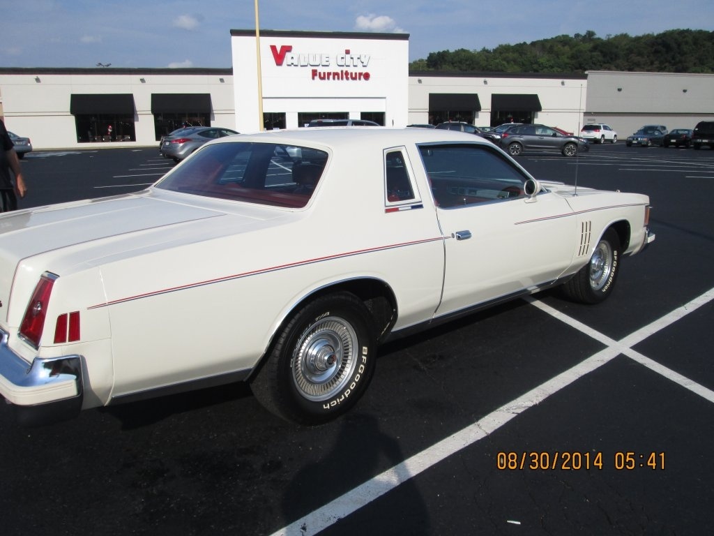

Does this look familiar?
A long time ago I started to collect pictures of 300's. I have info and pictures of a fair number of them. The lowest # vin I have is R149275 and the highest is R250725. There is a web site devoted to just the 79-300 but it has been largely been untouched for a long time. The Red 300 is in a private owners hands and the last time we spoke he planned on restoring it fully.

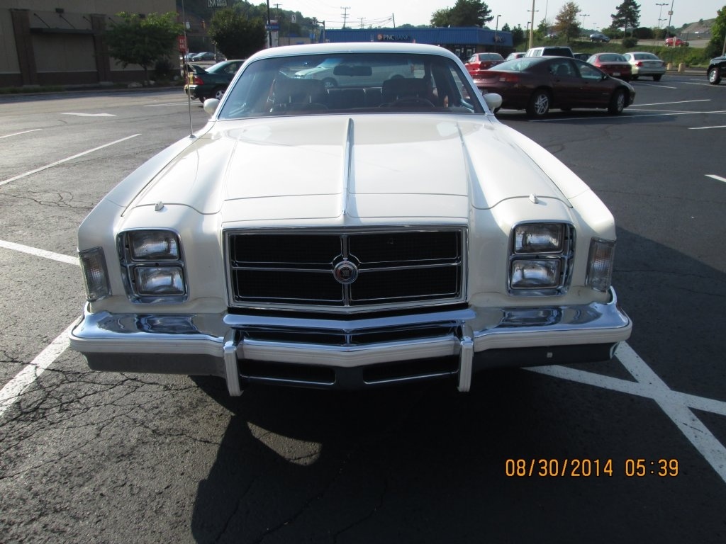

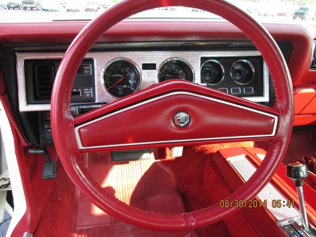

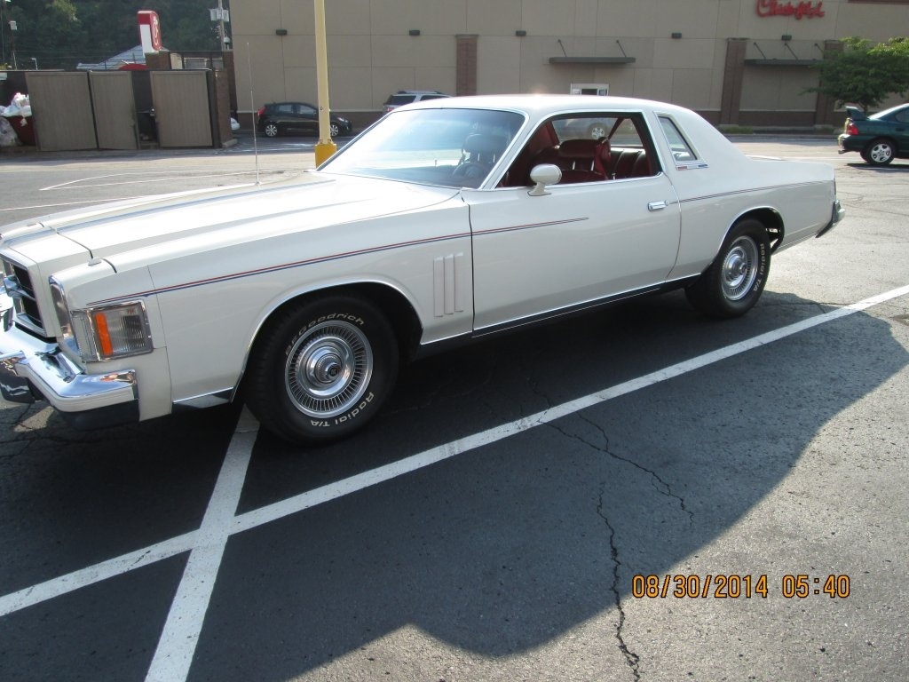

Sure does! By date on the pic, that was the guy I bought our from. He lives in the Detroit area. It just turned 25K miles this past summer. After I got it, I deleted the lean burn and lightly modified the 360. It's had a sheltered life and continues to do so. Thanks for the picture.

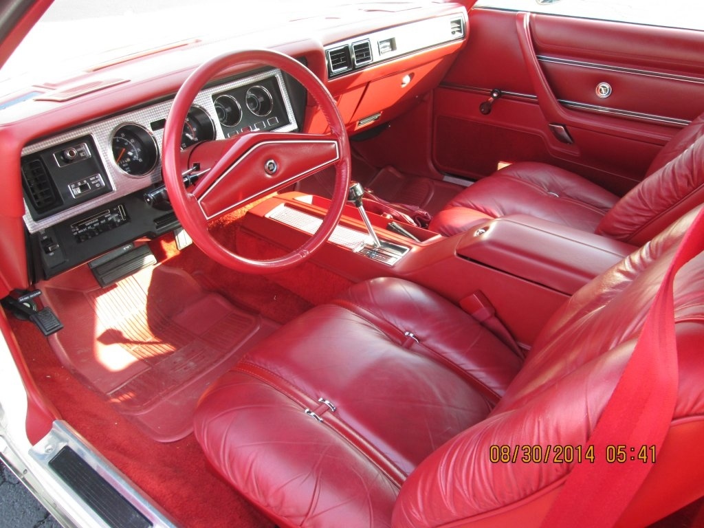

Very nice. Wow, only 25,000 miles!
Yours is the first that I have seen with manual crank windows. I see that you have the tilt steering wheel. Does yours have a rear window defogger/defroster?
Thanks for the kind words. Not sure if the crank windows are a plus or minus but I don't mind them. It does have the rear defroster and cruise control which work. The cruise has a bit of a mind of its own but it does work. The a/c does need the compressor rebuilt or replaced and a charge. Since deleting the lean burn it runs much better and is not as thirsty. With the help of a friend, we had the heads milled, compression is now 9.8 to 1, comp cam, eddy intake and 600 carb. Looks factory stock just runs better.

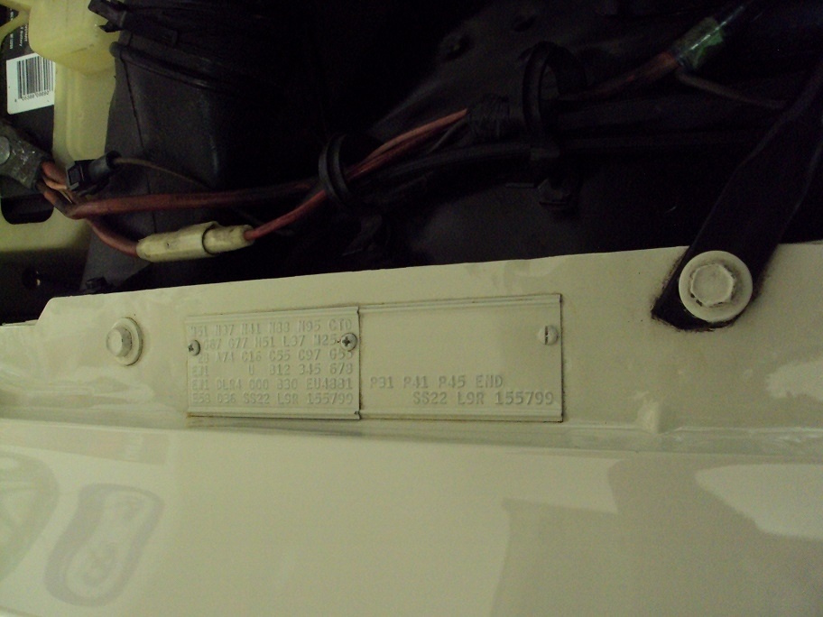

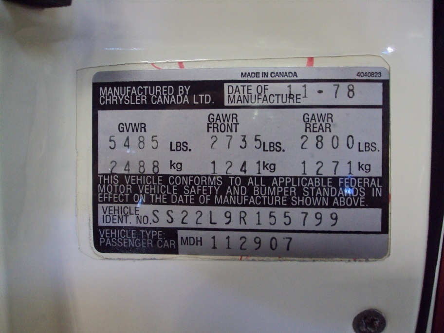

So, how many 300's are out there carrying a dual option plate? - black valve covers? three Catalytic convertors??
Mine has two option plates. My valve covers are blue and the premium 360 mylar decal on the driver's side valve cover is long gone. Mine came with two cats. The air cleaner housing is a single snorkel and it did not come with a pie pan on top of the air cleaner lid.

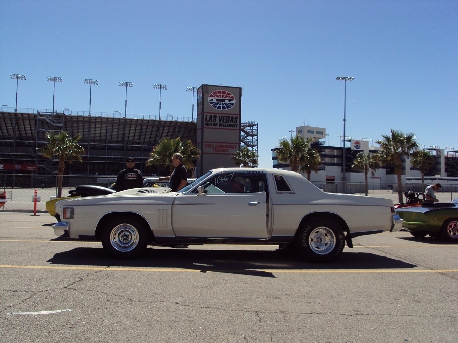

This....I want to know more about...and to see more pics at the track :)

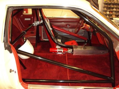

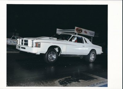

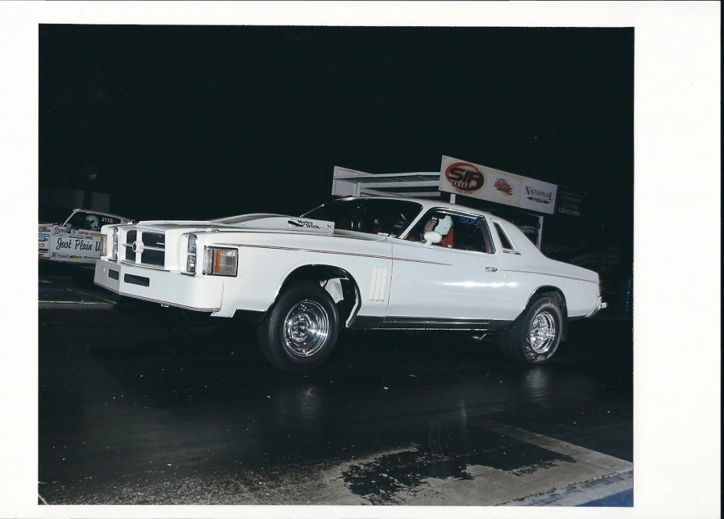

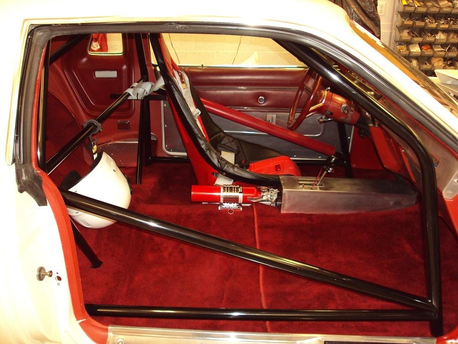

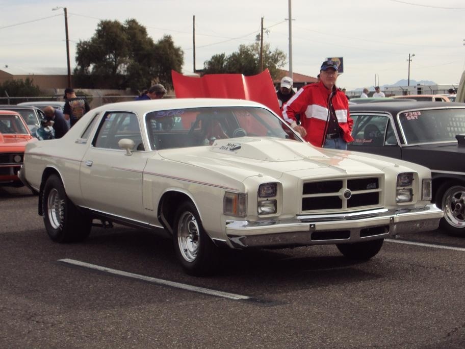

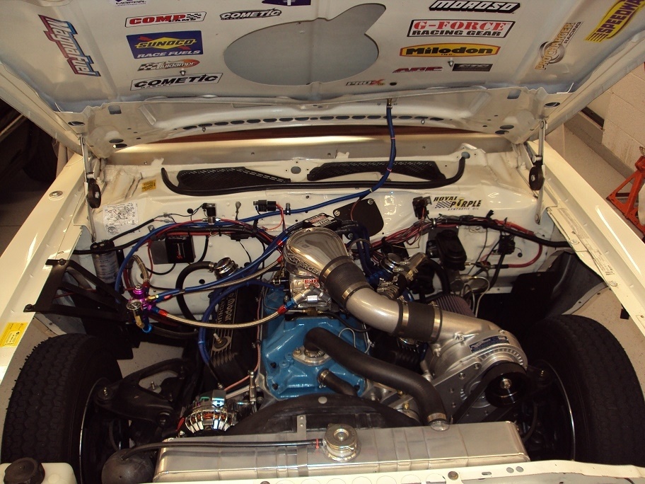

It is an original 79 300. Started racing it in 04 with just a gear change and a warmed up 360. Ran mid 13"s. Decided to build a more dedicated engine. Went to a 408 (stroker kit ) and fully ported Magnum style heads. etc. Car ran upper 11's with a best of 11.53. These are big unibody cars and I was now starting to wrinkle the rear fenders near the B pillar post, so lots of stuff had to change if I want to go any faster. So, I built a dedicated blower motor around 2010. Based on a stock 1971 360, added 4 bolt mains, 3/4 filled block, forged rotating assembly, fully ported aluminum heads, "Pro-charge D1SC blower. I was shooting for 700HP. Car also got an 8 point cage, up graded fuel system ( 10 Gal fuel cell ), and went on a diet ( from 3960 lbs to 3400 lbs. ). To date, car has run a best of 10.50 @128.38. It's been a learning curve for me ( and still is), including some melted parts along the way. Car has potential for low 10's if I ever get it all sorted out.

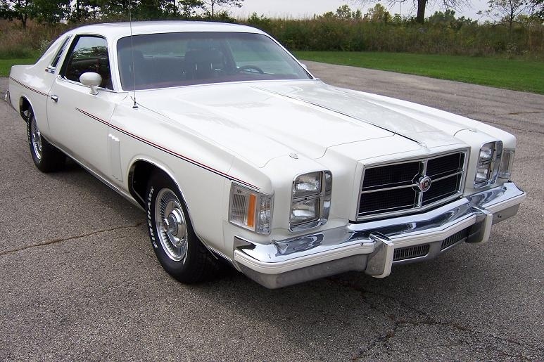

I have that car in my list as well. If your wife is driving it you have done some work up front.

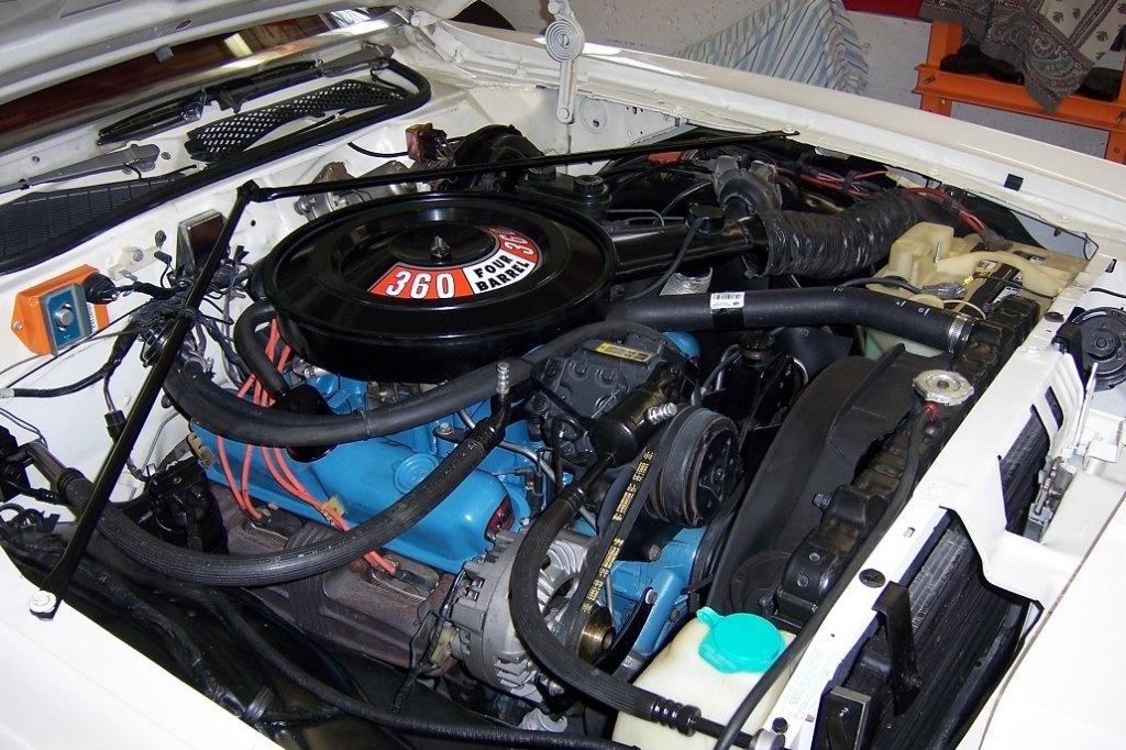

Oh ya. Bought this car in 07 in a Chicago suburb. It had been derelict for about 10-11 years. It had been hit in the right front. Needed a new fender, nose, hood, and some core support repair. All cosmetic. It was originally sold out of California. It was a 28K all original car and it came with many NOS parts as the owner intended to fix it. Since I had a spare nose, hood, and other parts ( and for the price he was asking - $2100, I couldn't pass it up. Took me about 1 year to get it done - pic. It was very heavily optioned, including a moon roof. I rebuilt the trans, but the engine has never been out of it. Only mods were lean burn conversion, R134A. Great driver - when she lets me drive it.
She does look a great deal better than the pictures I have of her. Great to see her back the way she should be!
