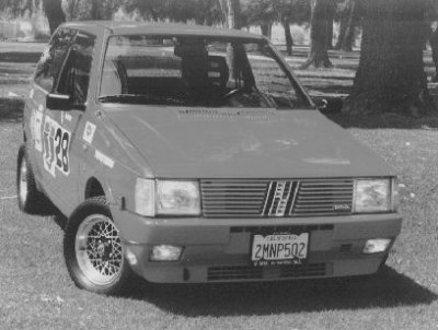

How about a hot rod Yugo? :icon_compress:
Already been done! Meet the Morreti Turbo Uno.
