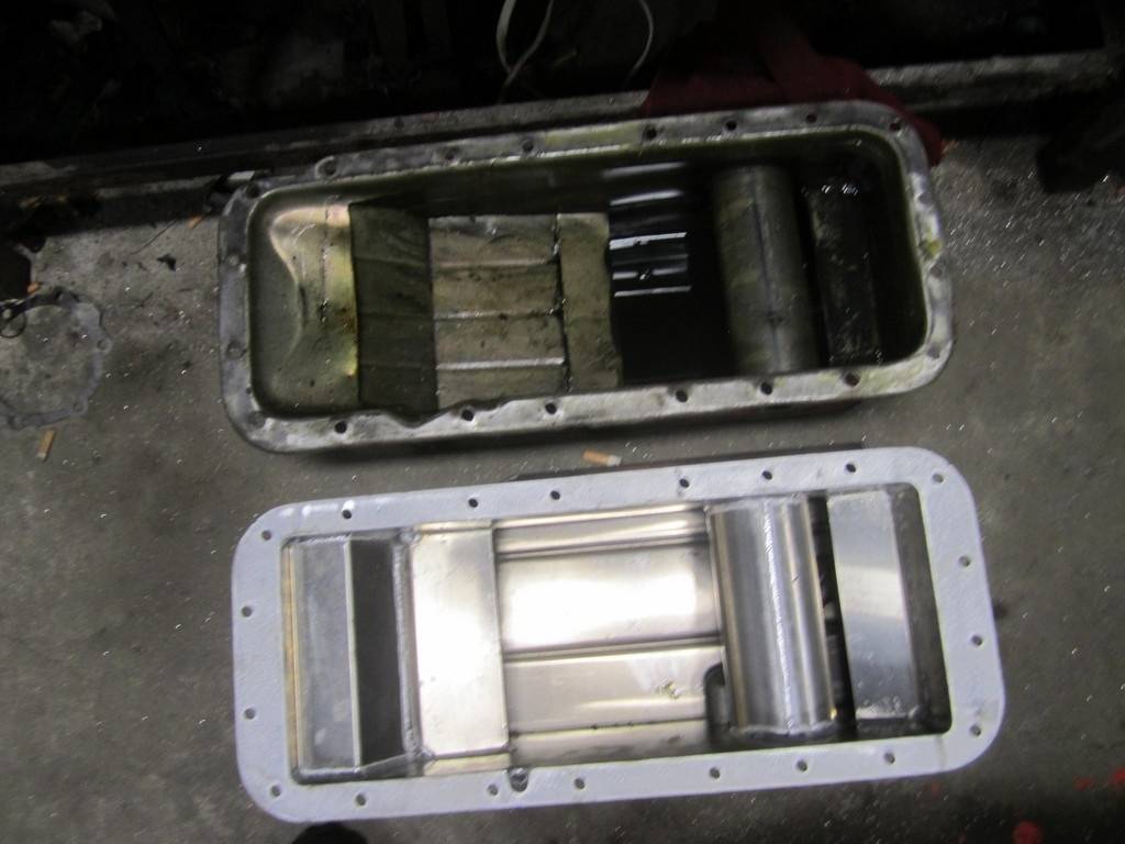

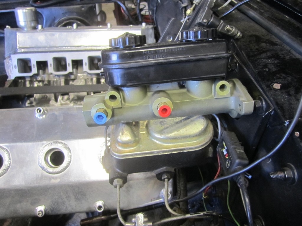

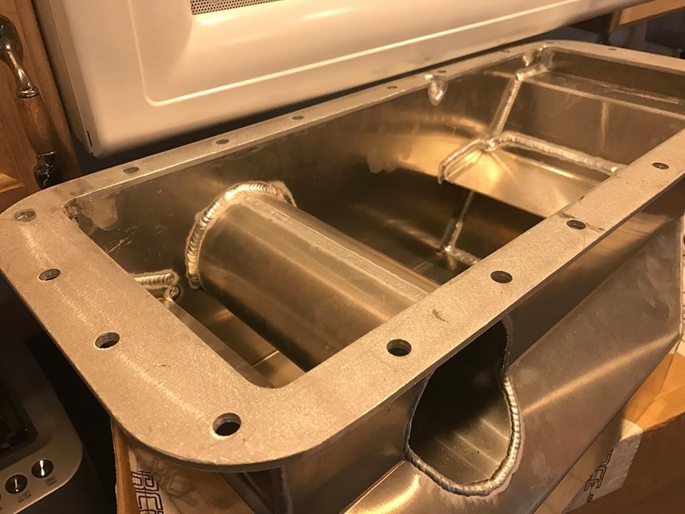

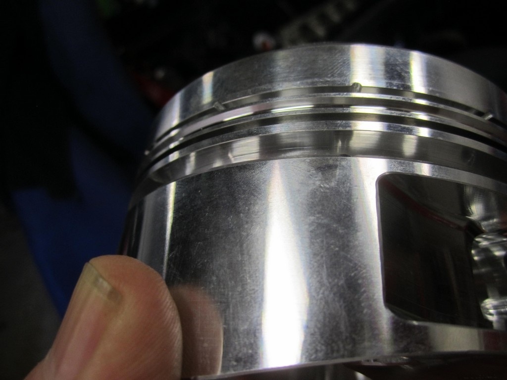

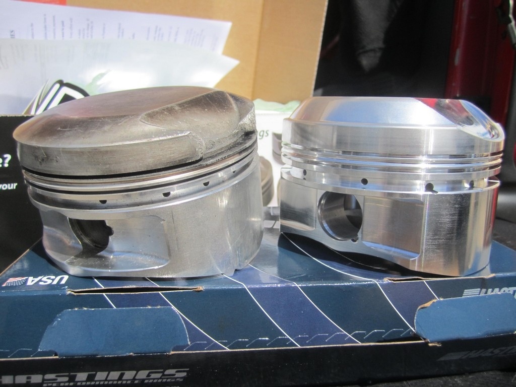

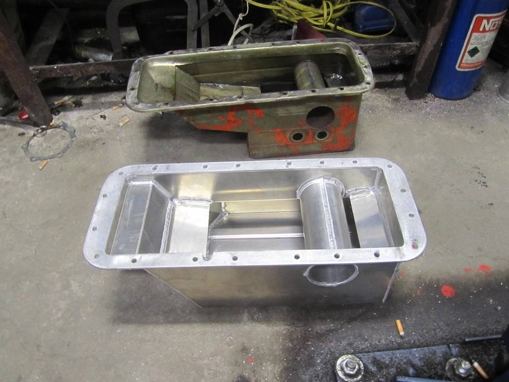

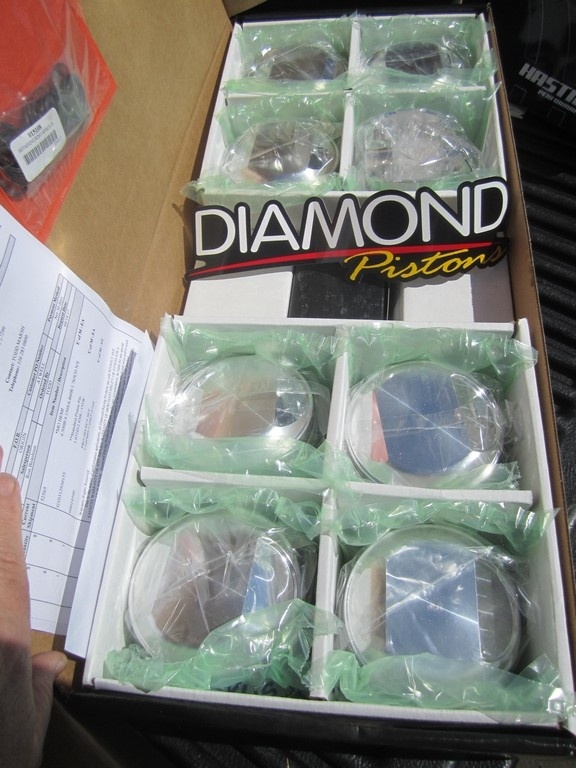

Good to have friends!! I have a donated master cylinder and a fab oil pan!!Parts are rollin in and the pistons WILL be here this week after Fedex screwed up,,,,

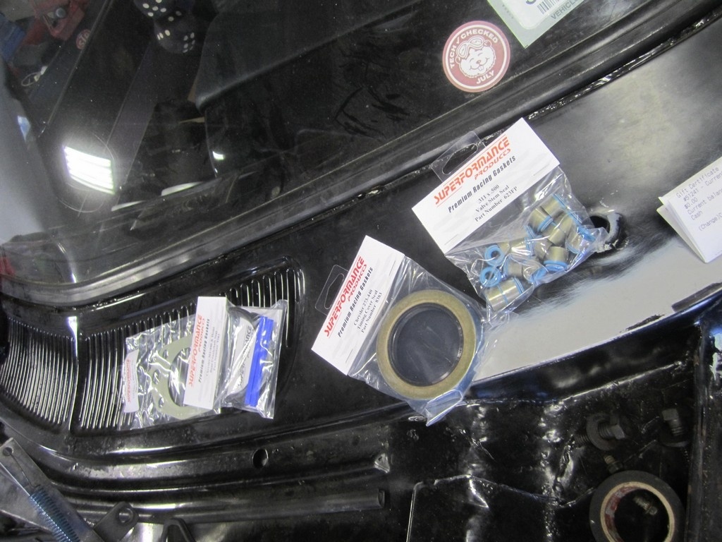

Ordered parts are in,just have to finish the fabrications.Then more parts will be sent out to polished and the fuel pump goes back to Magna Fuel for a freshen up.Tube came in at the speed shop so the header tubes can be finished and the headers get sent out and recoated.The lifter have been rebuilt and waiting to go back when ready.Except for the Cometic head gaskets and exhaust flange gaskets EVERYTHING is made by Superperformace and the best gaskets I have ever used!

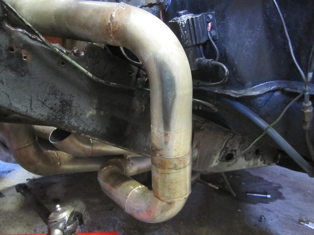

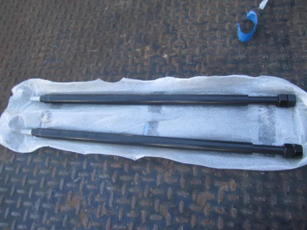

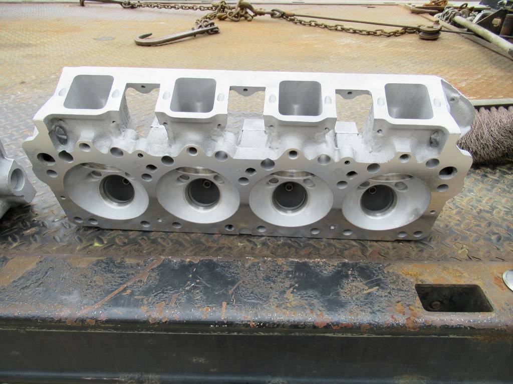

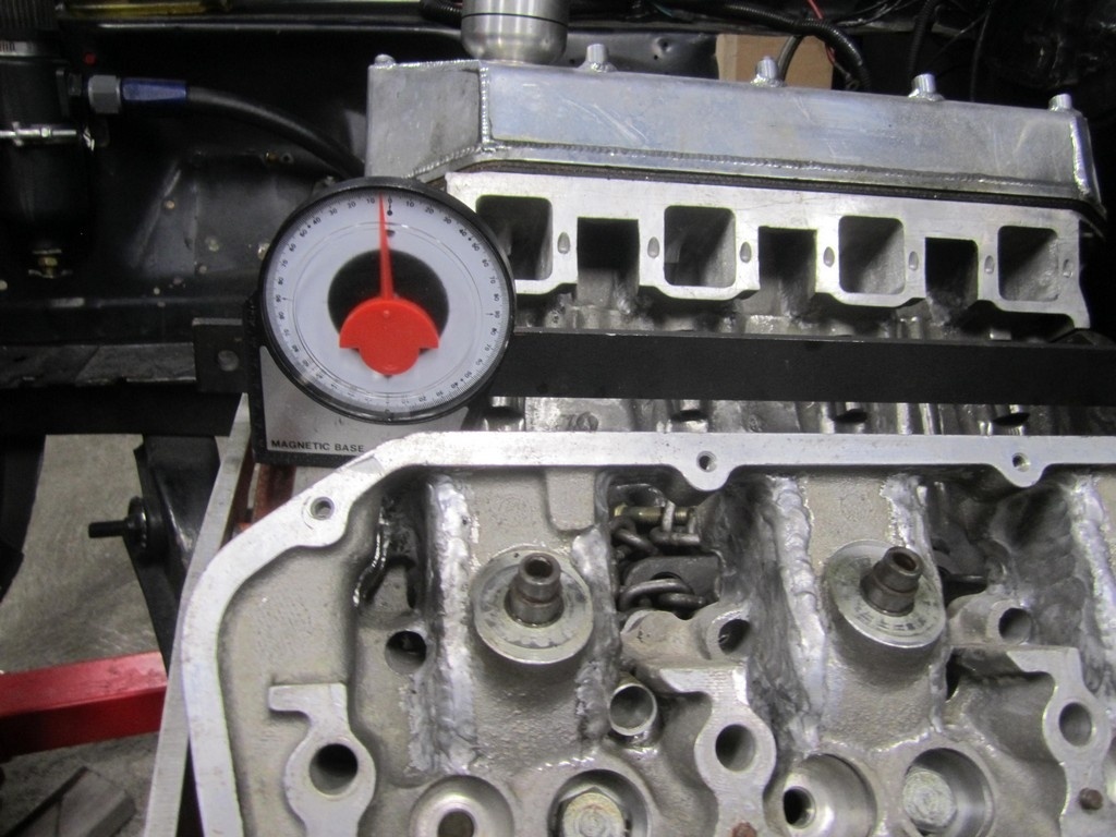

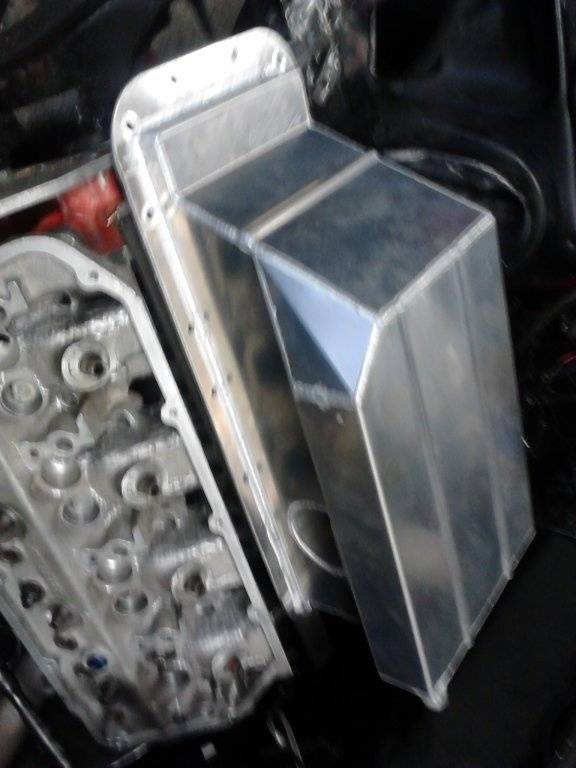

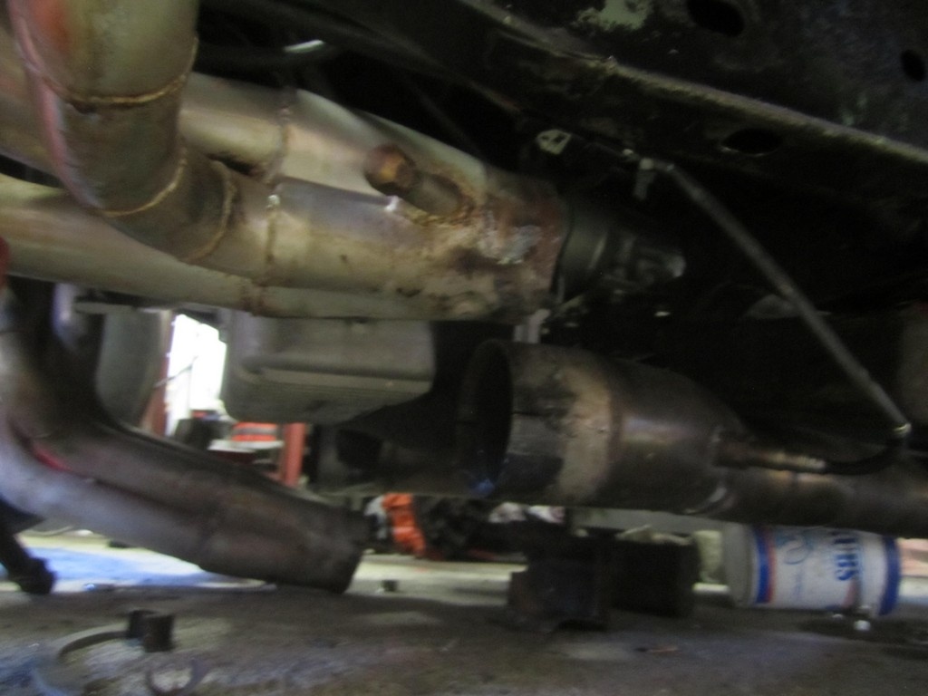

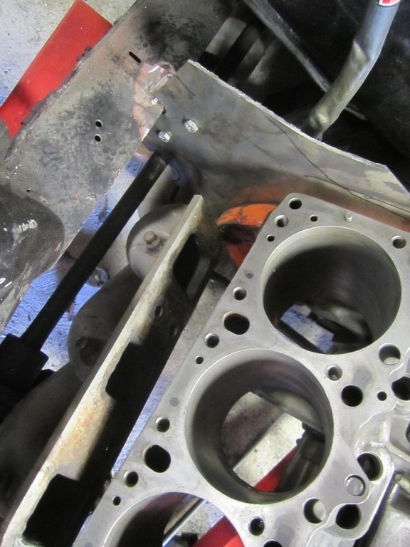

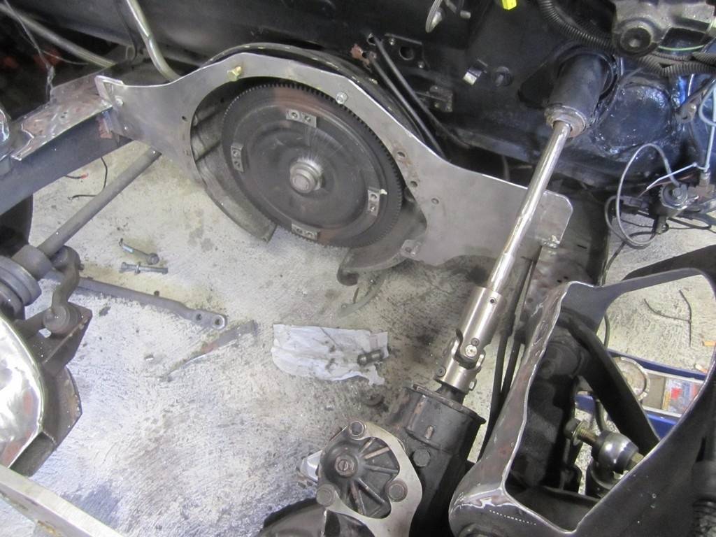

So you can see the engine set back,aluminum Master and strut bars.Headers are now done and can get sent out to be recoated.Will start the shortblock this week.Heads are back from the weld shop where they tigged the o-rings closed.Heads will be milled this week,just a few thou to square them up.

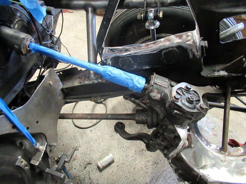

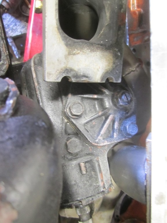

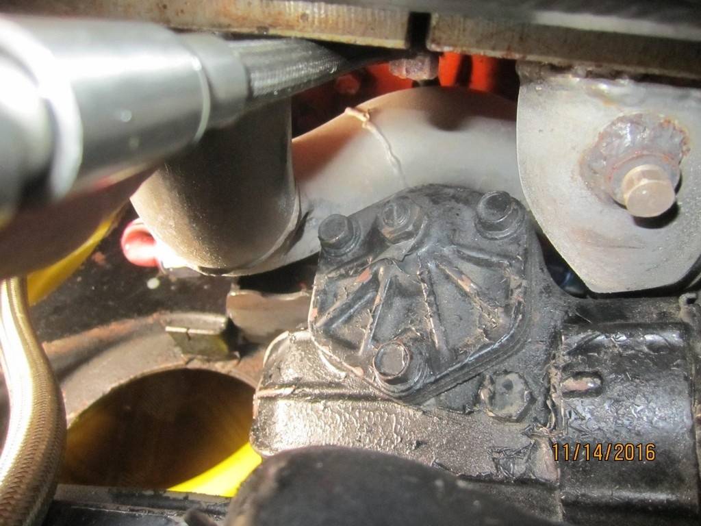

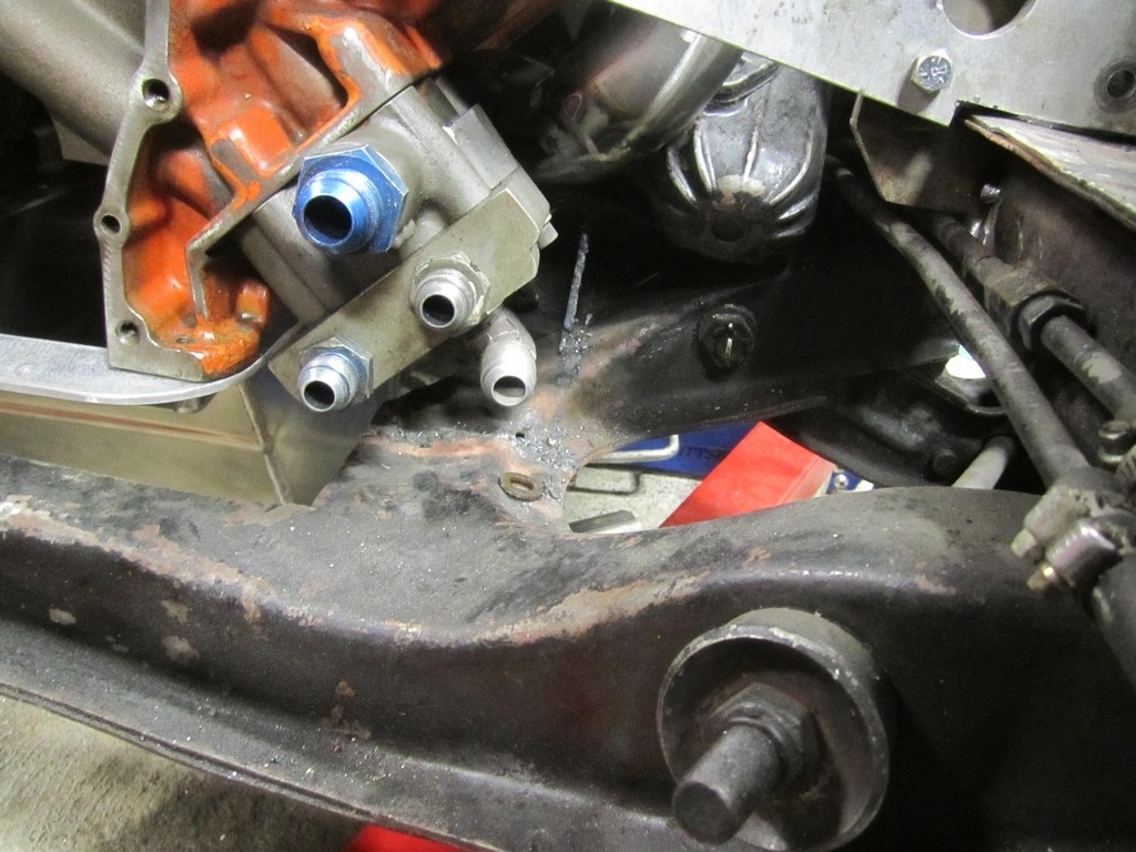

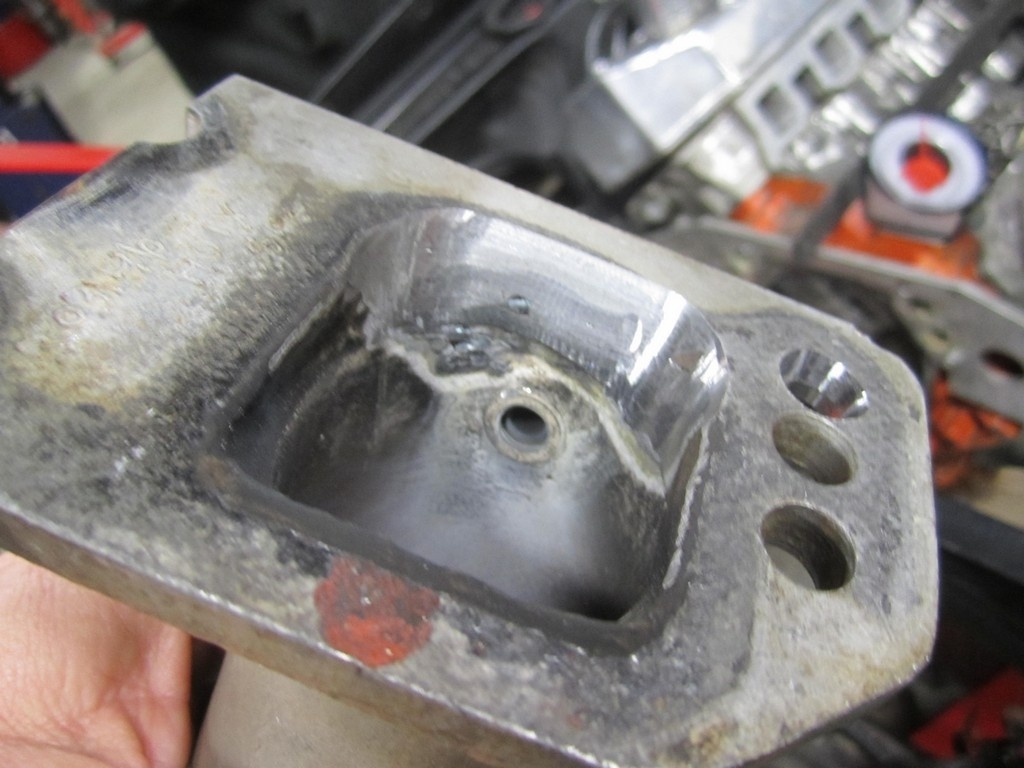

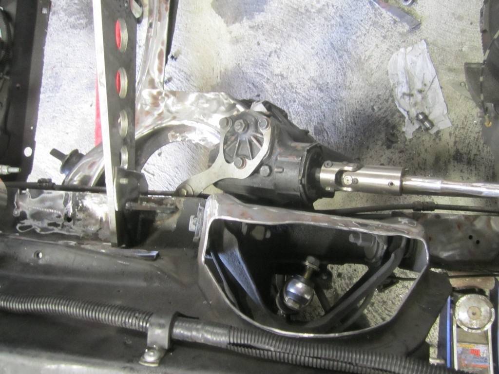

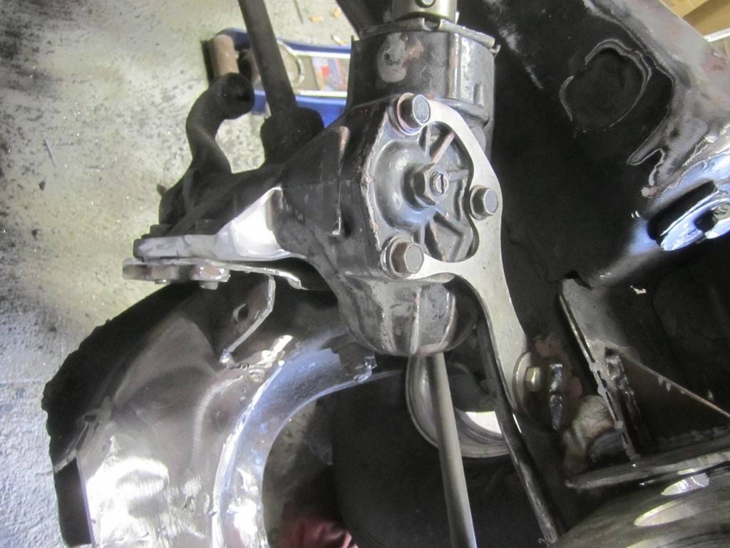

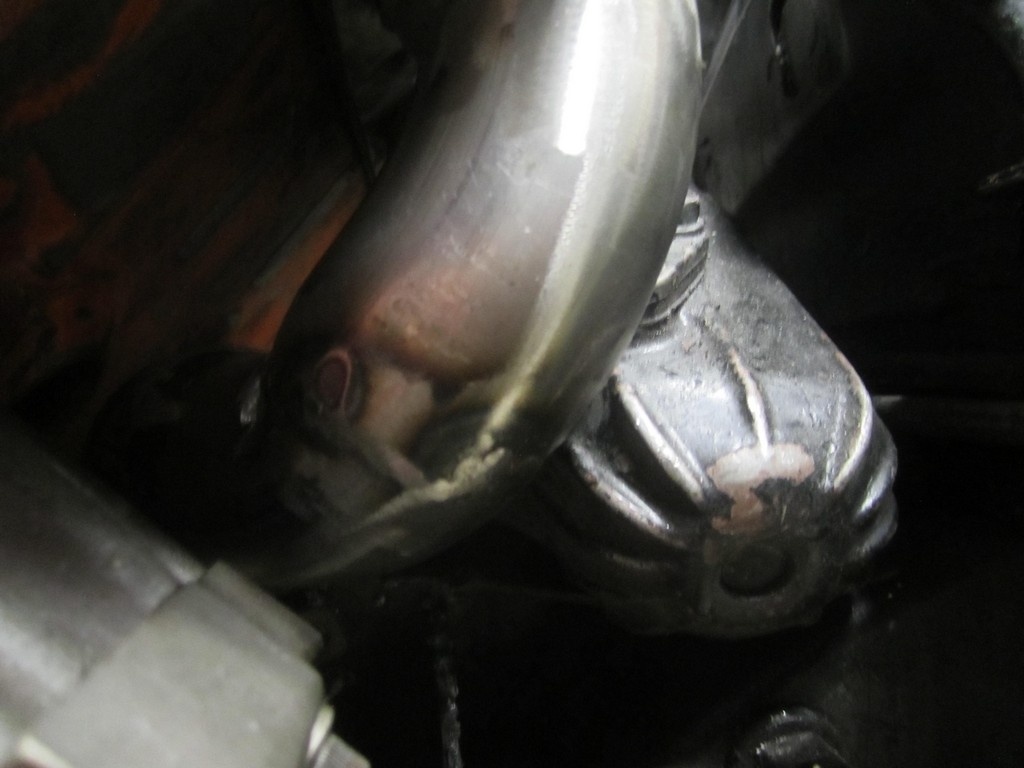

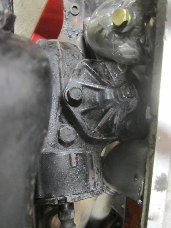

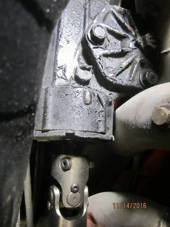

Found a very cool brace for the steering box! Also had to port the header flanges exhaust roof to fit the .750 raised head.It's coming together

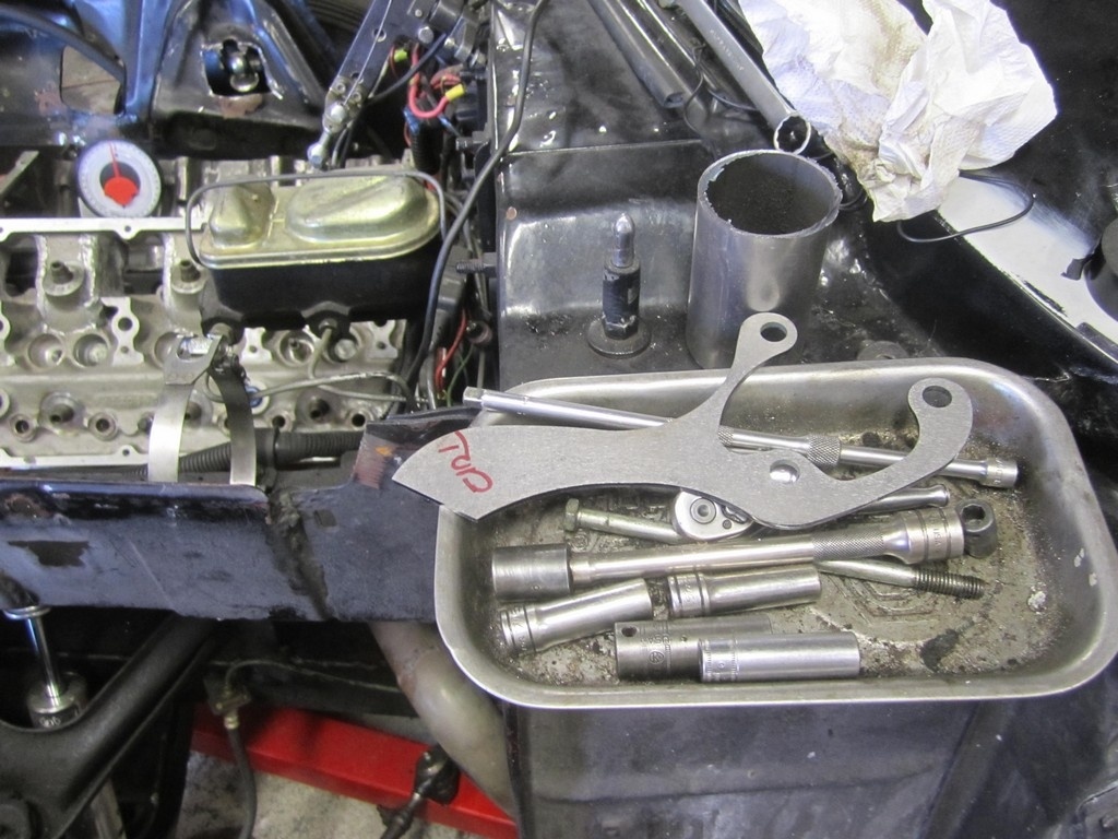

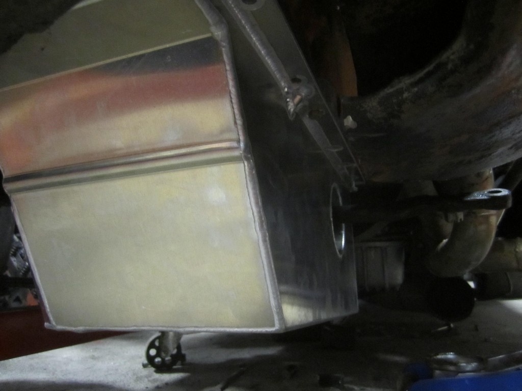

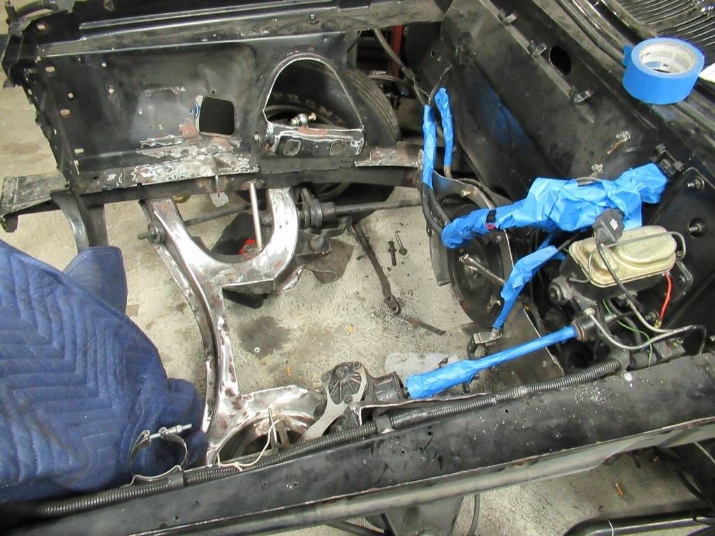

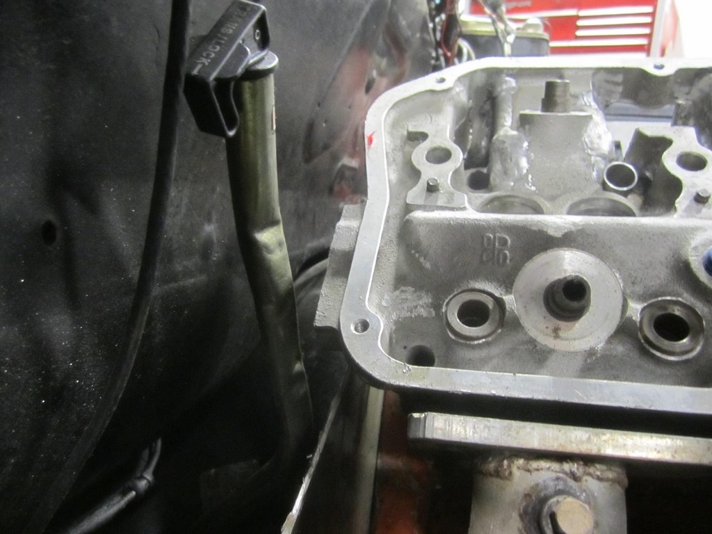

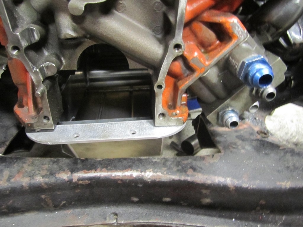

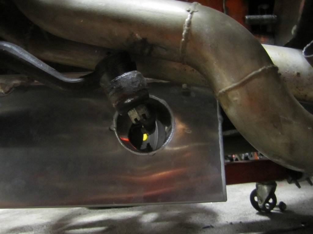

This "work" thing is getting in the way of progress:BangHead:A friend donated a fab aluminum oip pan and for what I paid for a pair of aluminum strut bars,was almost a donation.Still waiting on the chassis shop to bend some tube for me.We bent up some brake line in the shape of the CM tube I want.

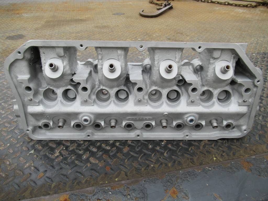

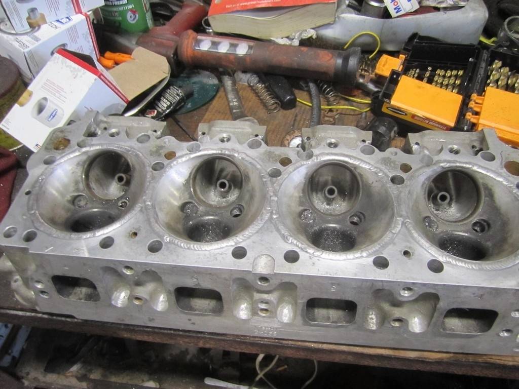

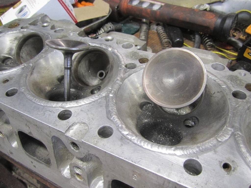

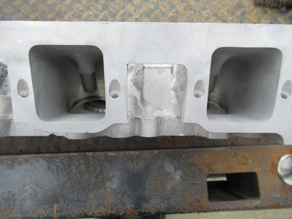

Heads back from the welder,closed the o-ring groove.Now I can bring them to the machine shop to be milled.

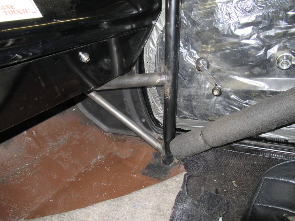

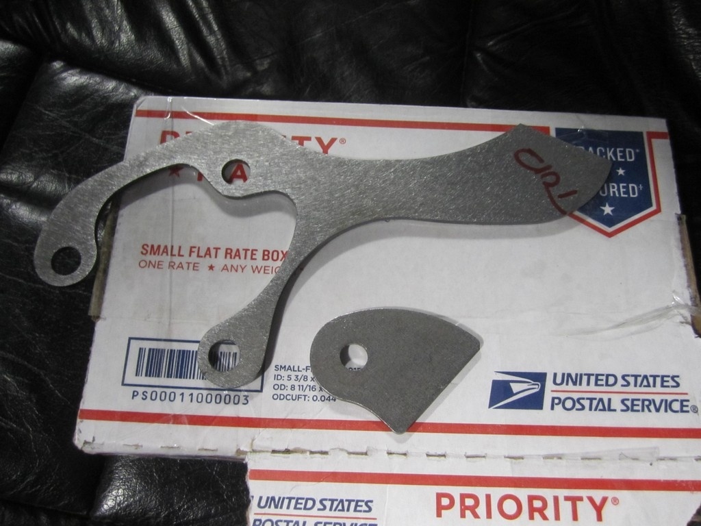

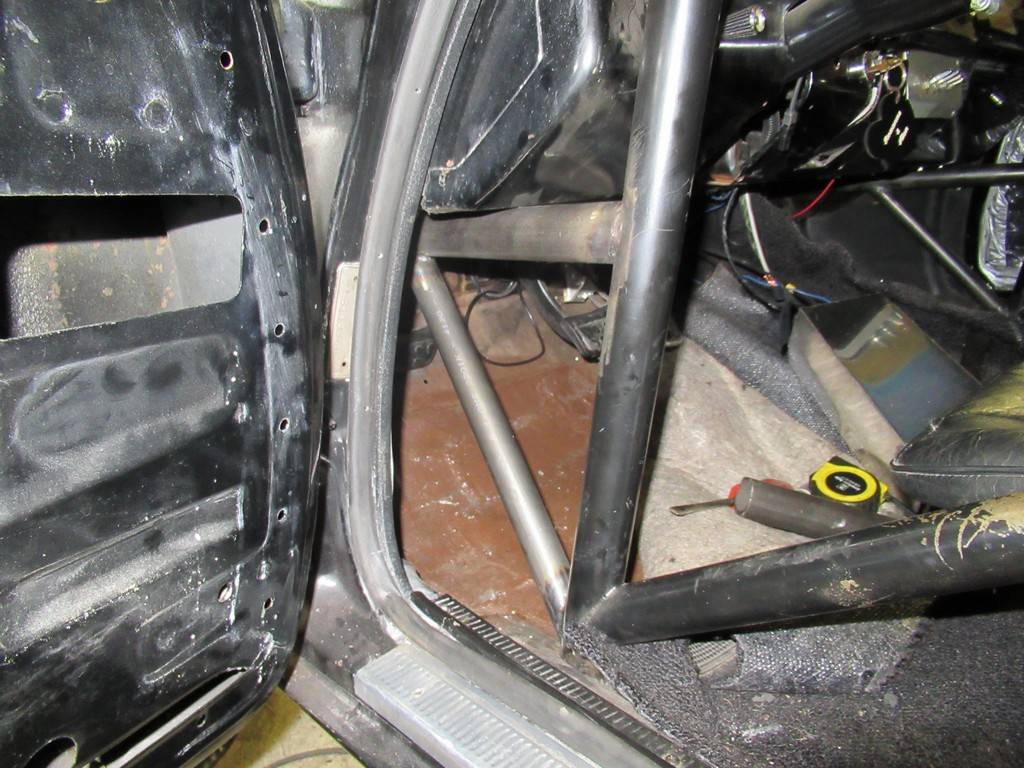

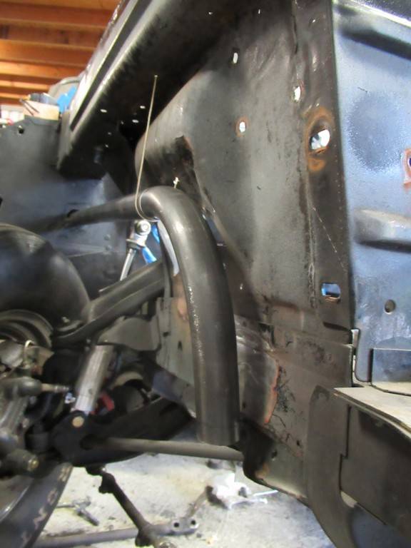

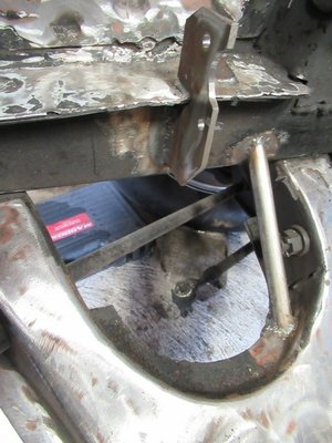

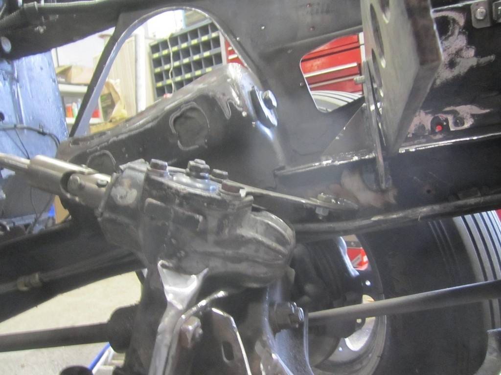

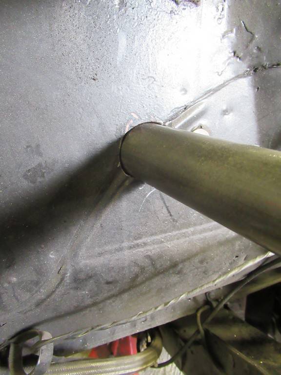

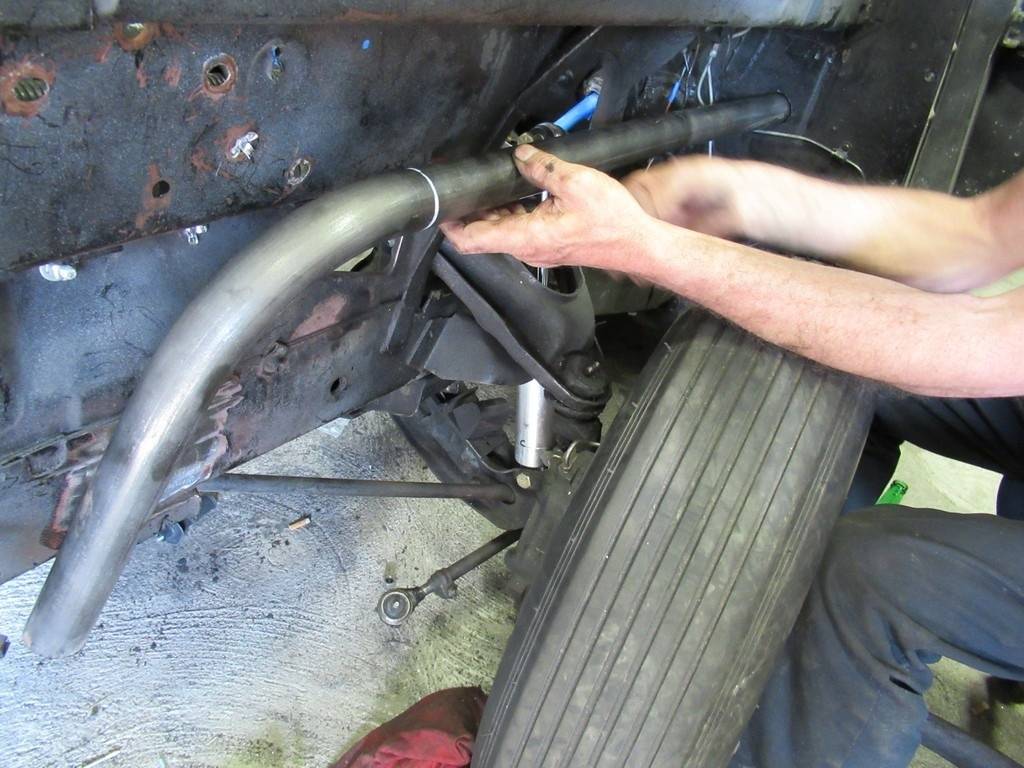

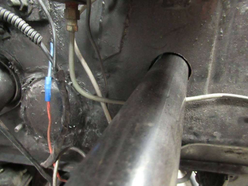

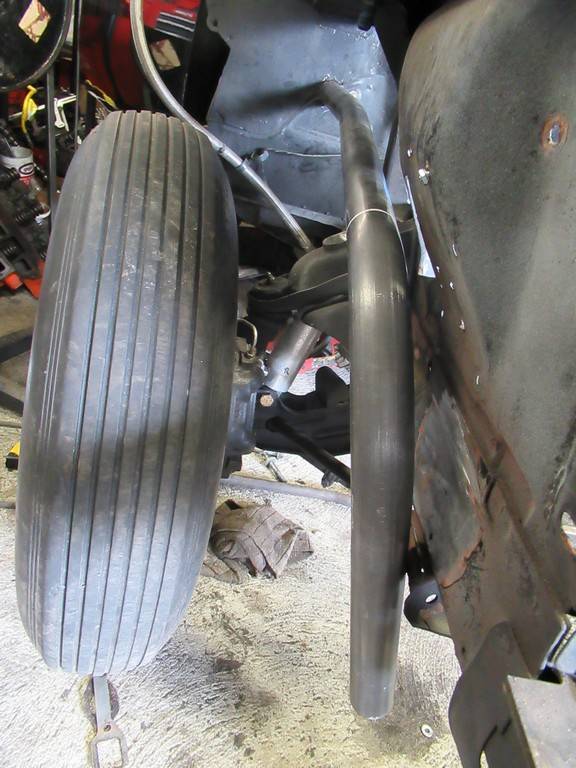

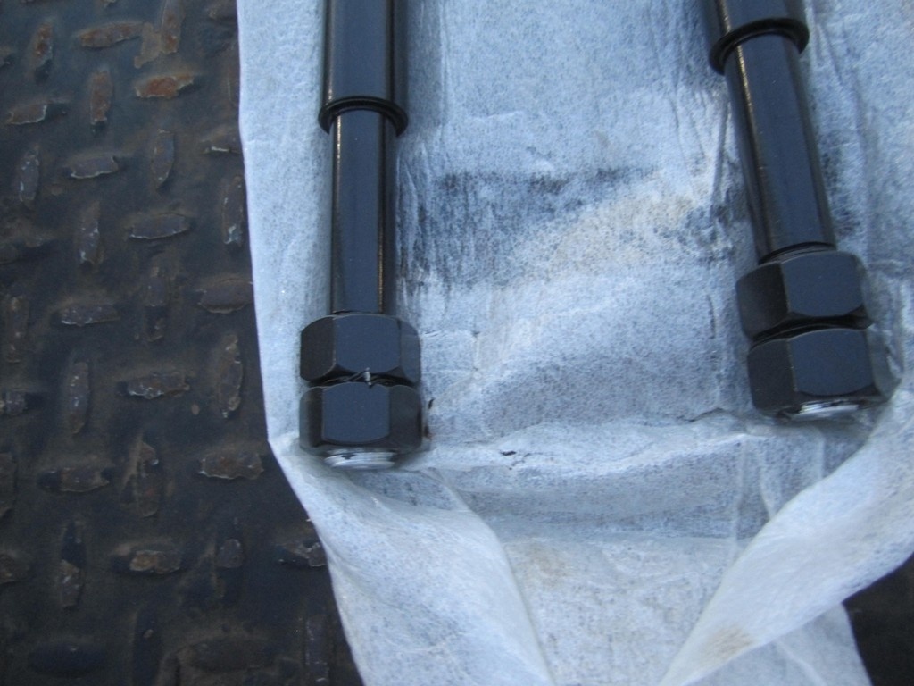

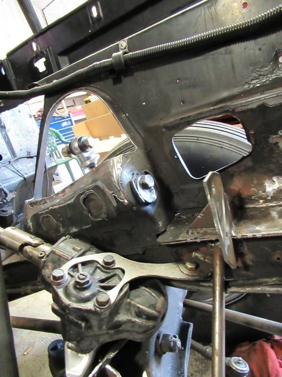

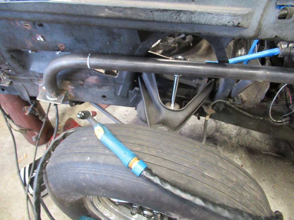

Some pic's from today.Picked up the "J" bars I had made in CM.Will be able to weld the pipe in the tight opening in the firewall.That should help tie everything together.The blower scoop,intake,valve covers and engine plate are getting repolished and should have them this week.Soon as we finish installing the j's,we can start engine assembly. I need to degrease the engine compartment and control arms and spray bomb everything.

Just picked up the heads at the machine shop,things should start coming together.Who will be back together 1st,me or that tile guy:lol:
Picked up the heads from the machine shop.Very nice! "J" bars are perfect!Will fab shock mounts of the J bar and a few other braces.Should start coming together real fast.

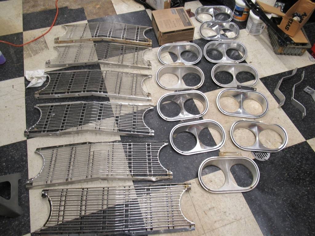

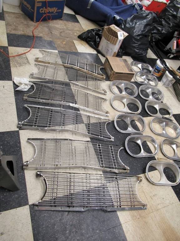

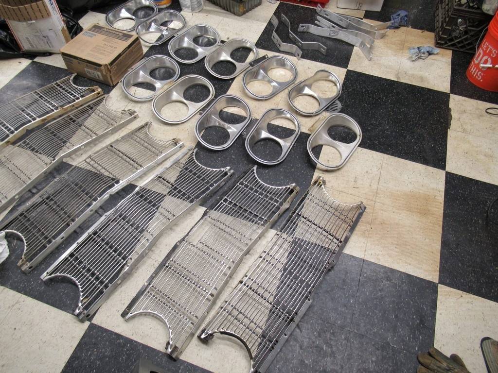

Will black out one grille set and polish the other,can't decide which will look better.....

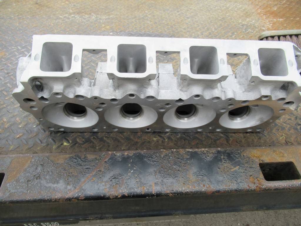

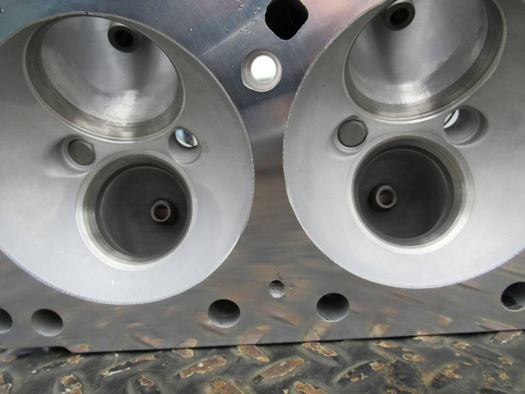

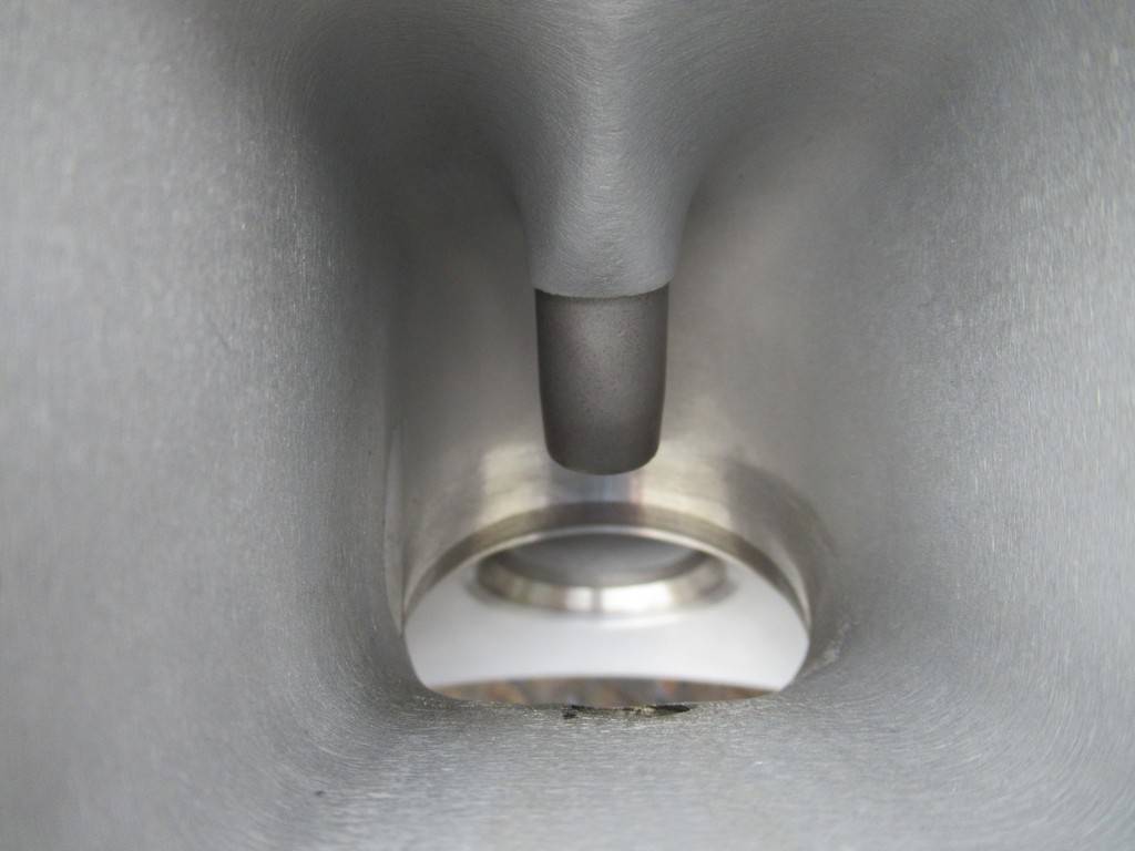

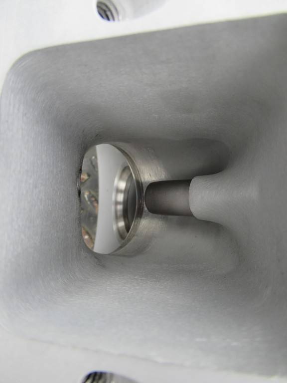

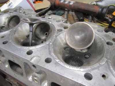

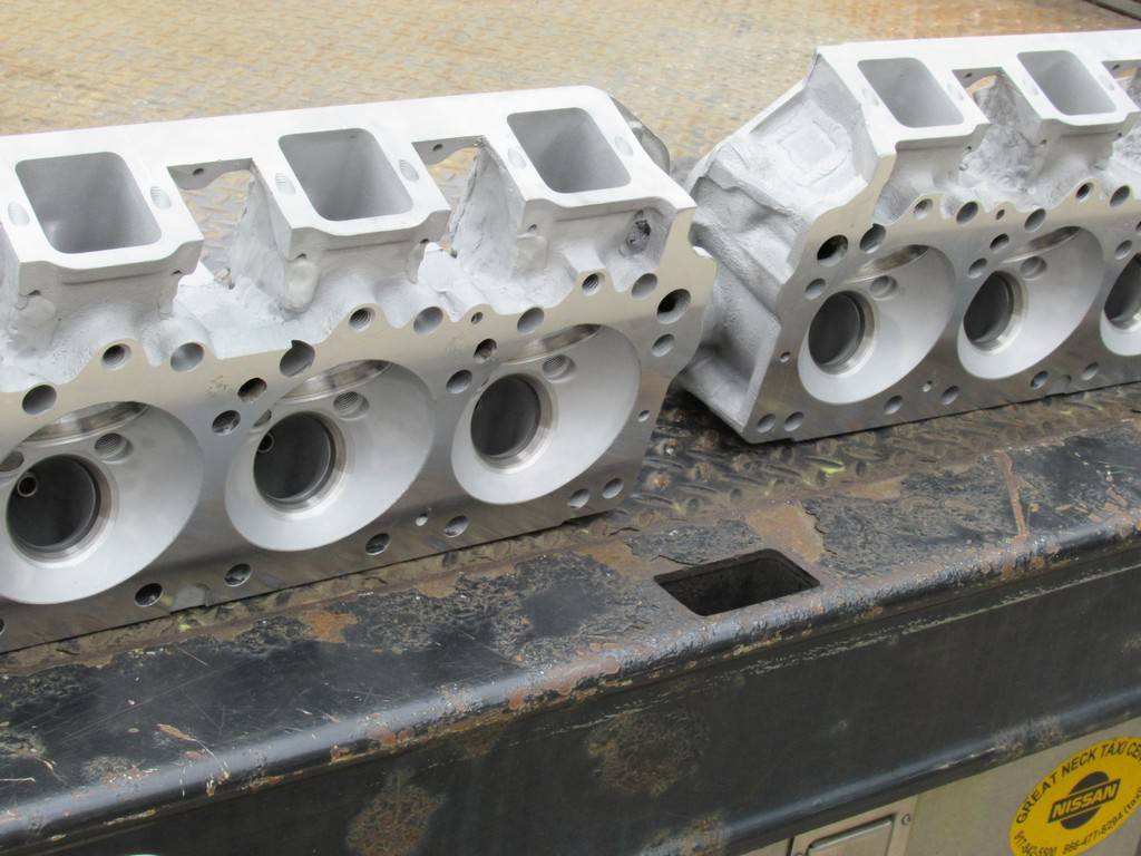

Here's some pics of the heads after they were beaded and milled.Had to open the exhaust guides because the Ferrara valves were tight,,,,

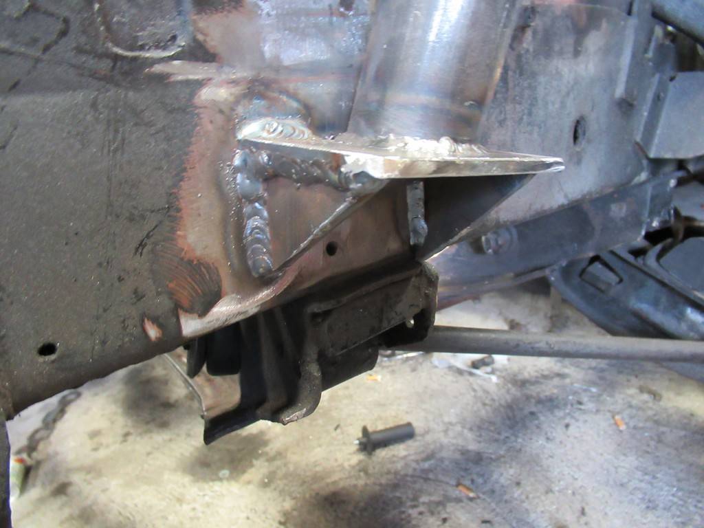

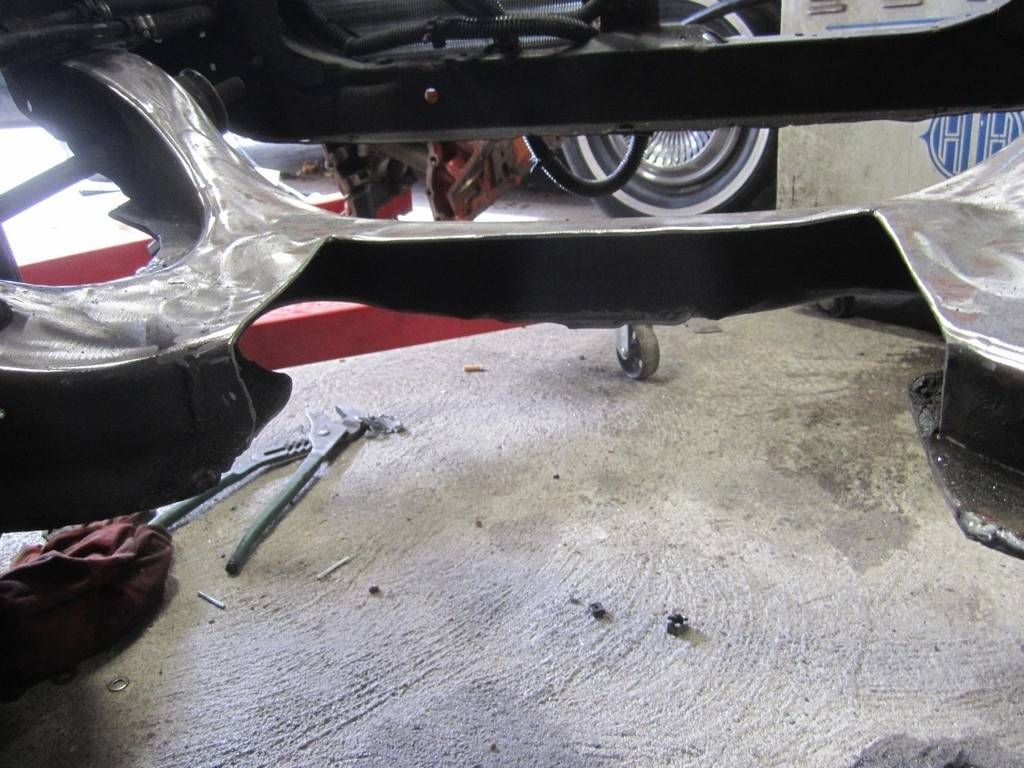

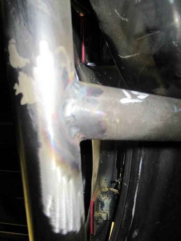

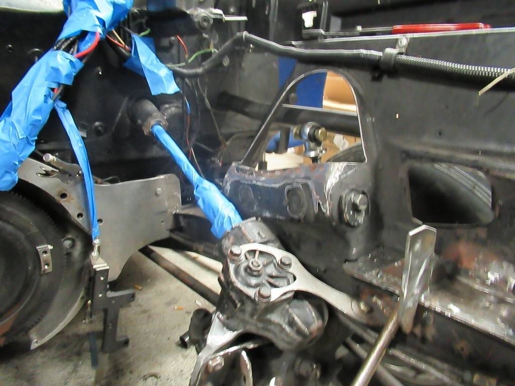

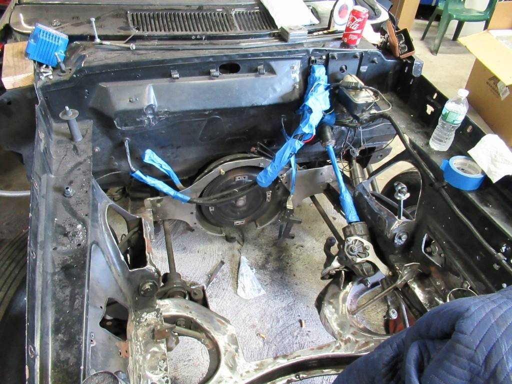

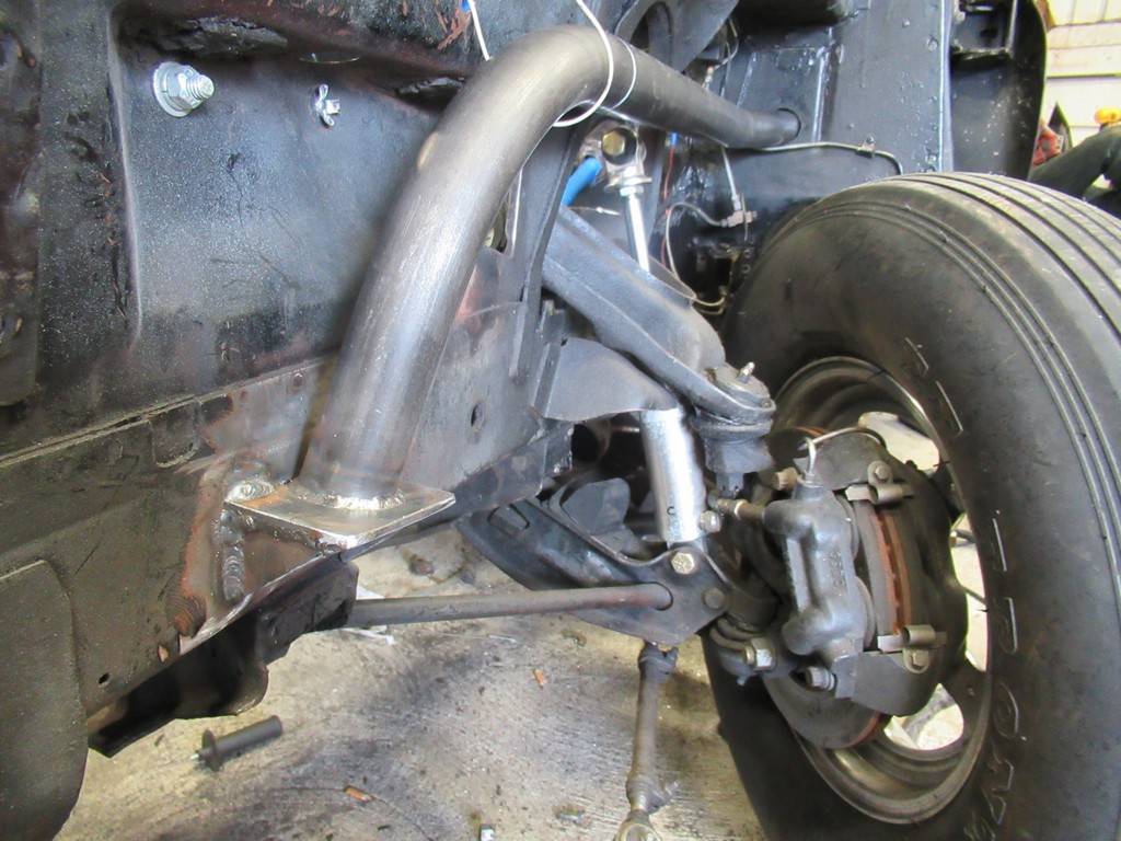

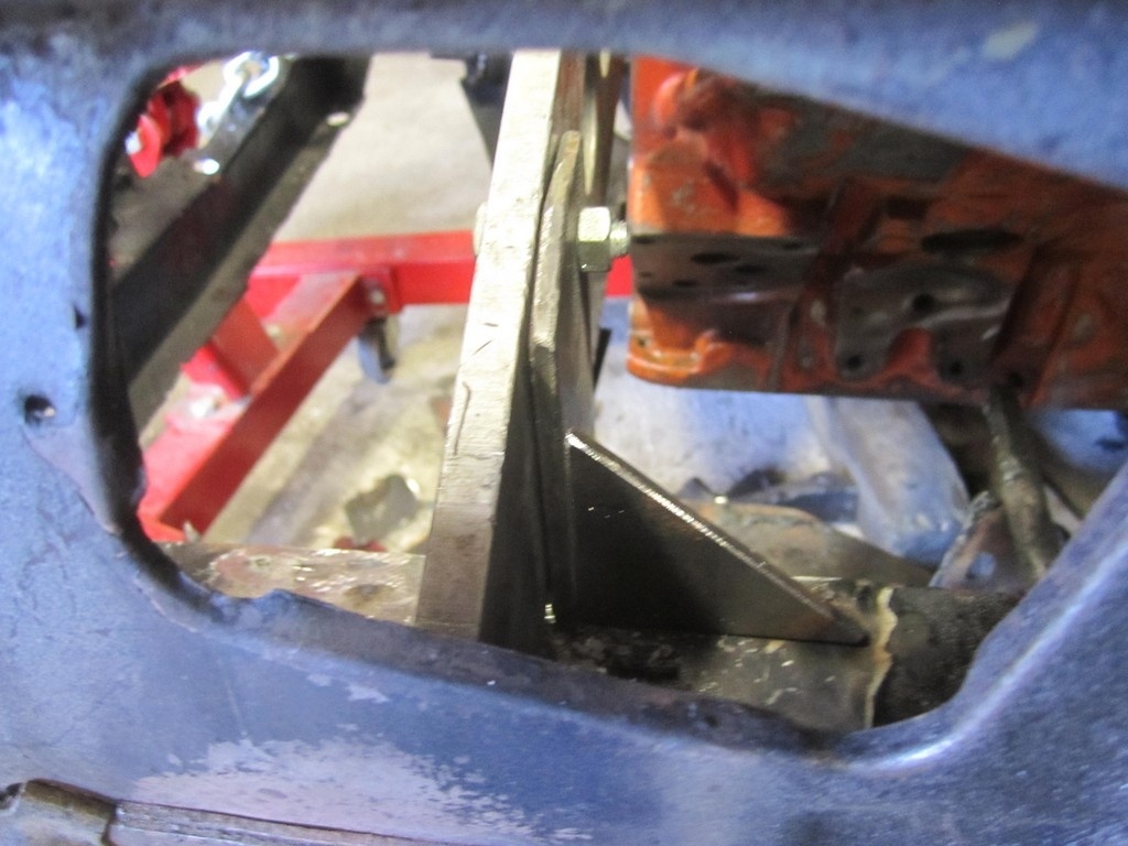

Yesterday I was able to get down to the shop in the afternoon.Welded in the left "J" bar and .started the right side:thumbsup:
5.30.17 001.jpg 5.30.17 002.jpg 5.30.17 005.jpg 5.30.17 006.jpg 5.30.17 007.jpg 5.30.17 008.jpg 5.30.17 009.jpg 5.30.17 010.jpg 5.30.17 011.jpg 11.16.16 007.jpg
When we are done welding,I will take the car back to my garage,degrease and clean,,then paint.After the car comes out we will have the room to assemble the long block.Blower,carbs and all will be installed in my shop.

"J" bars and a few supports are in.Few more supports and small things,then I can take the car back to my shop to degrease,sand and paint.Shooting for Carlisle!
