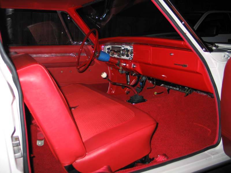

I guess I might as well use this as my build thread. Interior is coming along. I've recently had the headliner installed, put the carpet, dash, seats, door panels and trim in.
Man the car looks great something to really be proud of
Great Car! I have some questions about the headers. How bad where they to install? Did you have to raise the engine? How much clearance at the pass shock tower is there? I am thinking about these for my 65 Belvedere (440/727).
Thanks guys this car is pretty fun to have and now it's down to of the finer details. I do have to pull the heater box out and replace the core since it's leaking.
