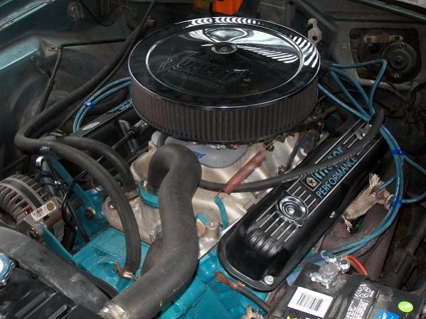

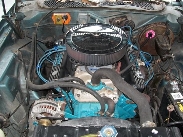

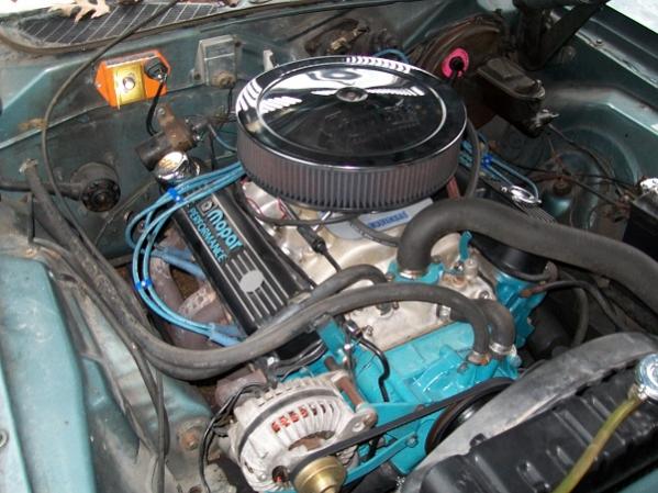

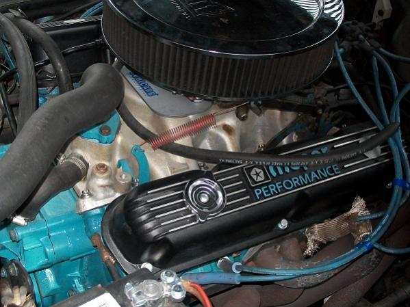

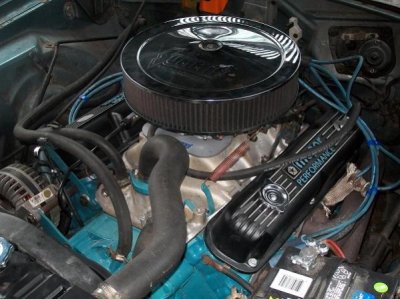

Its not a big block and nothing exotic, but I got my pretty much stock rebuilt 318 back. Its got a summit manifold/carb package which is really a Weiand I believe Action Plus manifold and an older design Holley carb. Also has headers, double roller timing chain, and a hughes whiplash cam with the recommended springs, and everything else is stock. Cam specs are below and so are pics! If the weather gets better I will try to get a video. Like I said nothing special but this is my first musle car and my first rebuild (I'm only 21)
Intake Exhaust
Lobe Lift .323 .345
Valve lift w/ 1.5 ratio .485 .518
Duration @ .050" 213 226

Looks great! Hey does not have to be anything but fun for you (and a Mopar! LOL!!).

Well freaking done David! I don't care what engine it is, it's fresh and reliable for you. And freaking bravo on the install. It looks clean and tidy, nice.
Thanks for the compliments guys. Ma Snart its in my 71 Charger S.E. I will try to find or take some pics of the car and post them. You have yourself a nice looking 71 as well the red with black combo looks good!

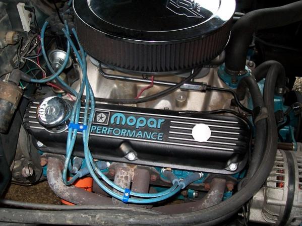

Good deal David! looking forward to your video.. Looks great with those valve covers..
Nice little 318 David, looks good...
Thanks guys! The valve covers were my attempt at being different I hadn't seen any like that at shows and I love that shade of blue, so I figured why not paint em.
