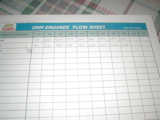

just picked up the heads today. they did the valve job and surface. I did have him pick a random port for flow numbers. I didn't think I was going to get any high flow numbers, I just wanted to know for reference.

Were there baseline #s available, since comparing #s from diff benches is not reliable?
I didn't do before numbers since there's so many people that have out of the box flow numbers. any how, if it was big numbers I was looking for, I'd have choosen a different head.
